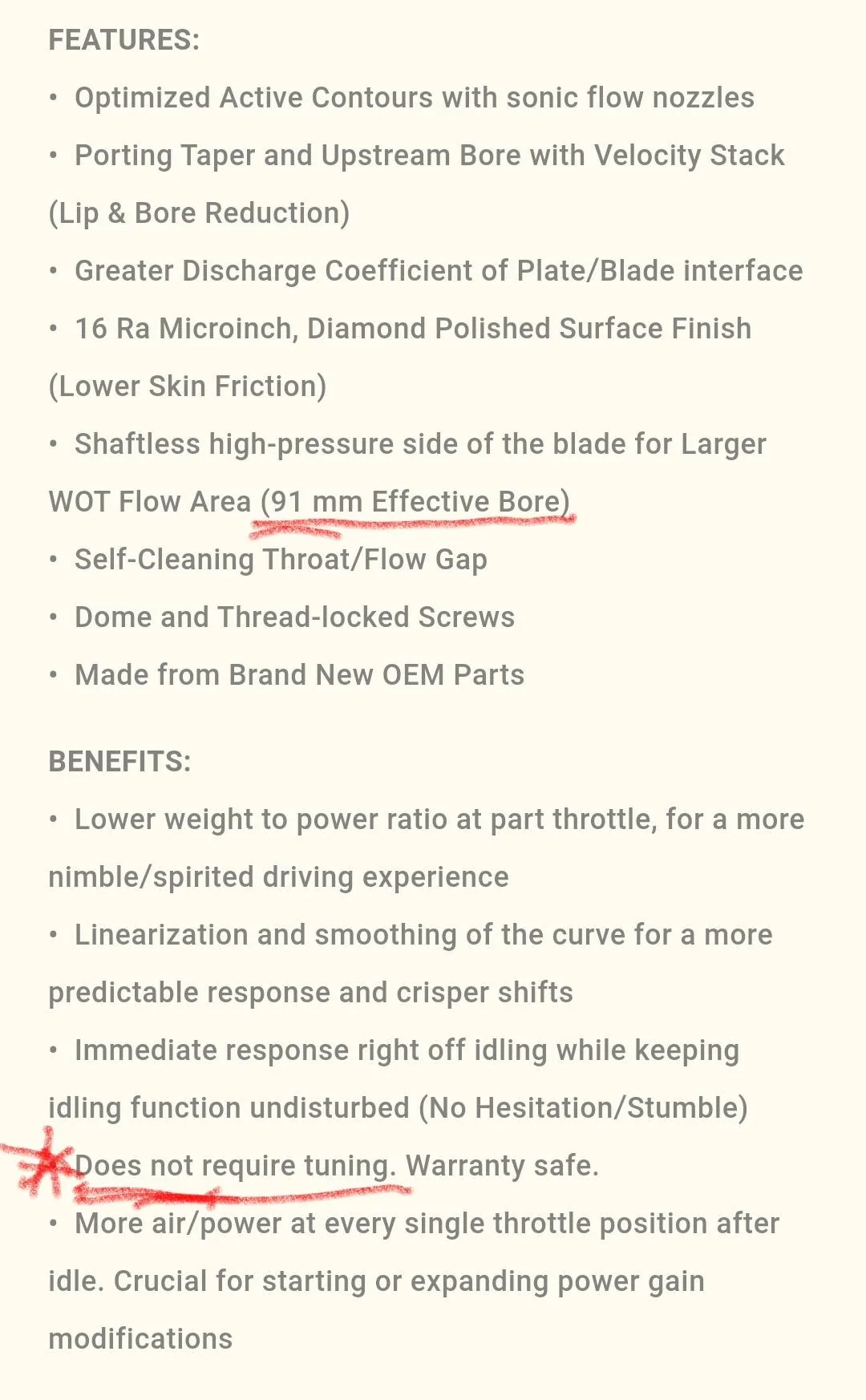

@JAJ : I totally agree; "This is going to be interesting." RE: WOT increased airflow is this claim from Soler. Now if my math is correct, this is only 4.6% effective increase from 87mm to 91mm AT WOT. Hmmm....following.

This is going to be interesting. The value they offer is smoother air flow through the throttle at various angles including wide open. That in itself won't change the power production of the engine. If the smoothed and polished TB allows more air at full throttle, then that will, in the same way that a larger TB would.
The question is, how will the ECU respond to the buffed TB? Their webpage shows a lot of GM products they build TB's for, and as far as I know, the GM ECU's work slightly differently than the Ford 2011 and later ECU's. Earlier GM ECU's used a "manifold absolute pressure" ("MAP") sensor to monitor the air pressure inside the intake manifold behind the throttle. If intake airflow increases, then MAP increases, and the ECU pushes more fuel to keep up with the increased airflow. I don't know if GM has abandoned this approach or not. Ford ECU's don't do it this way, though.
In the Ford Coyote (and later) ECU's, the intake manifold pressure is estimated by a handful of tables that translate the physical characteristics of the throttle body into an estimate of MAP at various airflows measured by the MAF. There's no MAP sensor. Changing the physical TB will invalidate the values in the tables - they were determined in the original calibration of the factory engine and TB. These tables are used by the ECU to get the fueling right and to guess how far to open the throttle when the driver changes the pedal position.
Now, I'm certainly not saying it won't work. If the changes are within the "error band" built into the ECU calibration, then the ECU will compensate and nothing unusual will happen. Changes in the airflow at various throttle angles can't produce more power - the ECU matches power production (by controlling total airflow at all times) with the gas pedal position. That's its mission in life. So, if you alter the TB to produce more airflow at a particular throttle opening, the ECU just closes it a bit to get the airflow back where it belongs. And all these adjustments are computed in the ECU up to two full revolutions of the engine ahead of the current moment. The ECU has a graduate degree in prediction, and it's pretty darn good at it.
Where there might be a benefit is at WOT. If there's more airflow at WOT, there's more power and the ECU is just as happy with that situation as the driver is. As I said at the start, this is going to be interesting.
This was my initial reaction as well. The drivability of the Coyote is VERY sensitive to the throttle body's physical properties and correction factors in the ECU. It may be that if you do need to make changes to these tables that you negate the benefits of this new throttle body. The ECU is torque demand driven and so as stated above the ECU tries to provide the requested power based on throttle position + several primary tables + correction factors. Even small values outside the range of correction results in random artifacts in the ECU's ability to predict / anticipate airflow and as a result may show up as strange feedback by way of drivability at small TB %open. Since the closer to WOT the less it matters as the overall size of the TB has not changed and so VE remains the same.
