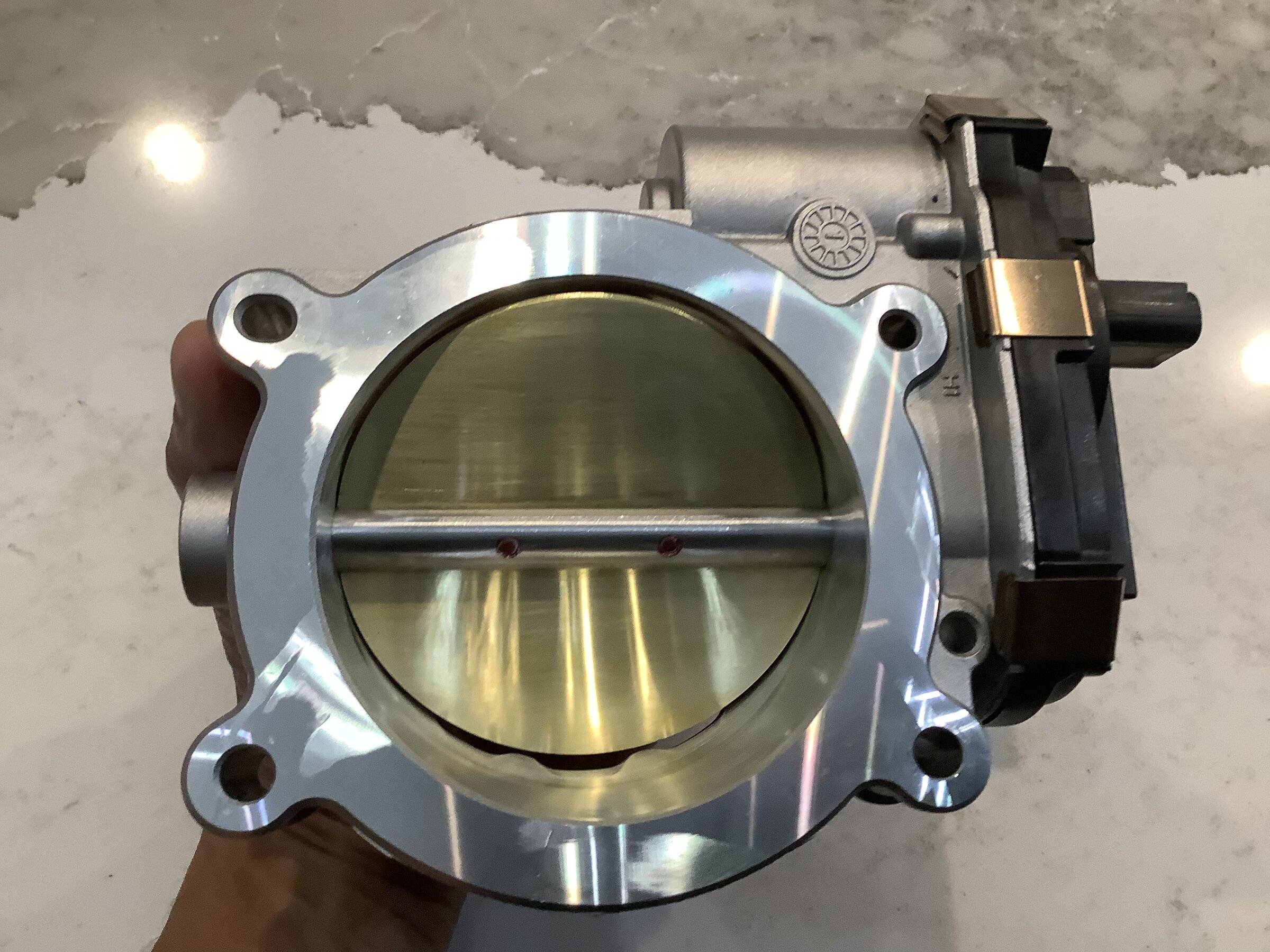

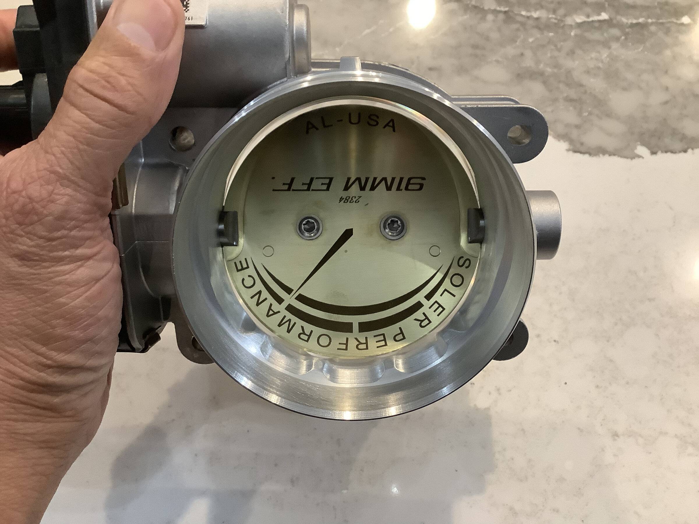

She’s here and she talks to me with her body (throttle body that is)! Plugged her up for a quick test and her tongue immediately started wagging’. Hopefully I’ll be able to do the install tomorrow. Stay tuned!
Ok, so is this the Soler job on your TB? I sent the prototype back in. Waiting to get it back, lol
Yep, that’s my factory tb. The port job looks very close to the Soler prototypes that you and I tested, however, I did notice that throttle blade bar does not have the dimples in it. I am curious as to why that feature was omitted this time around? Overall, I’m very pleased with the way it looks. Can’t wait to install it and see how it works.
