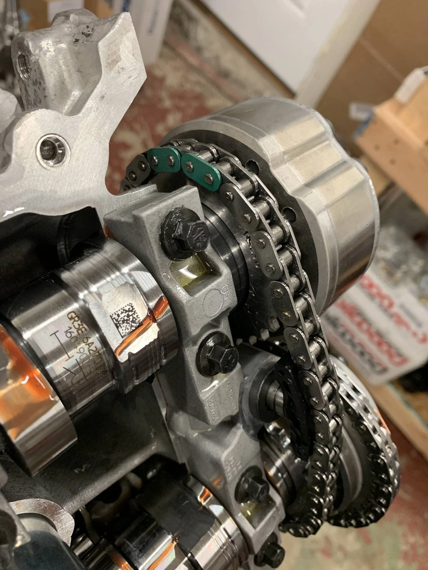

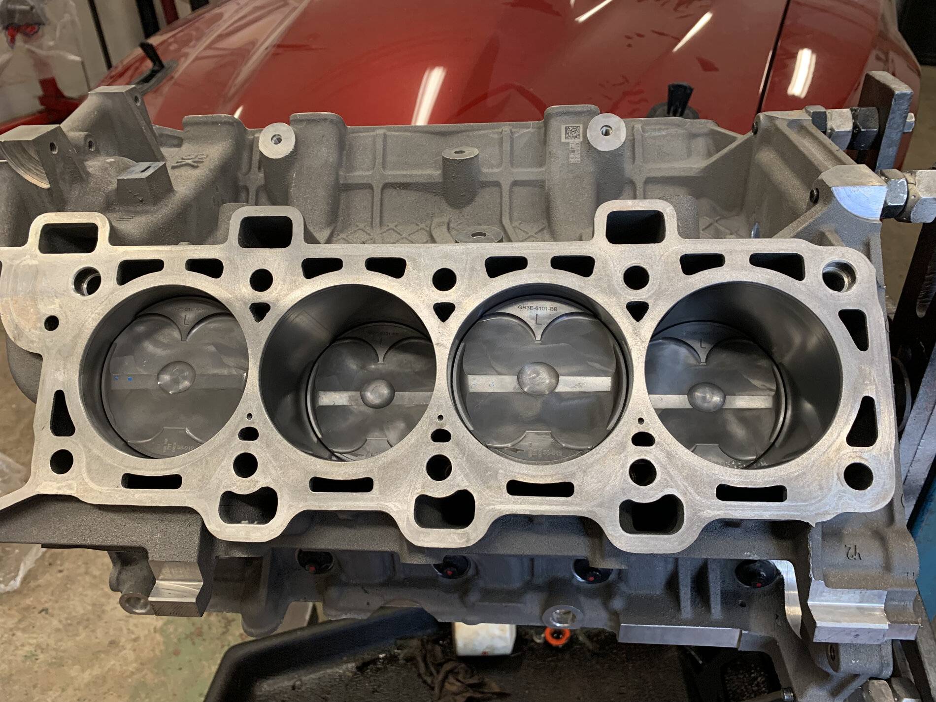

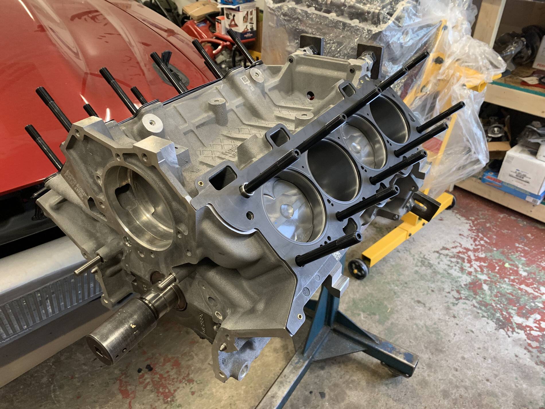

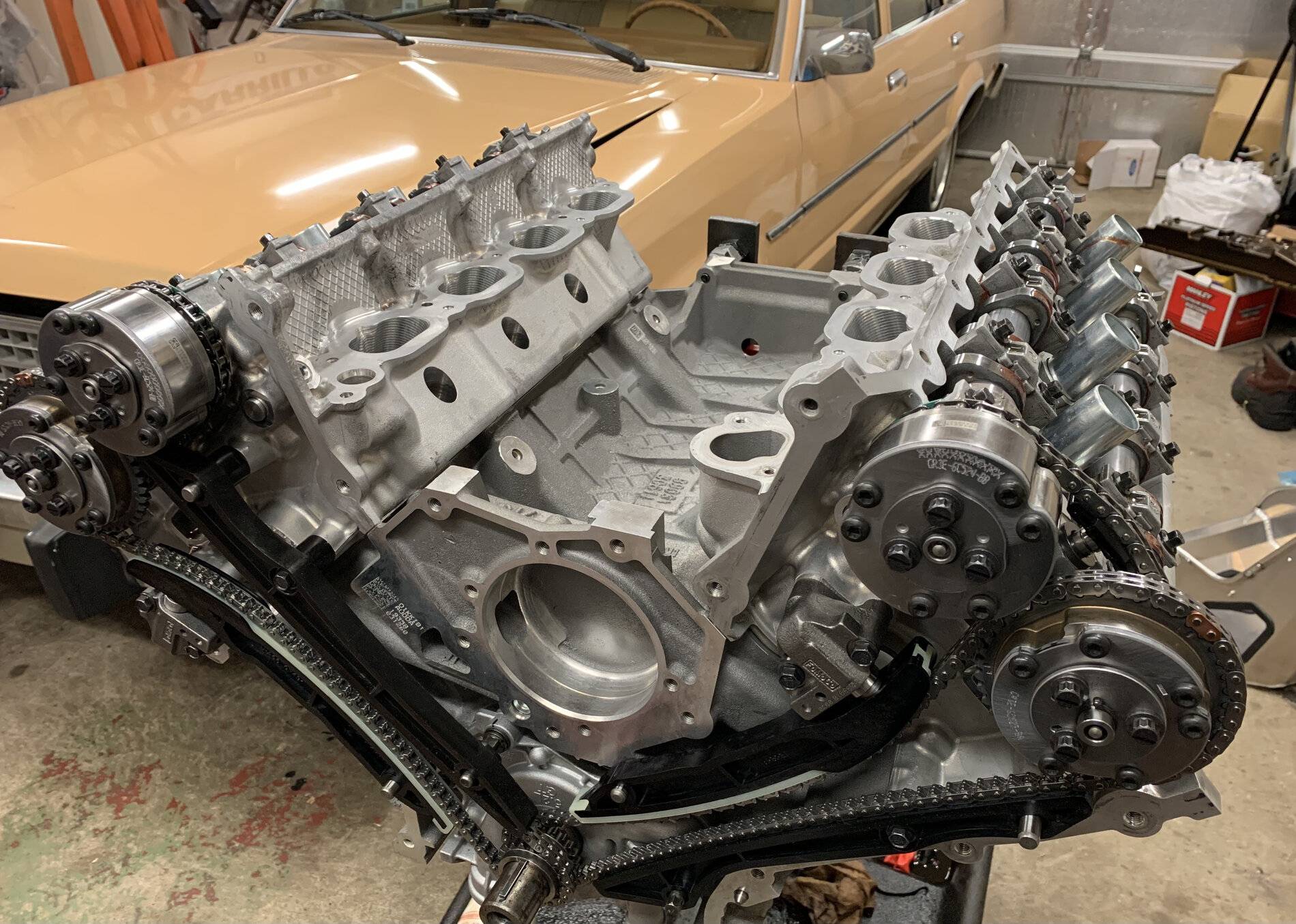

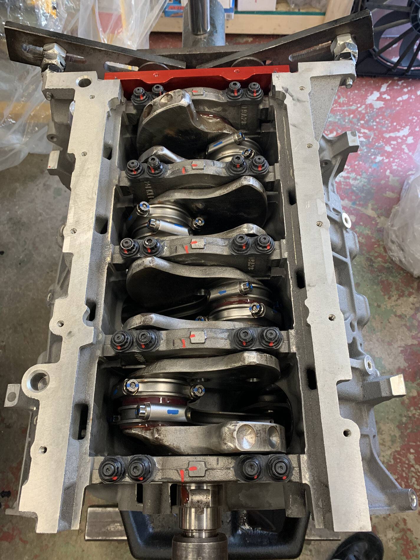

Motor is finished and Installed and running... will send a running vid shortly, JMS in El Monte Ca was great to deal with. The owner Mike was very helpful navigating the parts needed.
https://jmsracingengines.com
JBG0137
JBG0137
Aug 4, 2021
77
61
Calif
John
2016 GT350, 1965 Mustang Fastback, 2019 GT350r
And what exactly did they do?
I purchased the Gen 3 block and crank , the shop bought all the other parts, Manley Rods, JE pistons, HS Forged Gear, 12mm head bolts, billet oil pump. first road trip is tomorrow..I will update
