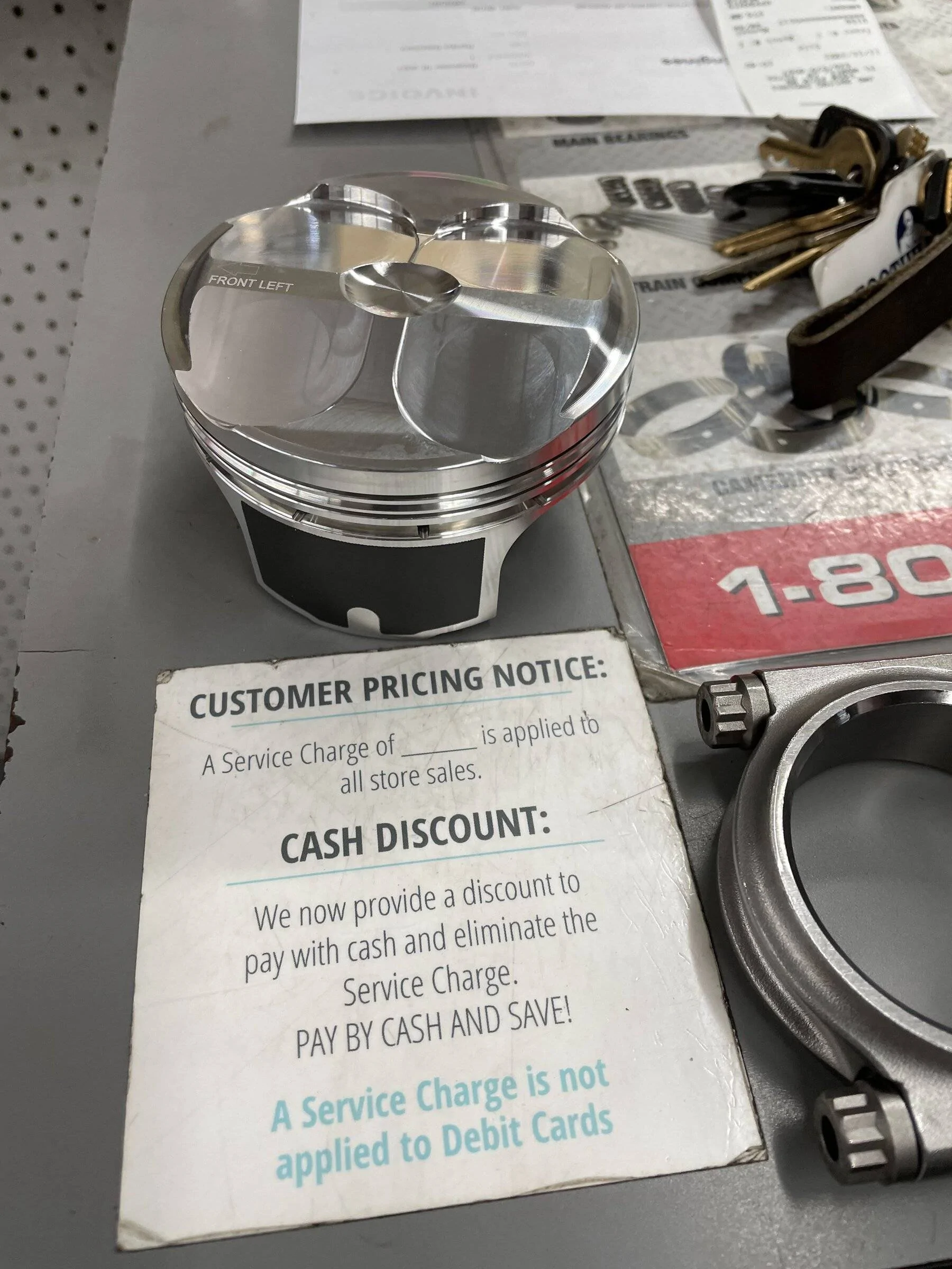

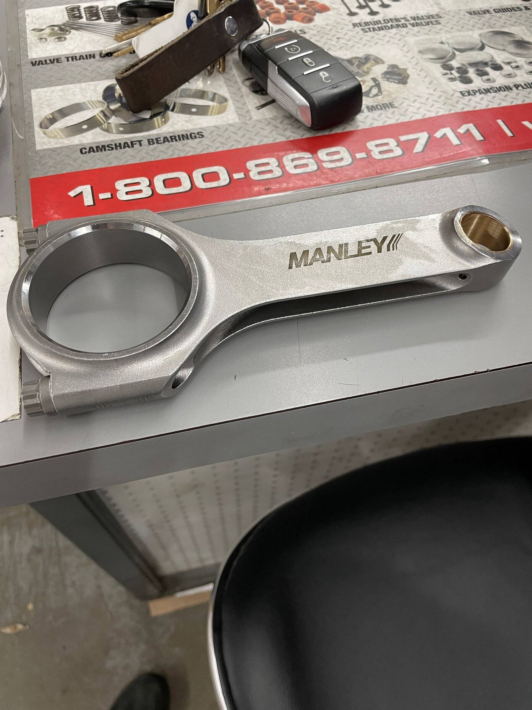

Yes on the 12.5 cr, yes check the Manley website
Ford 5.2L DOHC "Voodoo/Aluminator XS" V-8 Shelby GT350/GT350R Mustang (2015-up) & Aluminator XS Crate Engine H-Beam Rods
Very nice . Do you notice the bump in CR driving ?
Definitely should have got the pistons gas portedVery nice . Do you notice the bump in CR driving ?

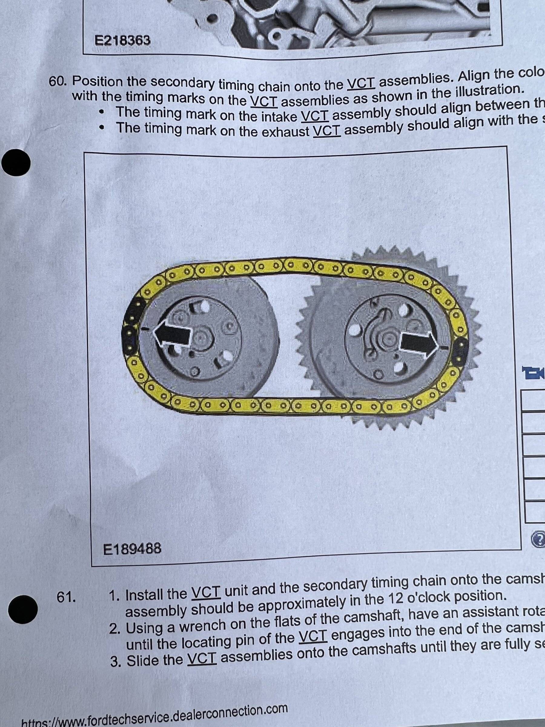

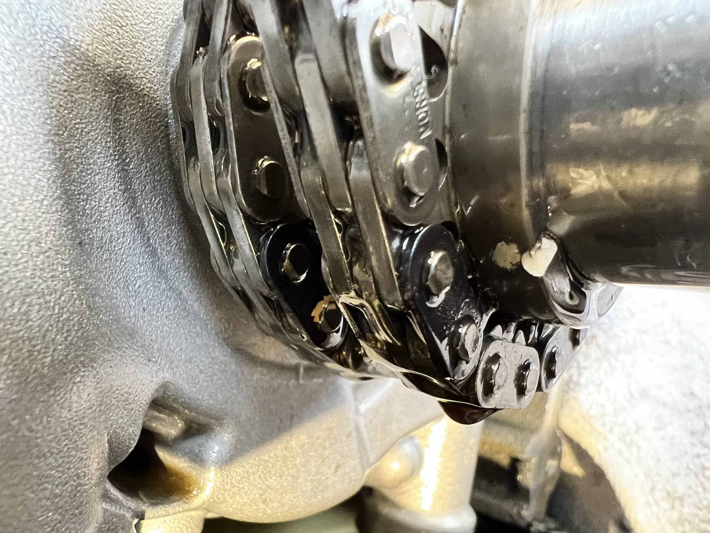

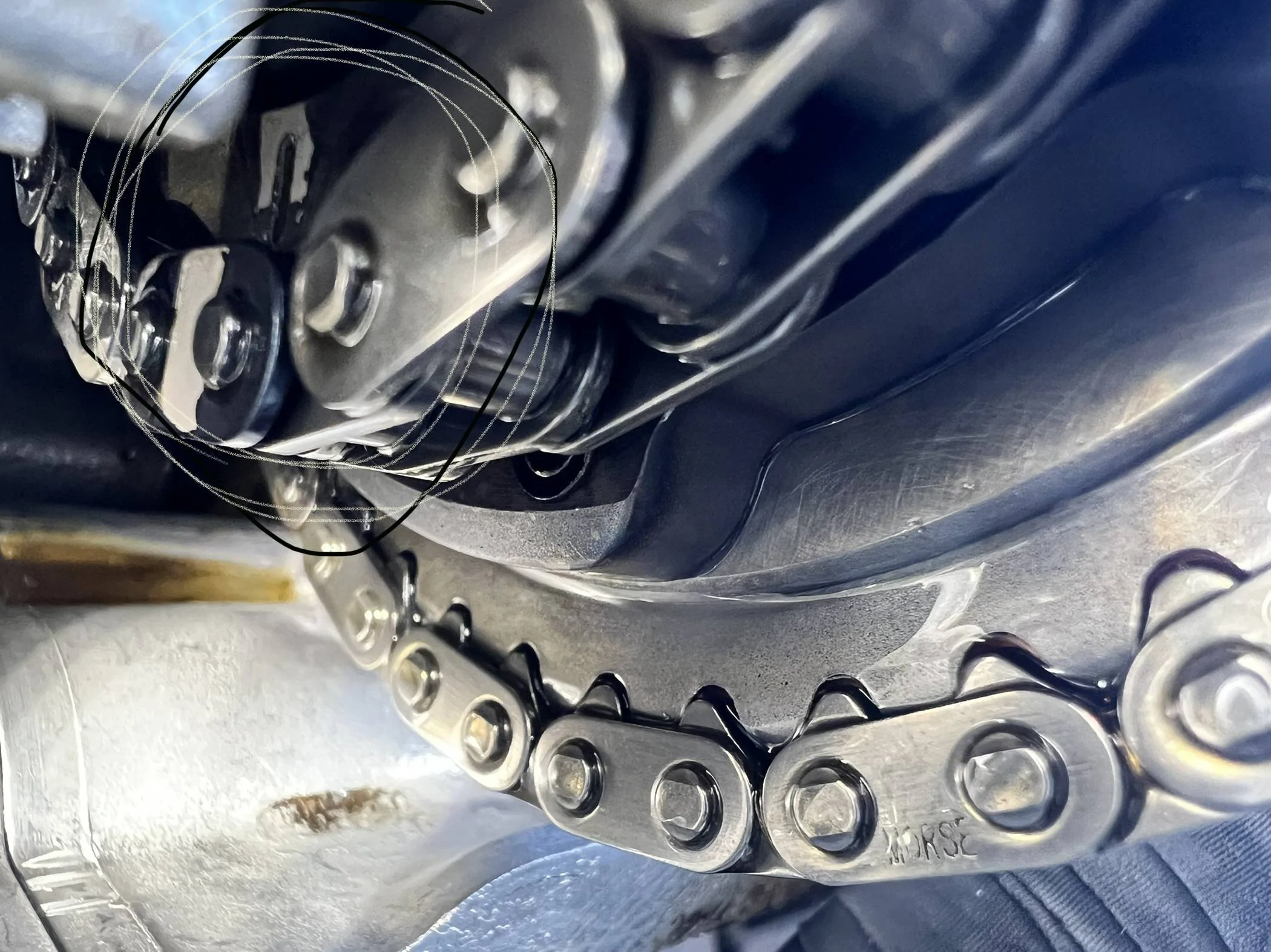

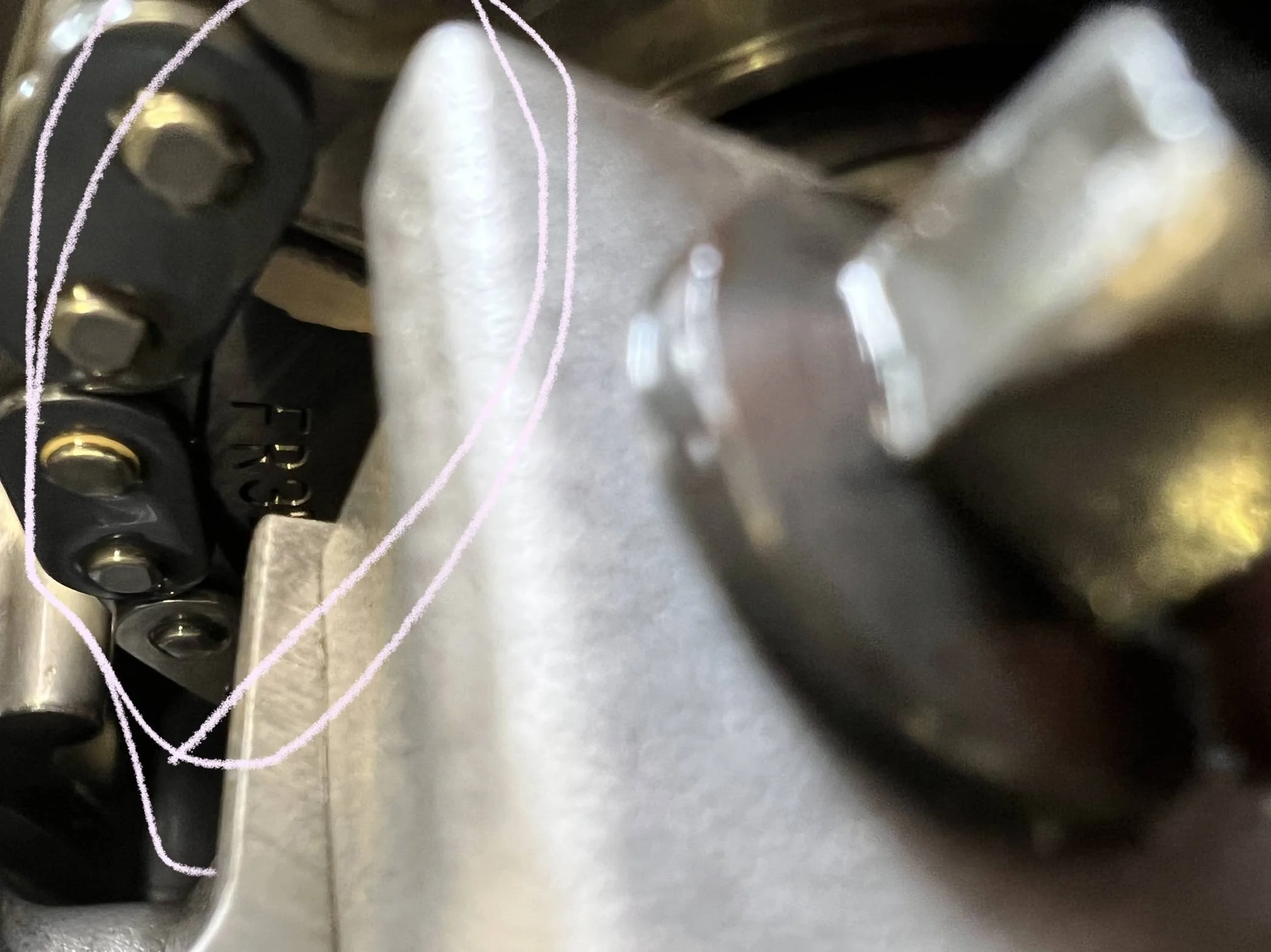

I will scan the printouts from the Dealer mechanic and post them for you to see, apparently the Cam Phasers can move the cam 17 degrees +- from center and one tooth was 20 degrees off and it shows the phaser pegged at 17 trying to bring the cam back into the correct position. Hat’s off to the Ford TrainingI'm blown away a dealer was able to diagnose that.
