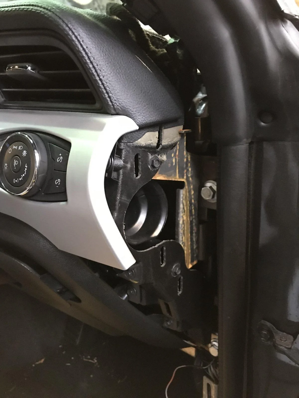

Still ongoing. I went back today to pick up the hire car Ford had arranged. 68 plate white Focus ST line. Rather nice actually - so that made me feel a little better.
They are still chasing the leak for now, but I know for a fact that the tech won't be putting the car back together until he's 100% satisfied the source is identified and sorted. Under guidance from the UK Mustang technician, they've looked at the grommet in the bulk head. These have been known to fail, but what was interesting was the photo he showed me of the "known issue" being the location of seam sealer that runs past where the hole is, meaning as the rubber grommet sits against the flat metal - it's not entirely flush against the panel - because of the raised "ridge" of sealer, so tiny gap, enough for water to get in. In attempt to address this, I believe he said they've added some sealant to reinforce the seal which they'll need to test again for any further leaks.
They speculated that my issues is as bad as it is purely down to the time factor - a tiny amount of water entering over an extended period of time, may have been this way since new. Obviously we all keep our Mustangs in different places, mine is fully exposed to the elements, sat in the rain/snow for days/weeks at a time if that's what the weather situation is.
I took a cheeky photo whilst I was chatting with them - you can see some surface rust where there has been water present behind the trim in the A pillar. Supposedly nothing a bit of WD40 can't address. The tech will see the full extent of any water damage once the interior is taken apart, and he'll be addressing what he finds. Got a peek under the carpet too - and nothing of obvious concern, yes the carpet was slightly damp underneath but no obviously glaring patches of rust. all looked clean & tidy.

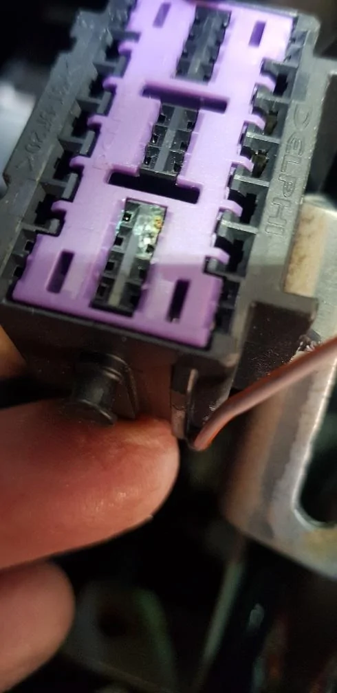

The unfortunate news for me is their recommended fix being a replacement of both the main body & dash/engine compartment wiring looms. They quickly found some corrosion on the terminals that connects the 2 looms (pic below), meaning they both will get replaced. The connection is right in the area where I had water streaming in a year ago. Doing this is a big job as you can imagine, everything is coming out!
No sign yet of any repair work that took place at Guildford 12 months ago, but judging by how much less water is in the interior now vs last year, I'd say they did do something. Jury still out on that though.
Can honestly say it's a breath of fresh air dealing with Hungerford - no hesitation to walk me in to the workshop & have a 10 min chat with the technician there. He's a sound guy and right now it's the only guy I'm happy with working on the Mustang (within the Ford network). They have a nice little folder for my warranty work, complete with photos taken.
Next step is to wait for news on the parts order. Apparently the wiring loom will come out so they can be sure of the correct part # to order.

Sounds like they are doing a thorough job. None of the damage looks too serious so once fixed it will be fine. One thing is for sure - if you start wading in with a solicitor the whole process will clam up and you will have a very different relationship. I would let it run for the moment if they are doing all they can.

It’s good they’ve picked up the damage to the electrics though, that could have been a nightmare later. I had an old Chevy Blazer with corrosion inside a plug coupler. It was a dog to find the fault.
