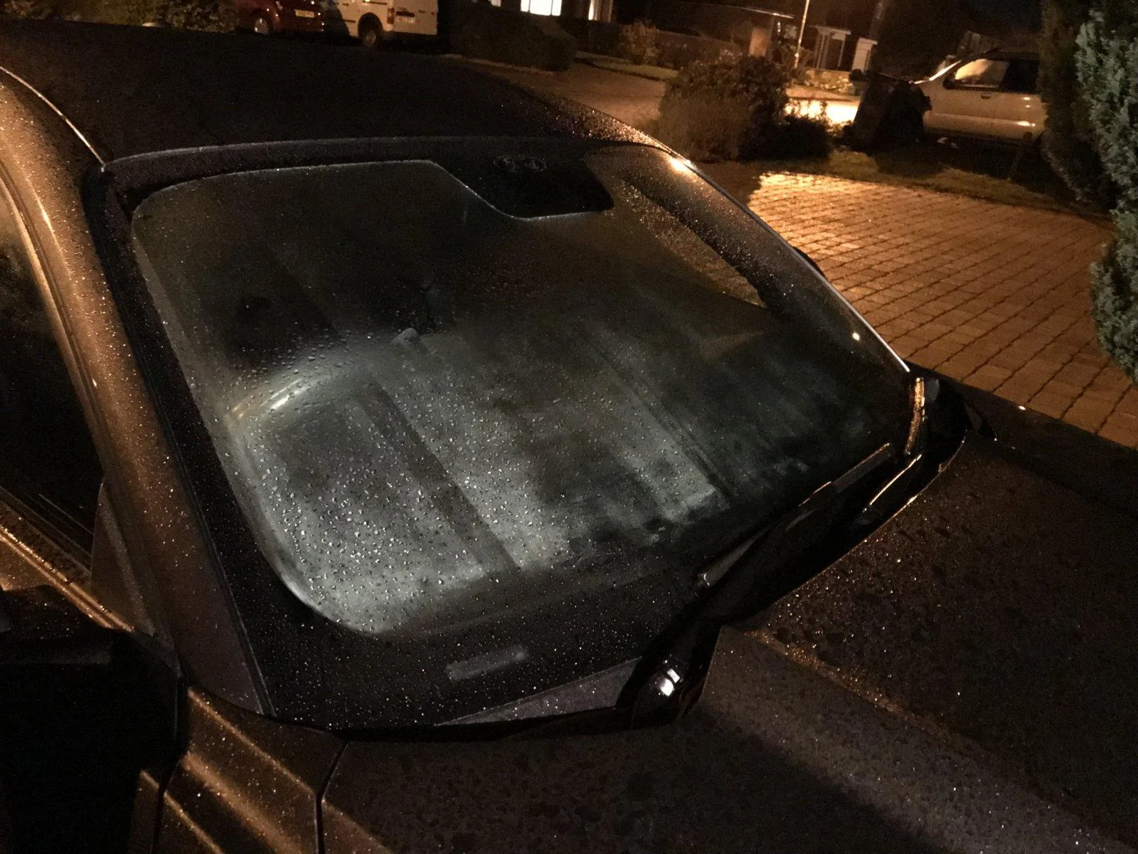

well imagine my horror seeing the state of my windscreen this evening (you need to know my full warranty saga from the beginning of the year for that to make sense)! I hate to have to write a post like this.
My mind is flicking between full panic/stress mode and feeling confident it’s just down to the weather on this occasion.
Important to mention here that the Mustang has been sat on the drive for a good couple of weeks - not even opened the door, exposed to all the elements, temp changes etc - today was relitively warm/sunny here and obviously now the temp has dropped since sun down.

Anyone else out there have this with their stang, or other cars when left sat for an extended period of time? Please tell me its normal! A quick google suggests it is, some models more prone than others.

More than likely there was some additional moisture in the car although they said they "left to dry out completely." Perhaps take it for a long drive with AC and Heater on and see if that dries it out more.
But definitely check for any dampness.

You don't need much water to do that so if the floor mat was wet the last time you drove it then that may be enough. certainly something on the drivers side with the look of it. If the climate is on auto it will quickly dry out on the next journey then see if it happens again.

I had similar in a Mondeo a few years ago and it was a disconnected A/C drain pipe in the drivers footwell. Footwell was very soggy so easy to find

Difficult to judge from your initial picture.
Until earlier this year I had a 64 plate A5 convertible.
It was getting really bad condensation on the inside of the windshield, actual droplets just sitting on the inside surface of the glass.
A/C wouldn't shift it. Dealer needed to see the issue before agreeing to address it (the car was still within it's 3yr warranty)
Catch22 was how do you drive your car to the dealer when you can't see through the big window for all the condensation on it?
Some what counter intuitively Audi indentfied a seal in the boot/trunk was to blame.
I suspect they knew where to start.
Seal replaced under warranty and no condensation after that.
If the condensation doesn't clear, very quickly, when you use the demist setting on the H-VAC, then I'd suggest the dealer needs to look into the issue.
Sorry to learn you're having these issue, best of getting it assessed and sorted.

If its any consolation I've had windows like that before,and when i checked my carpets they were dry.I think it was more to do with the climate control than anything.

It could just be down to weather conditions, if there is a rapid change in temperature any moisture in the air just condenses on the coldest surface in this case the screen. A couple of weeks ago I was driving my open car with no heater & the screen very quickly fogged up both sides.

the rear on mine seems prone to it depending on the weather as for the front its not too bad i find its better if the screen is cleaned
