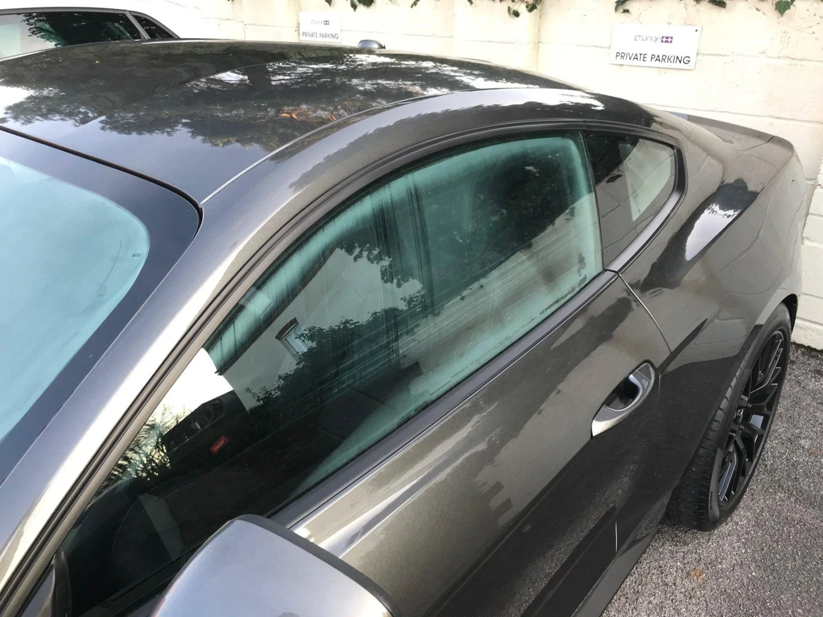

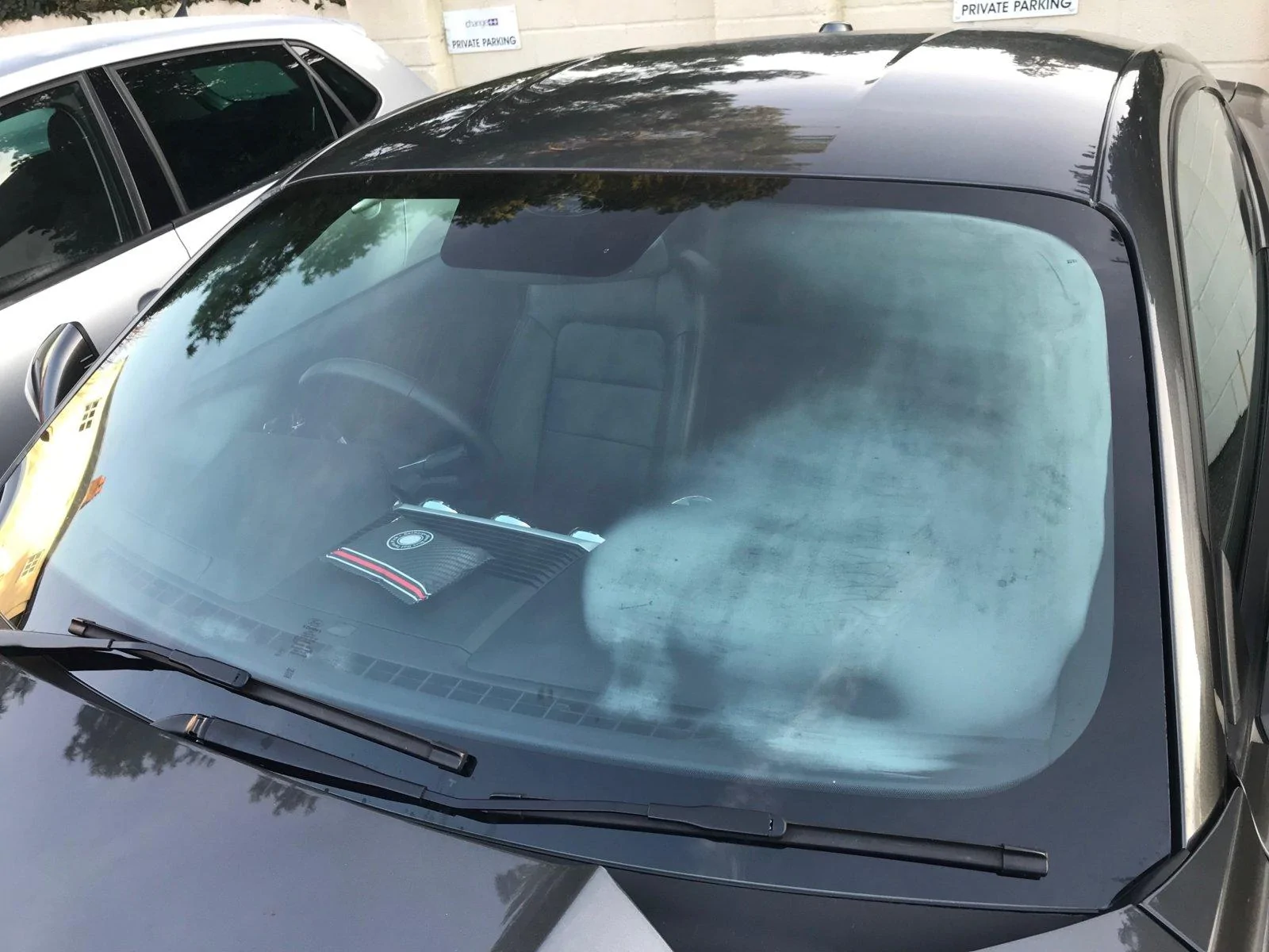

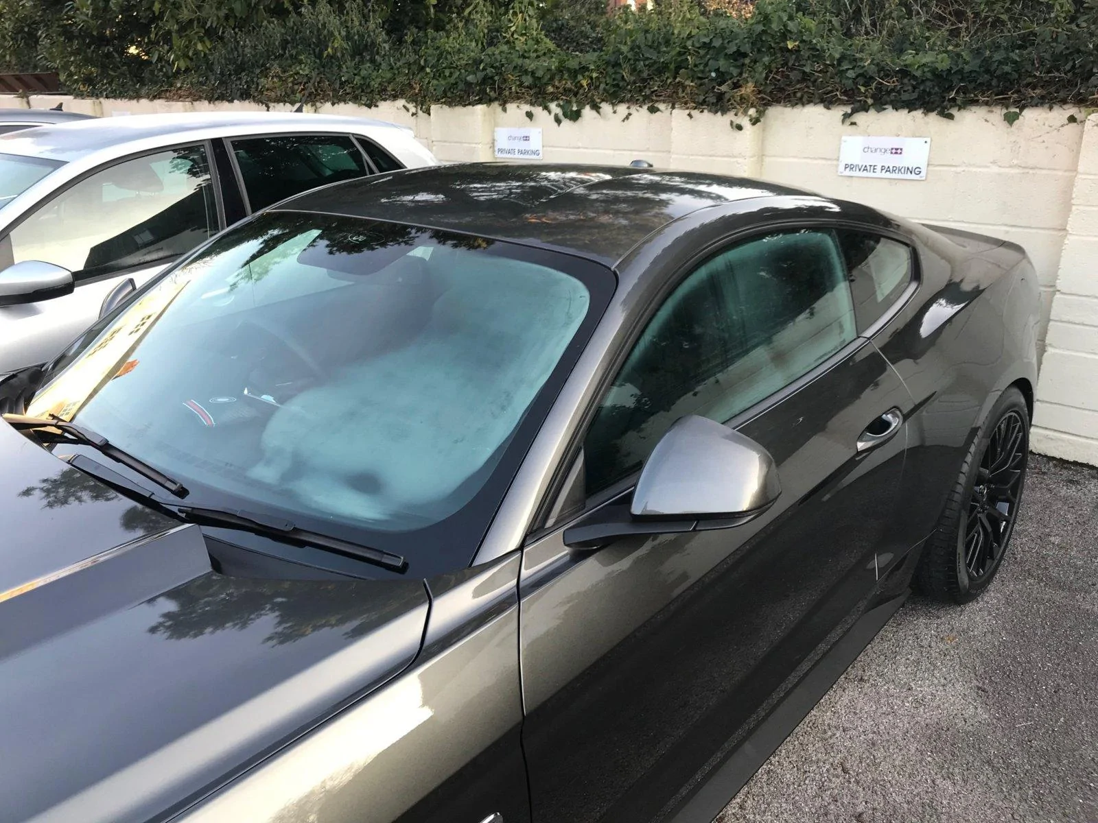

Thanks very much Paul, appreciate the input :) part of me thinks the same about your 3rd point, my driveway is in a prime location for warming the car interior up whilst the sun is on it, then dropping rapidly when the sun drops below houses. I've seen that in days where the car has literally been sat there an not moved.

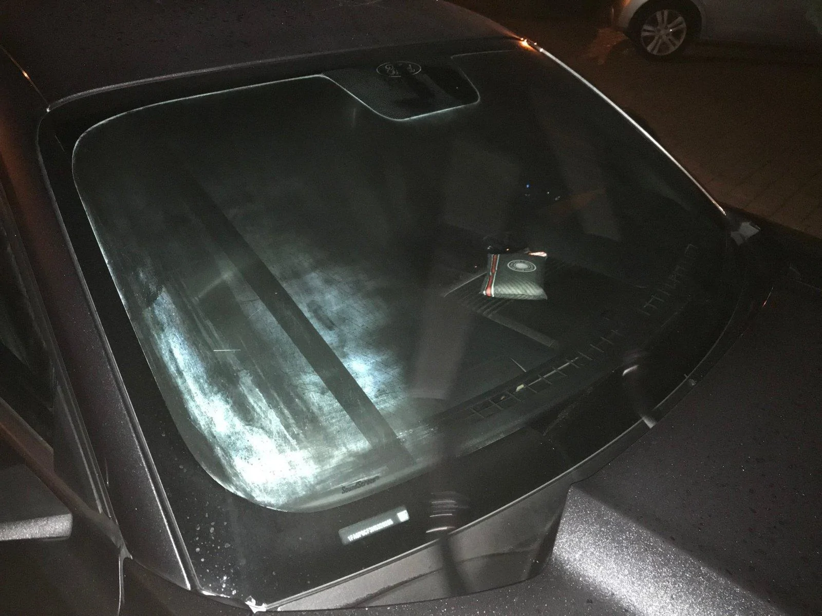

I've just sent an email to Ford Hungerford with an example from this morning. Long story short; 1 hour drive to work. Photos are from one hour after parking. 2 hours after parking, condensation (or "misting" is probably better as you say) is pretty much gone. Pre drive photo attached also - I'd not really expect to see condensation here but I do - this was at 7am, about 1 degrees outside. Don't ask me what the hell that very obvious line is in the windscreen! Hopefully I've given them enough to go on, keep ya posted.

The line seems to be residual from tape on the screen prior to or during installation. I’ve had this on more than one car. Doesn’t seem to matter how much you clean it, it’s still there.
