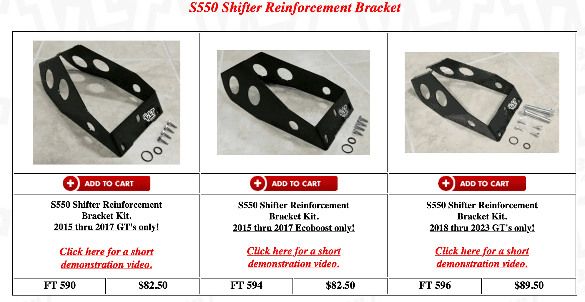

not true. Full Tilt Boogie makes a bracket that mounts the shifter directly to the trans. $100 bucks. The shifter really isn't that bad it's the mounting to the body and flimsy rubber bracket / bushing that's the problem. you don't have to spend $600 to fix this.
Can you provide a link with more info and where to buy?
Full Tilt Boogie Racing's web site is like opening an old Geocities page on archive.org.

I had the same issue getting through the website and that’s why I went with steeda. Now I wish I went with this. In fact I think I’ll be ordering one to swap in
what’s the though process on running this with the steeda bracket?
I see a good chunk of positive feedback on the Steeda for street use, any reason you're not satisfied with it? Still having high speed lockouts or something?
With the upgraded transmission mount it would probably be perfect but since I am running the stock rubber mount the trans moves on hard acceleration still. The steeda mount can’t solve this problem because it doesn’t tie into the transmission itself. So on the 2-3 I still hit the side of the gate on hard acceleration. It no longer locks me out but slows the shift way down and isn’t very confidence inspiring.
Gotcha. I think this is why MGW is so popular. It's pricier than buying a more aggressive bushing and bracket, but sorts everything all in one go.
While I enjoy working on my car, you have to take a lot apart to trans mount.
