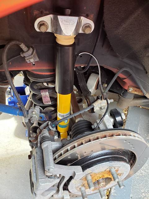

I have the Steeda mounts with B6's
Had the mounts with the stock shocks as well.
No noticeable increase in NVH.
I found it easiest to put the mount on the shock off the car. Easier install.
