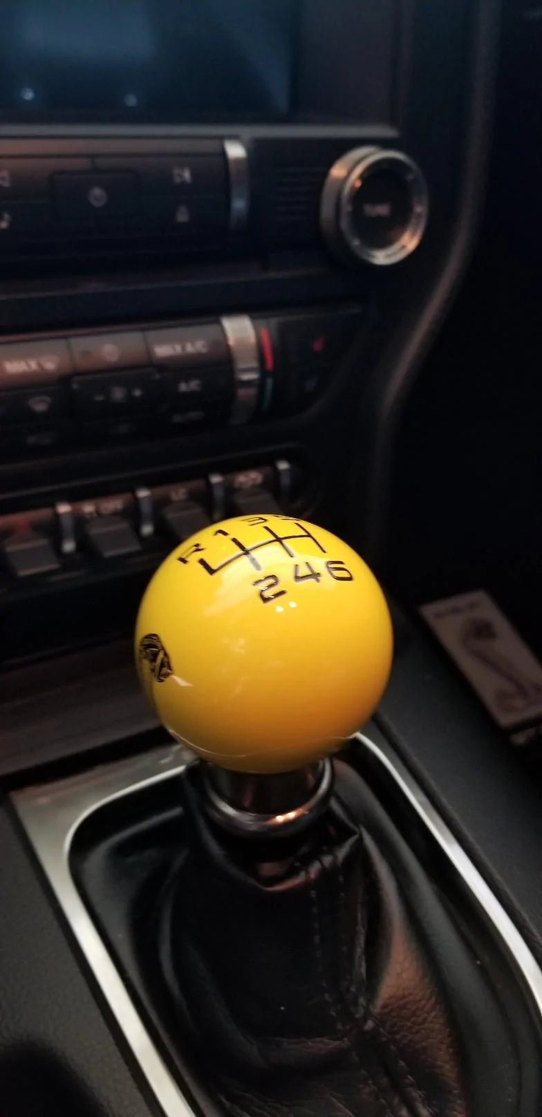

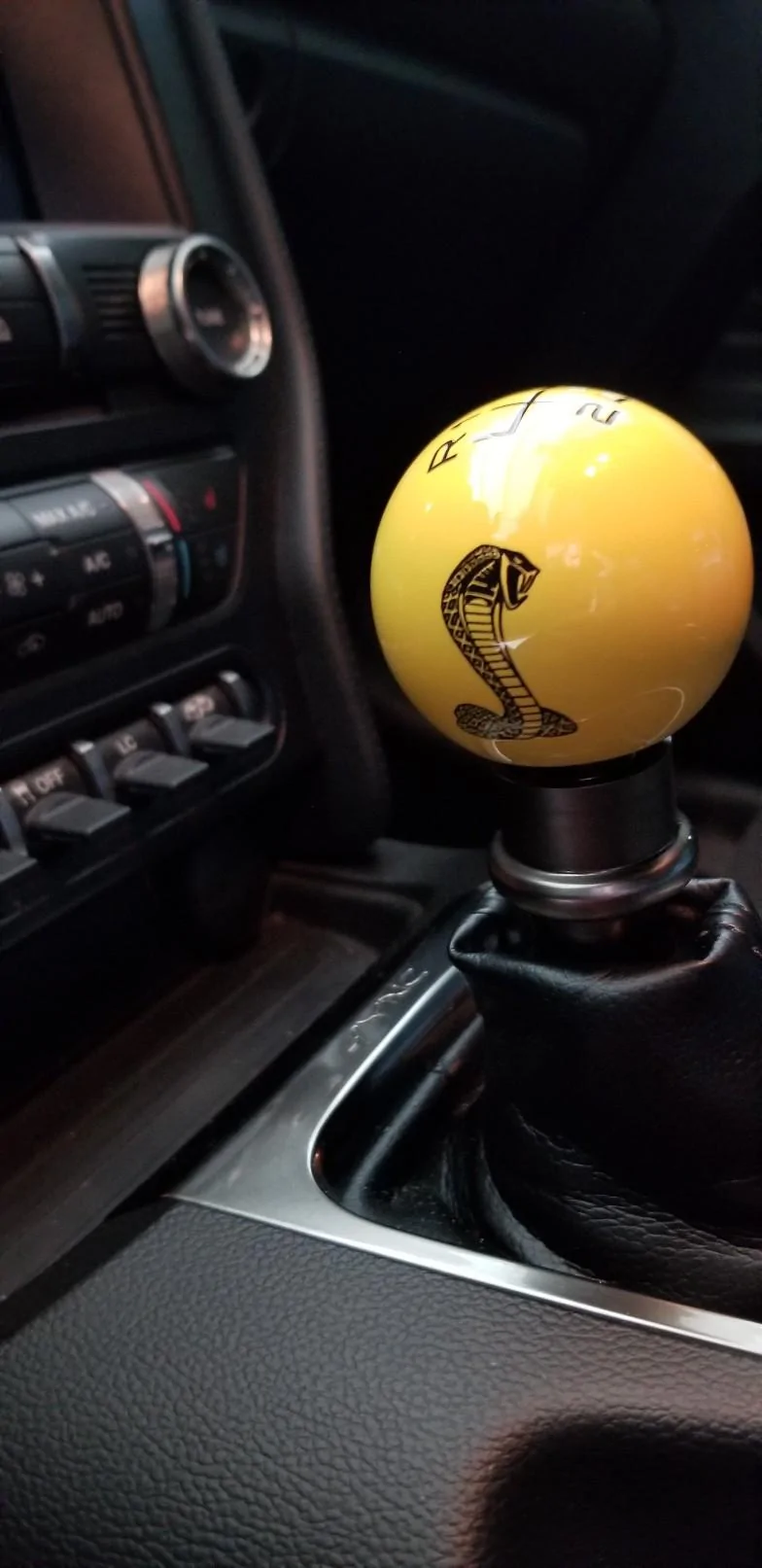

Nope. Came off with ease. Loving the new one!
Stoked
May 14, 2017
173
OKC
2017 Focus RS/2016 GT350/2002 Audi A4
Feels great. Its quite heavy, and now the shift action is much more precise (to me).
I have larger hands, and the size of this one fits much better in my hand than others. Quality of the work is top notch. It was done by Anarchy Motive. Takes a good bit of time but being entirely customizable and done at this level of quality for the price, I'm happy with it.
