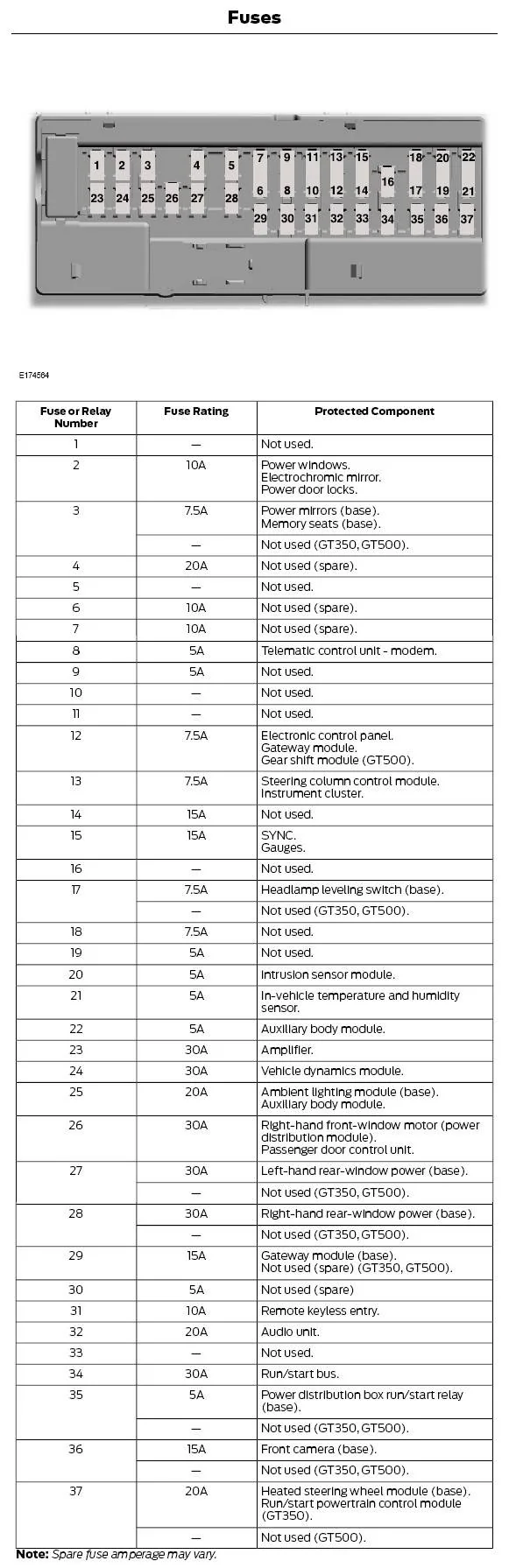

I think the fuse is located in the Body Control Module (BCM).
F8 - 5 amp - Telematics Control Unit (TCU) Module
Passenger Compartment Fuse Panel
The fuse panel is in the right-hand side of the passenger footwell behind a trim panel and plastic key code card.
To remove the trim panel, lift it from the rear retaining hooks, while pulling it toward you and swinging it away from the side. To reinstall it, line up the tabs with the grooves on the panel, drop the panel back into place, and then push it shut.
To reach the fuse panel, first remove the key code card.
After replacing a fuse, return the key code card to the original position. To reinstall the trim panel, lineup the tabs with the grooves on the panel, drop the panel back into place, and then push it shut to reinstall the trim panel.

Think Earl said fuse #8 position not #5.

The option I am going to use is to pull fuse #8 and get rid of the whole datalink.
