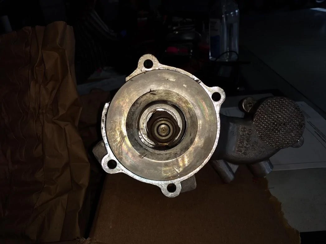

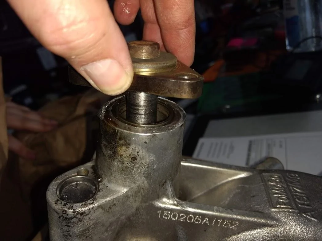

The dealer called at 10:30 this morning and my car was ready. Picked it up and inspected the water pump. Impeller was busted out the middle, the bearing was gone, A tensioner pulley was damaged as well. They did not charge me the ESP deductible, which leads me to believe they know this is a problem.

Interesting . What model of mustang is this? What engine?
50,000 miles?
