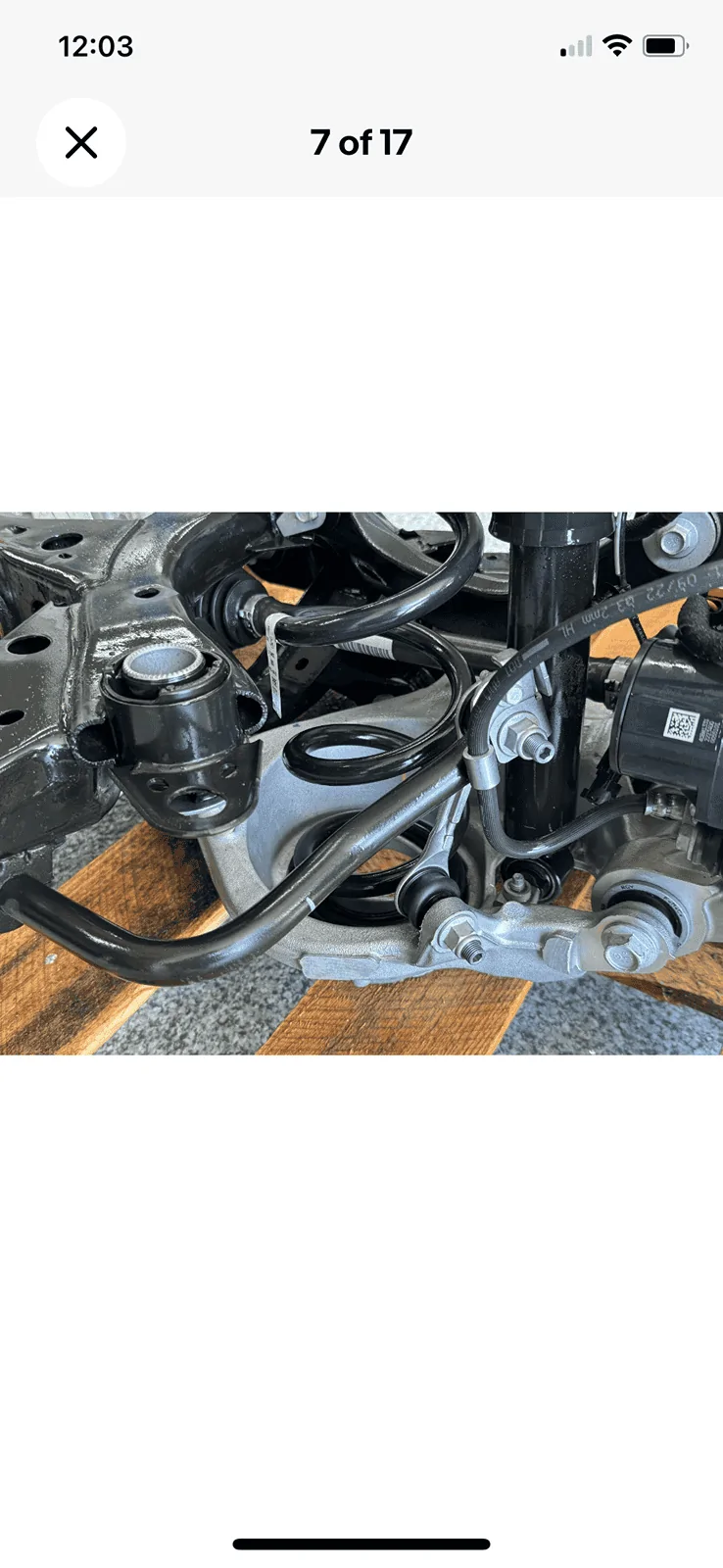

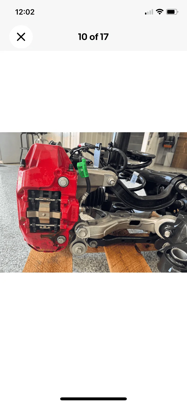

I see EBay has a 2023 rear suspension with Brembo package. From the pics, it looks like the suspension is a little different from s550.

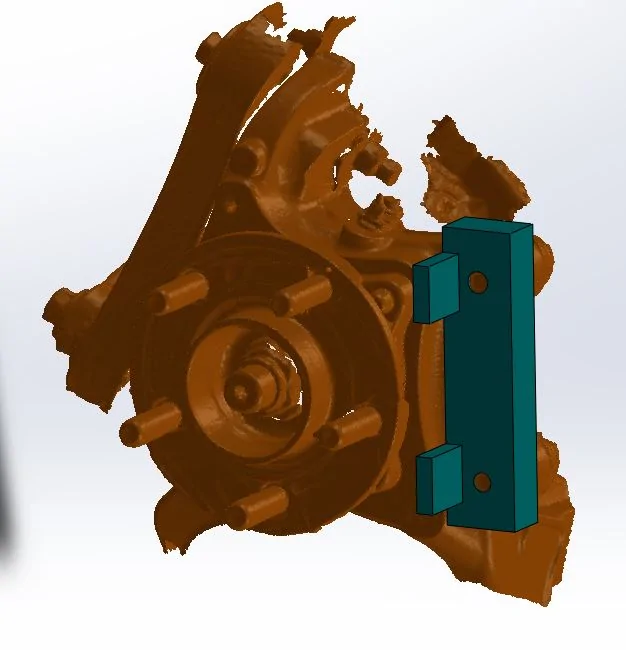

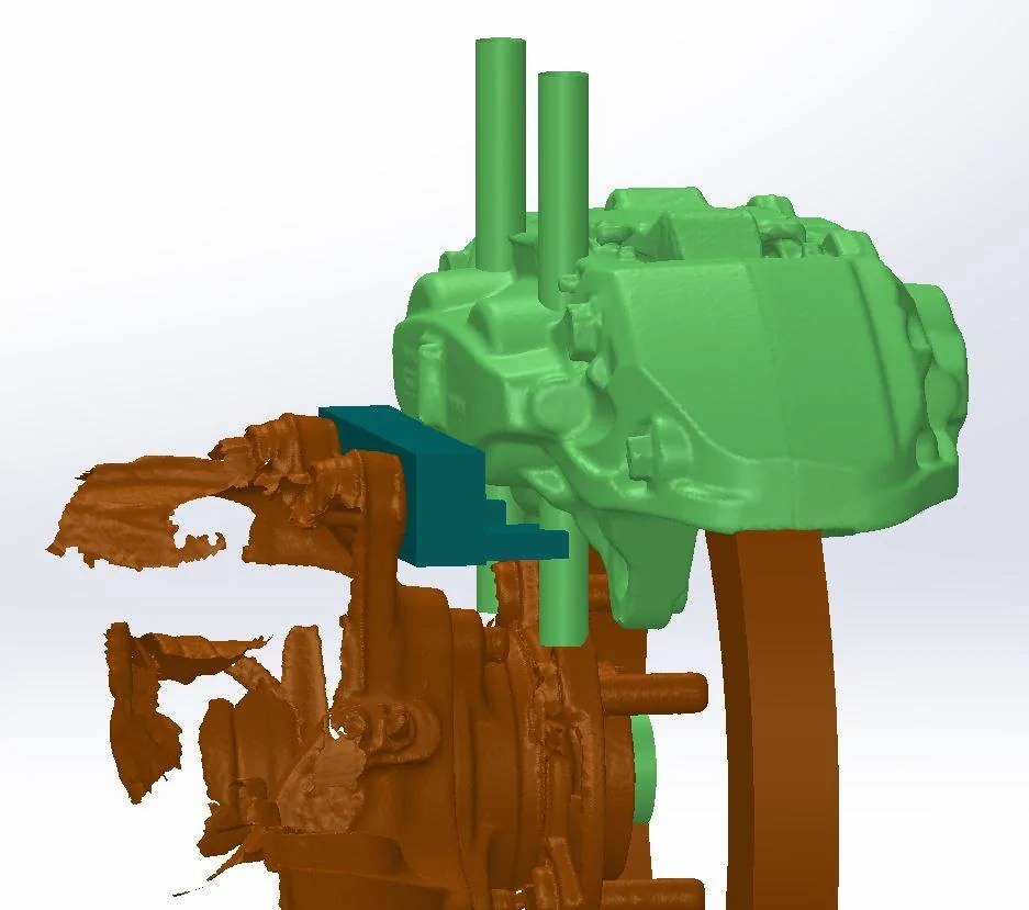

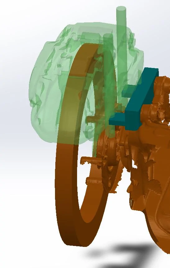

i scanned my rear knuckle, i also took a scan of the 4 piston fronts and added 2 surfaces that represent the bolt holes on the new calipers. also did a scan with the rear rotor on to measure offset from wheel bearing face to inner face of the swept area on the rotor. as you have discovered already mounting holes on the new caliper area perpendicular to the axle centerline
