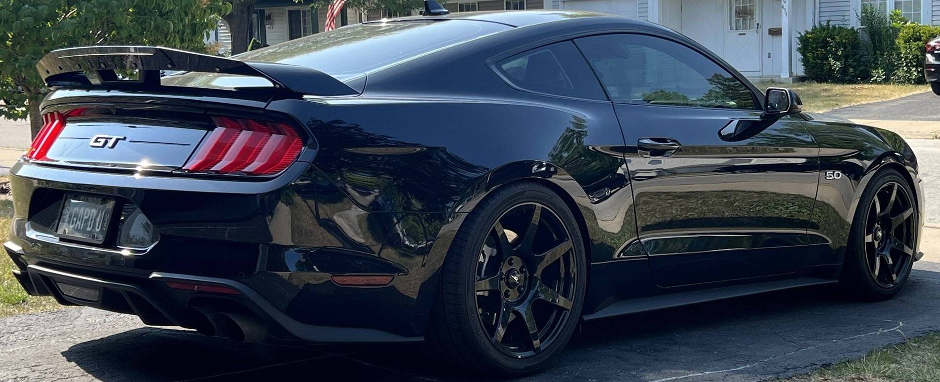

I have a 325 on 11”.

Any chance you have a pic of the tire from behind the car so i can see the profile the tire makes? All good if not
Unfortunately this is the best I have, not sure if it helps at all, probably not lol.
Thats fine! Thanks! Just wanted to see how it looks, sometimes a smaller rim makes a stretched look and i dont want that necessarily

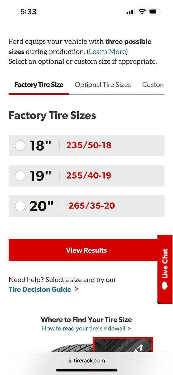

Im pretty sure the stock is 265/35/20, based off tire rack as the car is not near me currently to check. Im going to keep the stock profile just a wider rim,whichever is oem, the 30 or 35 profile

If OEM is 265/35/20 you’ll want 305/30/20 or 315/30, not 35 profile. When you go wider the profile height also goes up, so that much wider you need to go down a profile to 30.
11” is good for 305 or 315. My ZL1 comes with 305/30/20 11” wide wheels. For comparison the ZL1 1LE has 325 width and 12” wide wheels.
