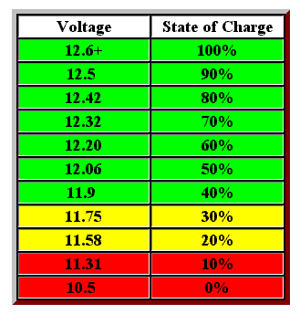

I you have multimeter try this. It won't fix anything but it'll give you an indication of battery health.
1. Measure the voltage after the car has been sitting for a few hours. A good battery should be in the 12.4 to 12.6 v range (see attached chart).
2. Crank the starter while measuring the battery voltage. This will likely be a two person job. And while cranking hold the gas pedal to the floor. That will prevent the engine from starting but still allow cranking. If the voltage drops below 10 V the battery is getting weak.
3. Start the car. As others have said the voltage with the car running should be 14.5 ish or so. That's the normal output voltage of the alternator and charging system.

OK, thanks for all the feedback. The locks have been behaving themselves since my last message. I did check the battery this morning with my multimeter and it shows 12.1v. which is just over 50% charge ... There isnt a date stamp on the battery, but it does show FoMoCo Dearborn Michigan.
Given I live in Scotland, I reckon this is the original battery.
Generally, how long would I drive to charge it to full from this level (assuming it will charge to full)
I will be embarking on a 300 mile journey on Monday, return leg on Tuesday.
Ill try & get a battery before then (Halfords have one for around £120), failing that I'm sure she'll last another 600 miles.

Ran my multimeter on the battery, 12.3 and I’ve been out today.
Had my son run the multimeter whilst I started the engine, 10.3v, before shooting up to 14.5.
Got a 300+ mile trip tomorrow, back up again on Tuesday. I’ll be interested to see what the meter says both days.
