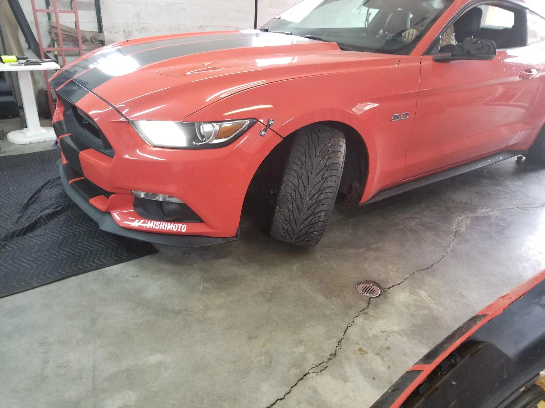

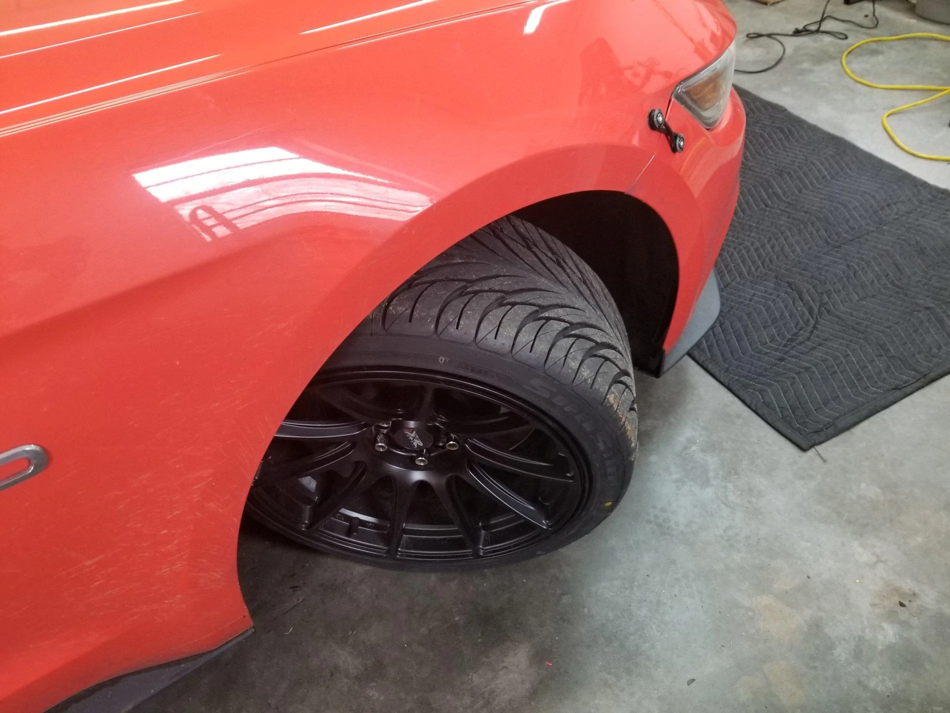

Hell yeah man I appreciate it! I update my instagram pretty much Everytime I do something and will be posting videos from this weekend if you want to follow that as well. These rack spacers were sent to me from Russel when he modified my knuckles. I'm assuming they are generic I had to take a dremel and a sanding attachment to make them fit over my tie rod but not that big a deal car maxed at 50 degrees of angle. I measured my wife's stock one at about 37 degrees.

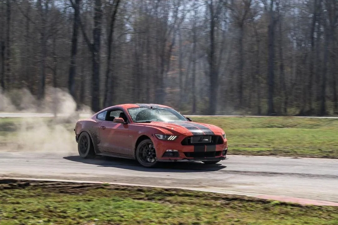

All I can say is WOW. Considering how the car performed last year stock vs where I currently have the car is amazing. Had unlimited seat time this past weekend at midpond. I came of the track only 3 times. Once to eat and the other to change tires. 8 hours straight driving and I never saw coolant temps above 200 degrees! With where the car is at now along with how I have progressed as a driver I am looking to make my way into pro am by 2020!

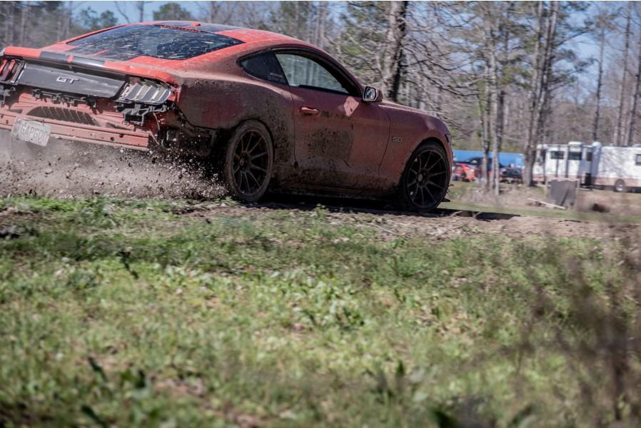

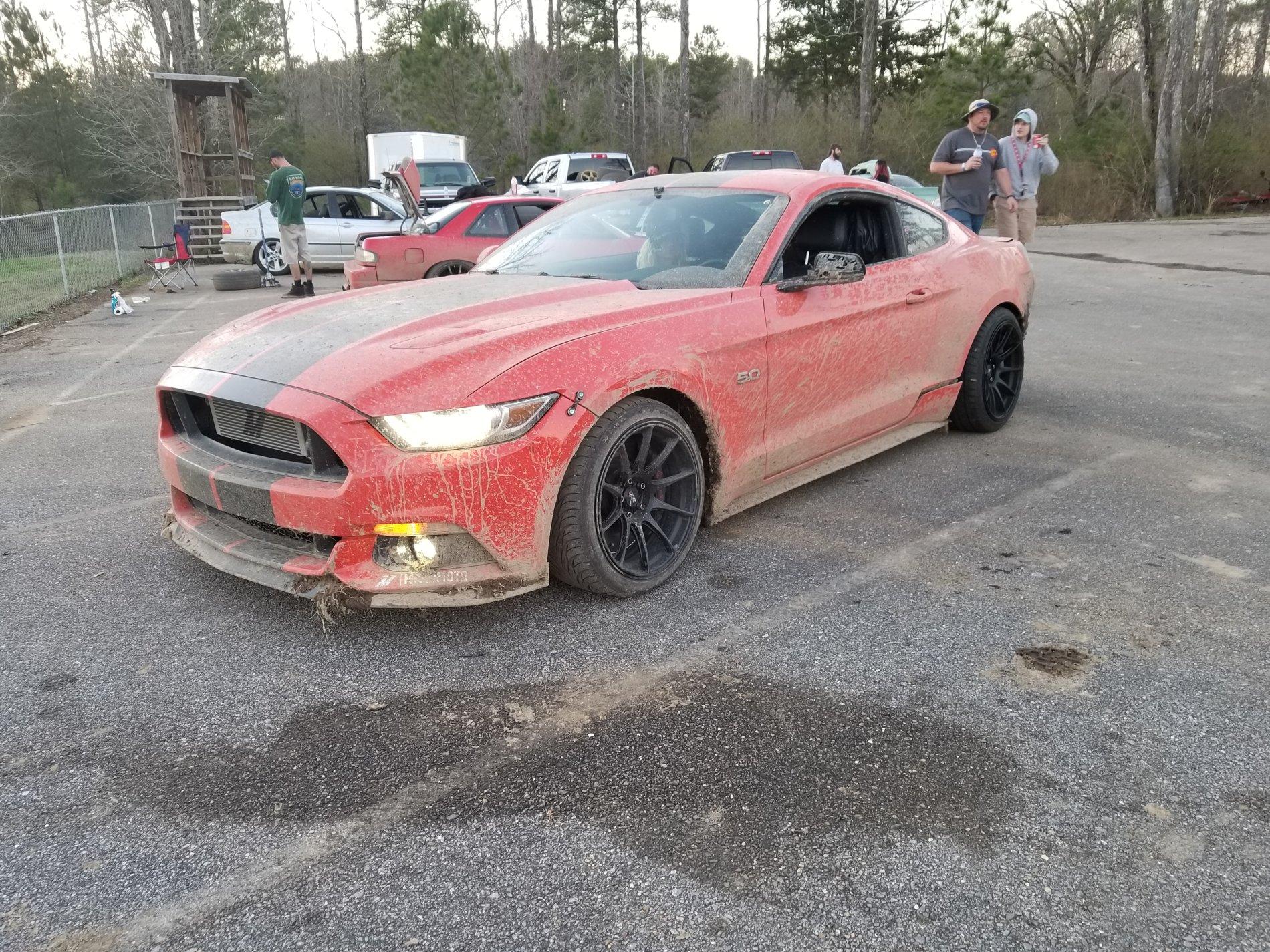

Some more shots from this past weekend at midpond.

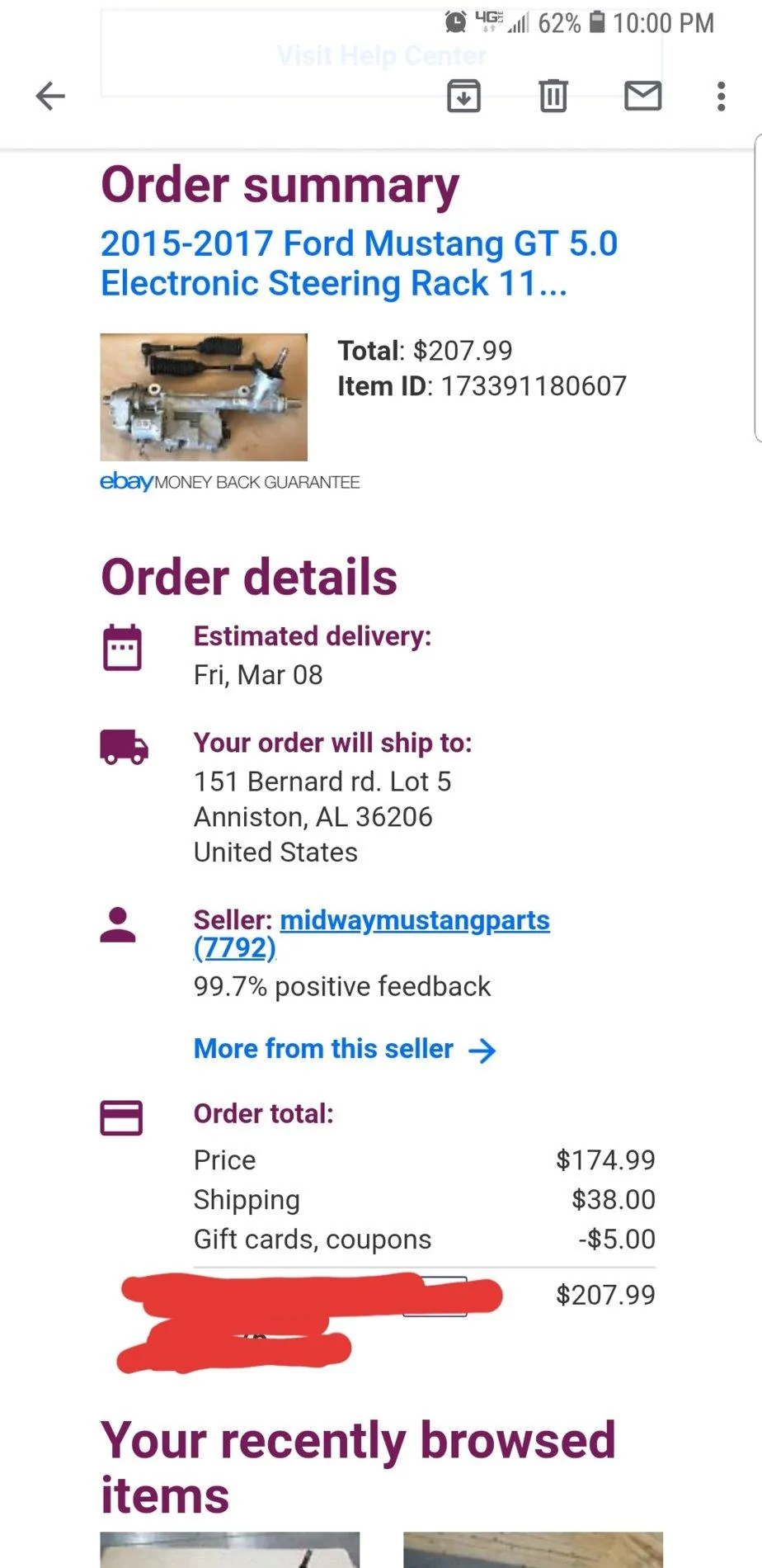

Had a boot come off and not have the rack sticking and grinding it sounds like from dirt/mud so I ordered a replacement 11k miles unit.
