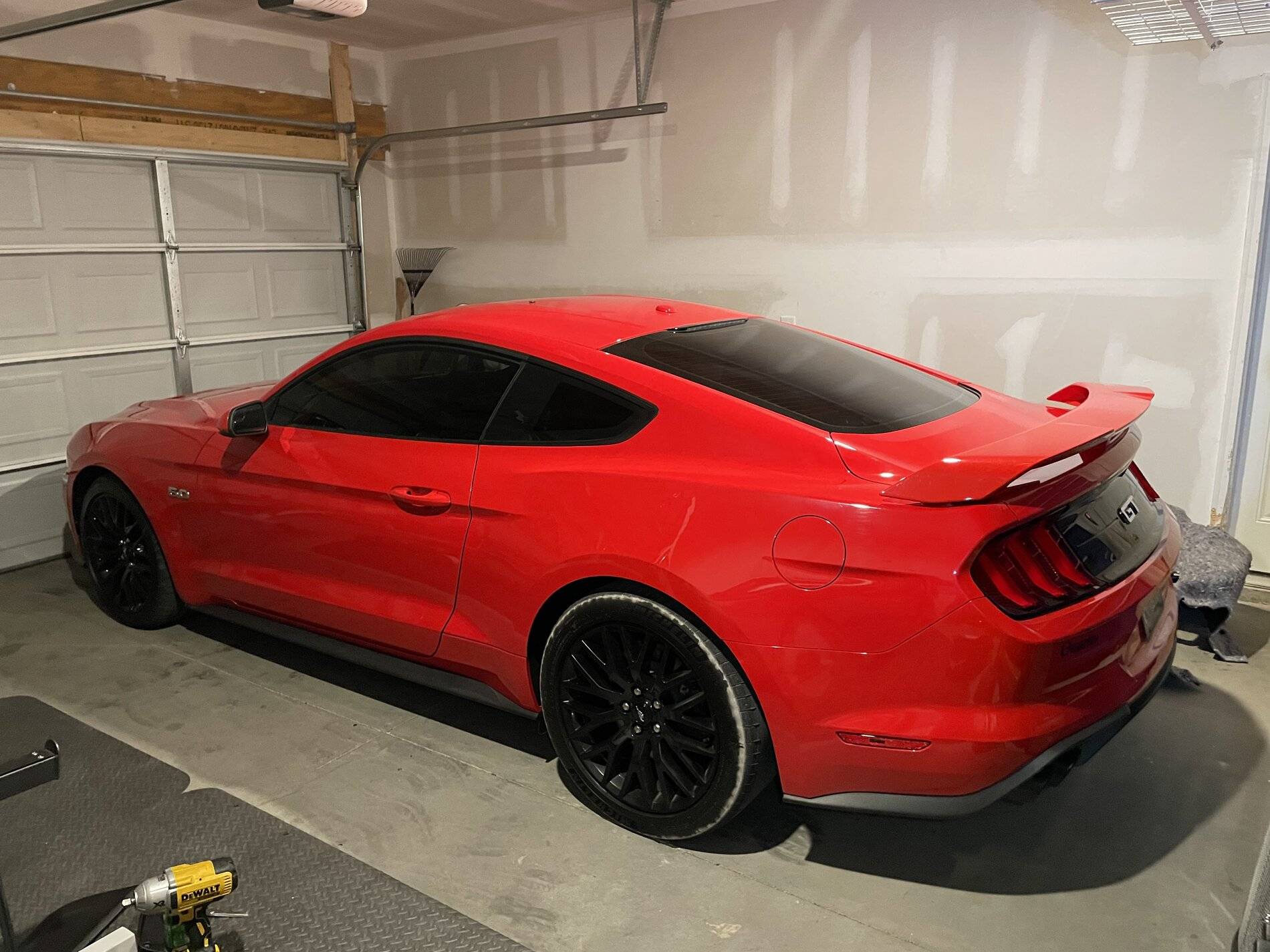

Hey guys, wanted to get in and introduce myself and the build in progress, hoping to get some info from some members here to help me along the build! I know that most folks on here probably aren't huge into the drifting scene, but this should be an amazing platform for what we are shooting for! Looking to do a similar build to Justin Pawlak's FD Mustang, here is a link to the build on it if you're unsure of who I'm referring to - . So far we have taken a 2019 Mustang GT with 1,107 miles on it down to (almost) bare bones, still have a lot of modifcation left to do on it, but will be getting into wiring shortly and would love some help... I will list out parts ordered and plans for the build, as well as some photos, any thoughts or feedback would be great! Coming from a LS Swapped 240sx platform, so will be a bit of a learning curve.
Build Plans -
Using 5.0 stock block, changing to metal oil pan w/ oil filter relocation, adding Roush Supercharger/intake, long tube headers, etc... After tuning want to achieve approx 780-800hp to be competitive. Ordered a Lethal Performance dual clutch stated to be good for 1,000 hp, a short shifter assembly, and some other go fast parts.
Car is being sent May 10th for chassis to be stitch welded, tube framed, and caged, while the car is there, a rear mount radiator, fuel cell, and supercharger intercooler will be installed, as well as fire suppression system and fresh air system. Also installing a custom made quick change rear end, for when we start breaking things on the track.
Also on the way is a full body Feal 441+ coilover kit, FDF front angle kit, and an RTR Widebody rivet on kit.

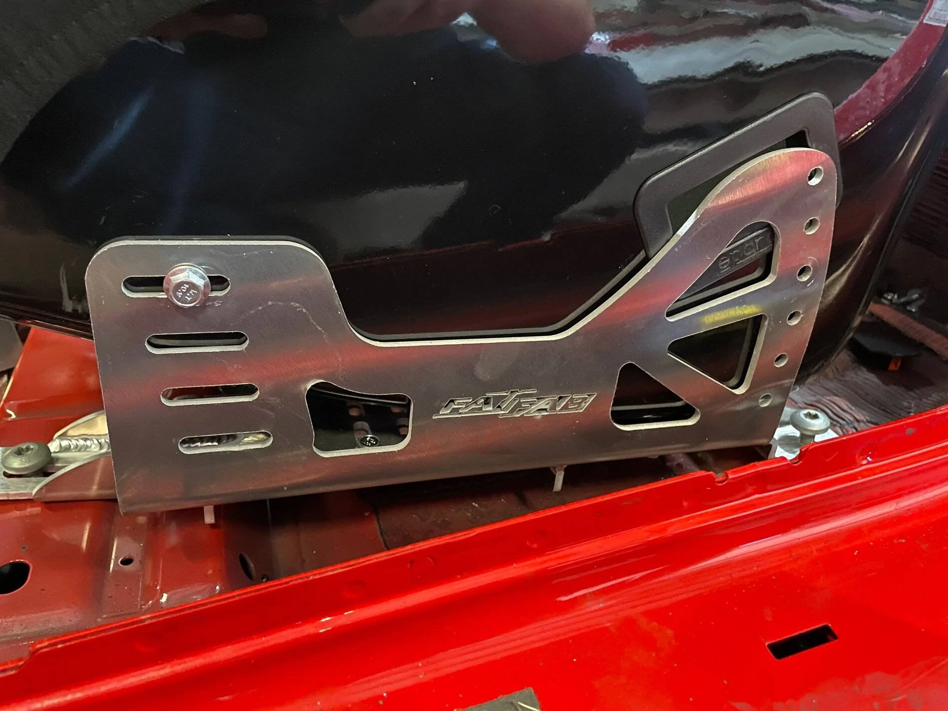

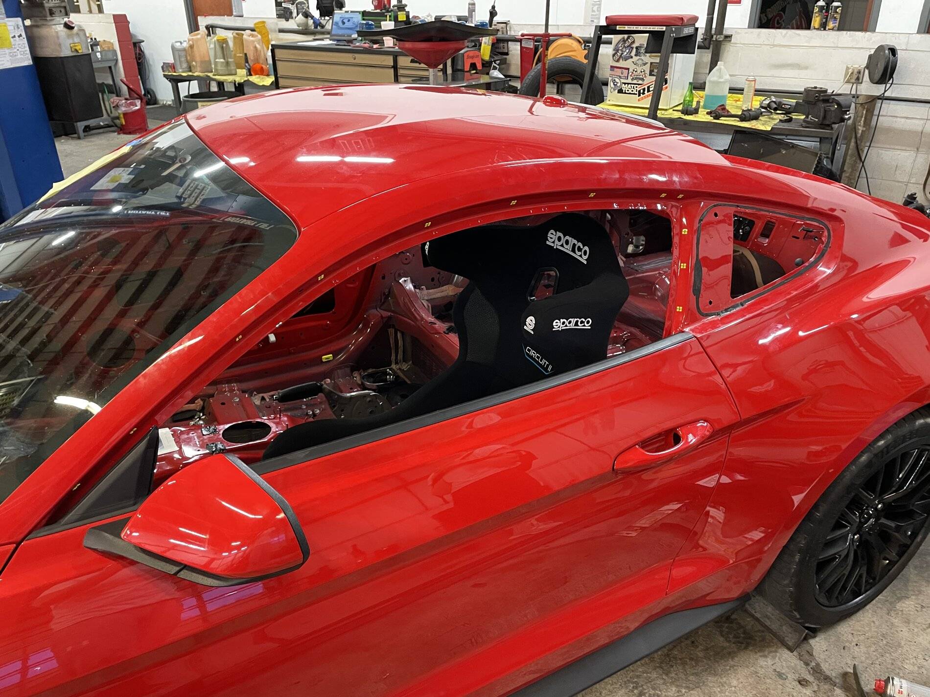

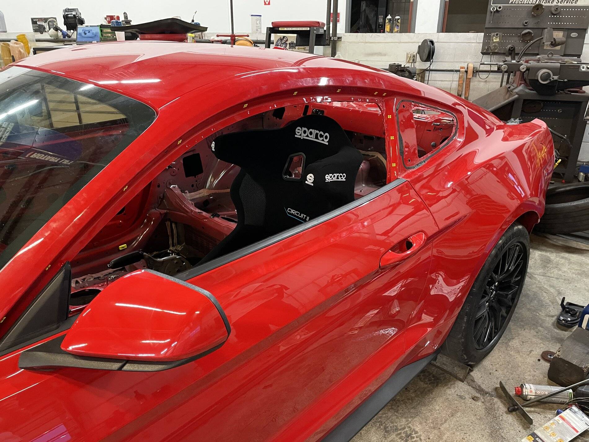

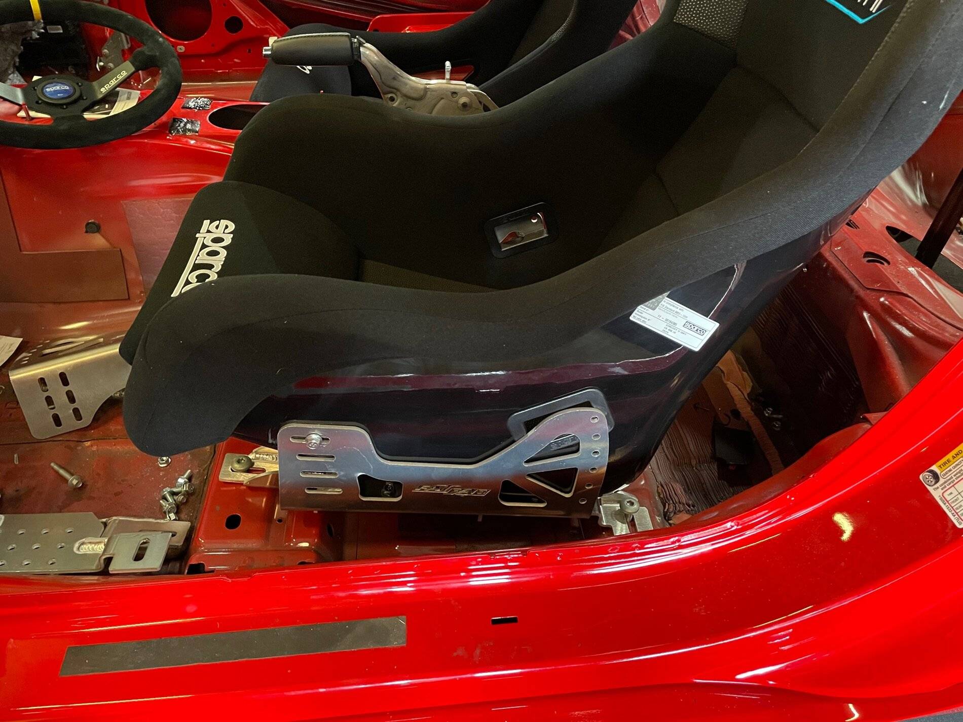

Should be installing seat mounts and sparco seats tomorrow, seat mounts came from Fathouse Fab, and I have to say they are STUPID lightweight! excited to test fit it all in.
Sikky Wilwood dual caliper kit, plus a standalone hydraulic e-brake
Some things I'm obviously forgetting, but we will get there!
Pulling motor (hopefully) tonight, so we can start building engine and doing wiring
Now, a couple of questions I have for you guys, any help would be GREATLY appreciated --
1) Removed factory steering shaft for the time being to strip it down, we are going to be using the factory Electronic power steering, buttttt- I noticed that the sensor made into the wiper stalk assembly will not allow the p/s rack to operate with it unplugged... any ideas on a bypass?
2) The coilovers supposedly are just a strut in the rear and still utilize the factory spring sitting on the control arm, has anyone seen any control arms/coilover setups that remove the factory spring setup in the rear??
3) Using factory hanress, going to de-pin and remove all wiring not neccessary, it will be a task but should make everything a bit more reliable, any tips on what to go ahead and chop out?
4) Is any other program besides HP Tuners available to remove factory VATS/PATS on the PCM? We have a Ford Dealership and access to VCM but can't seem to delete it from that side, maybe there is a bypass there as well to help with the Electric power steering deal in question 1?

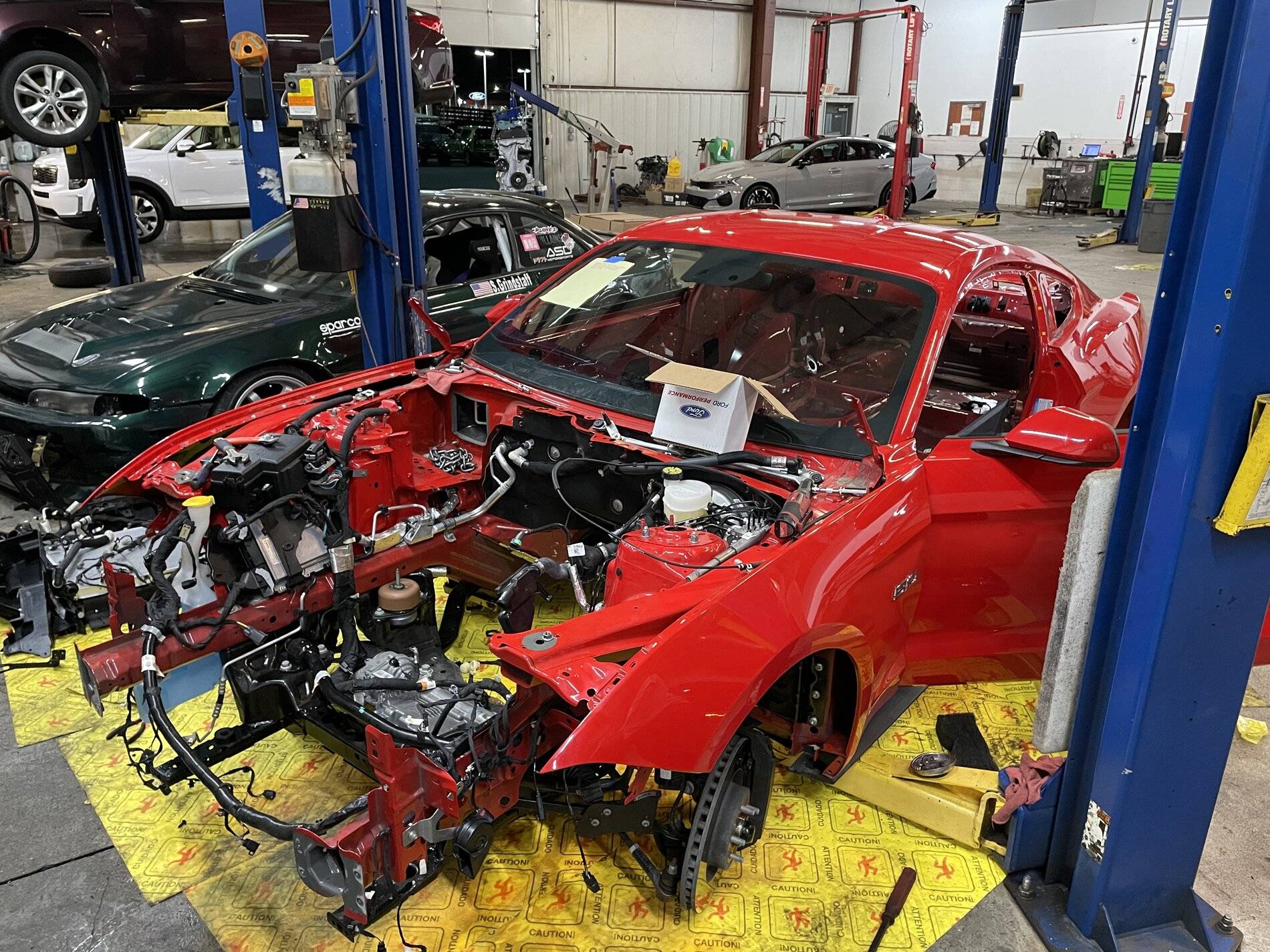

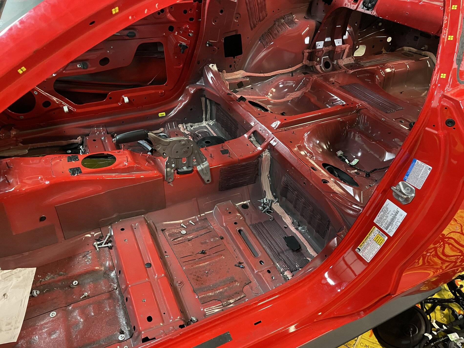

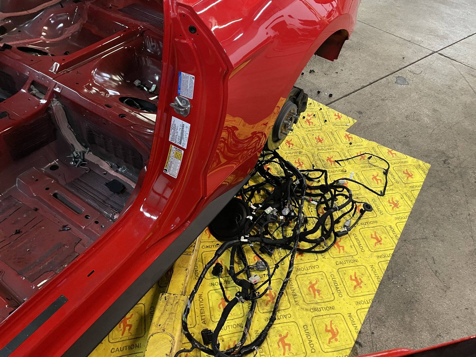

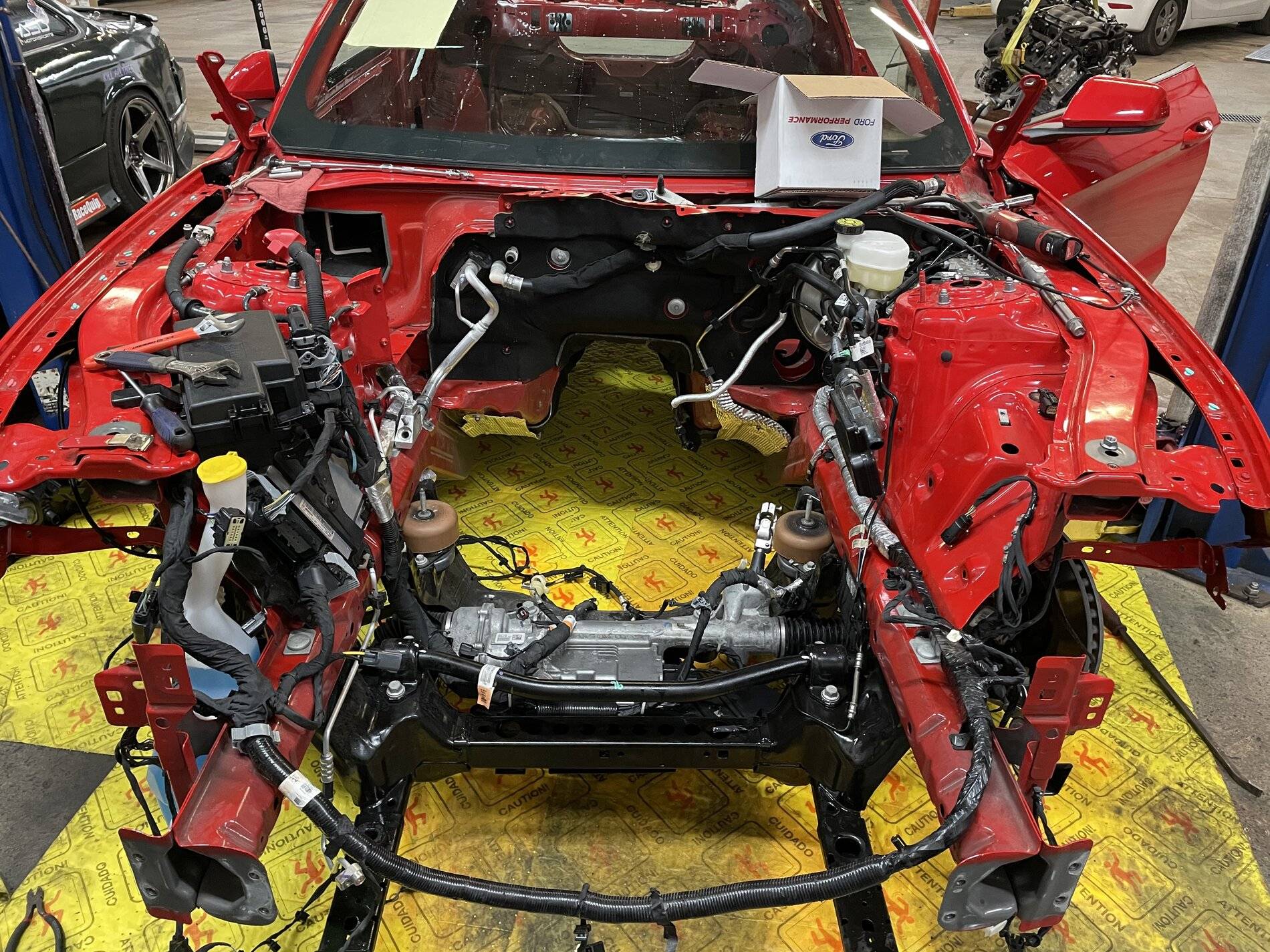

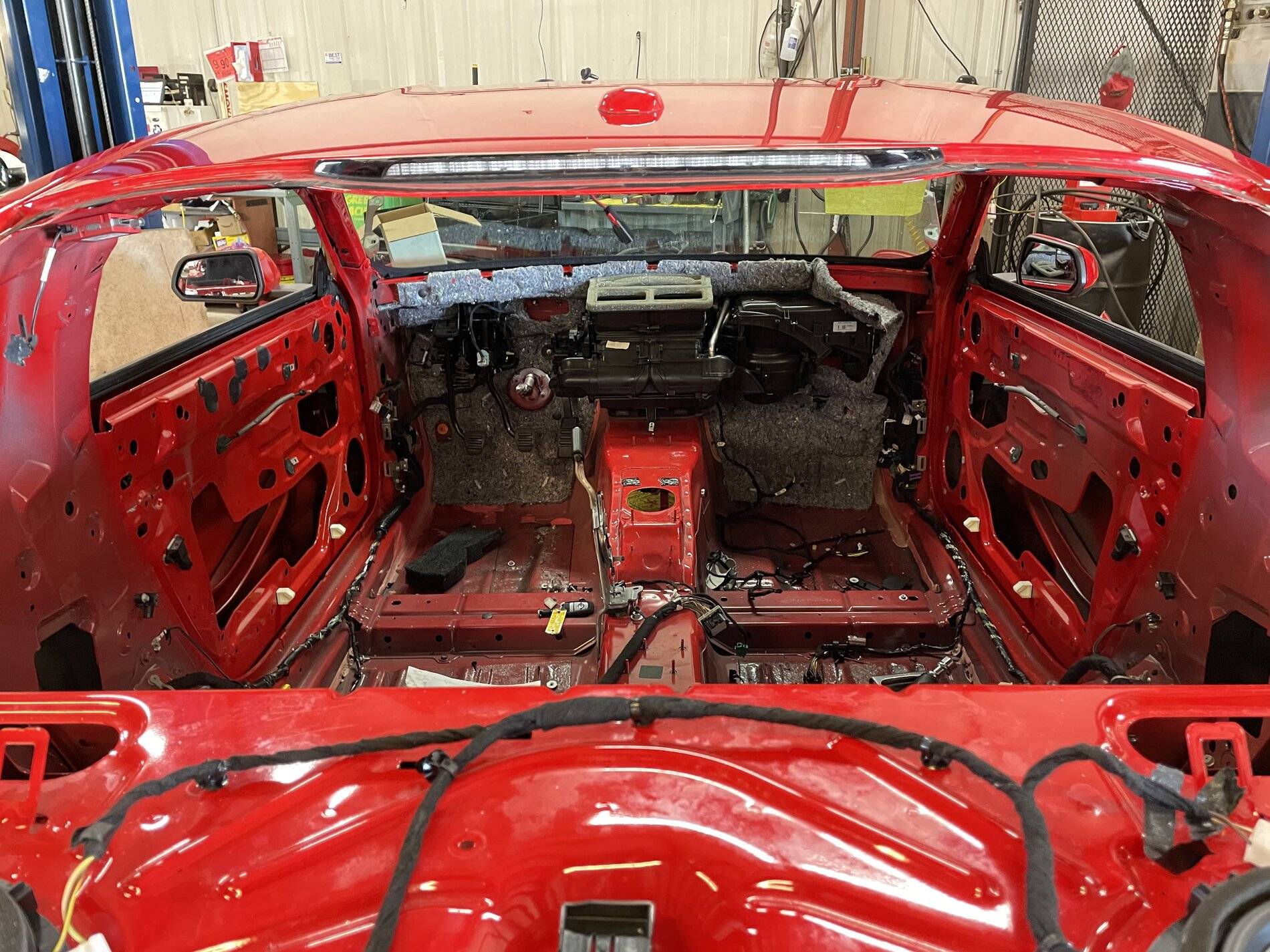

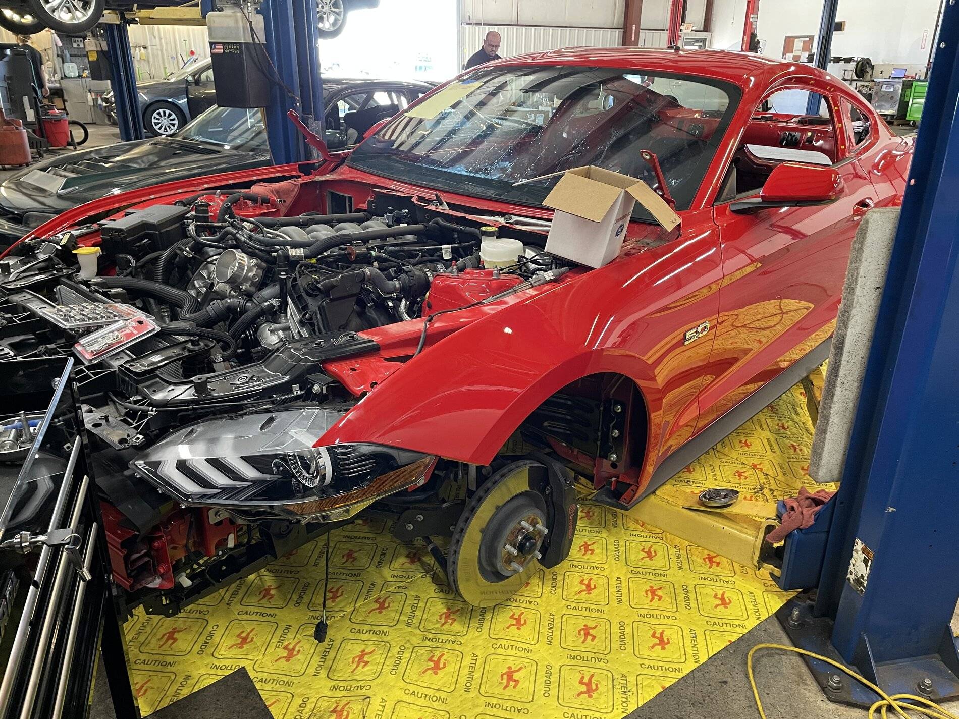

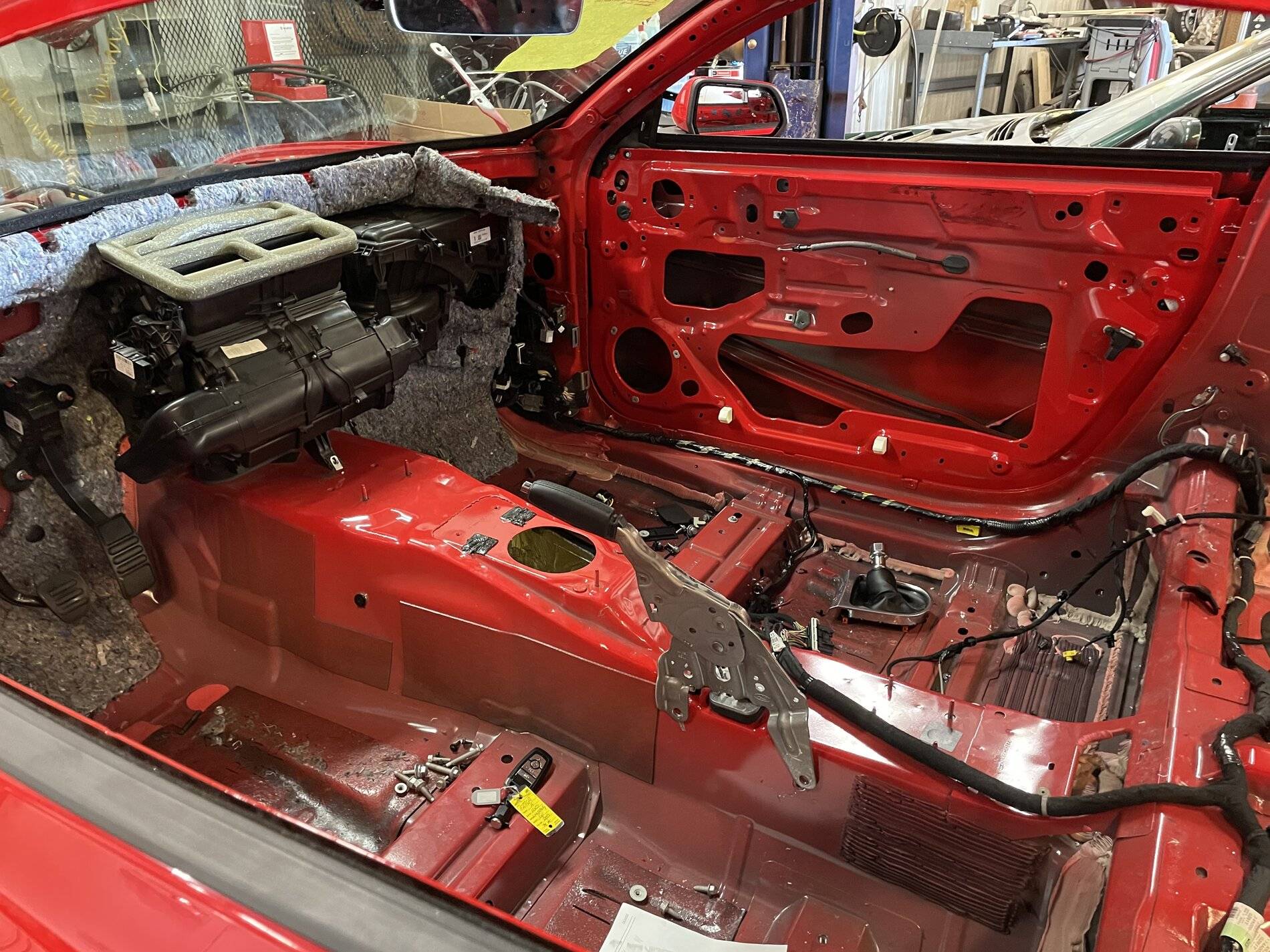

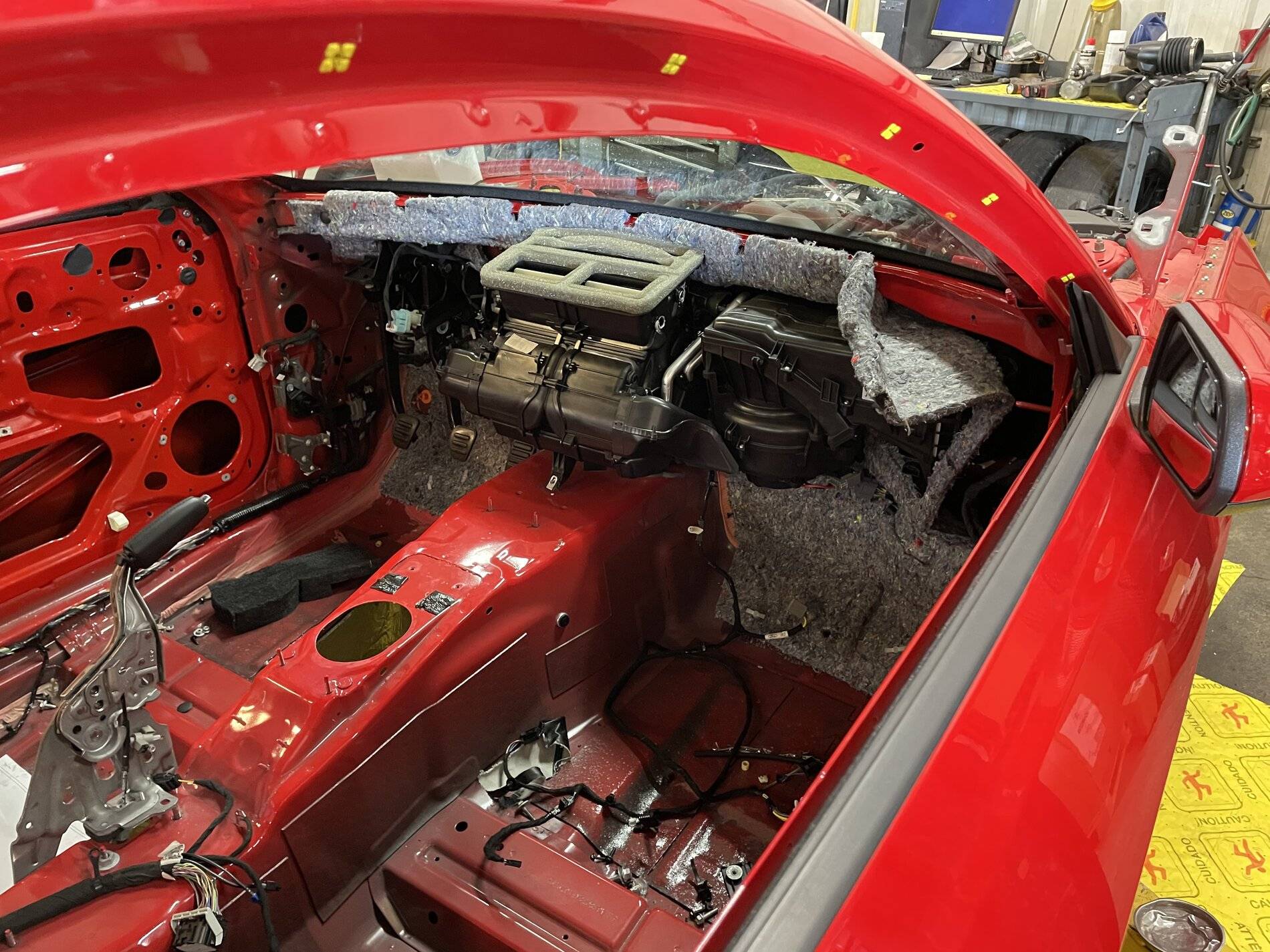

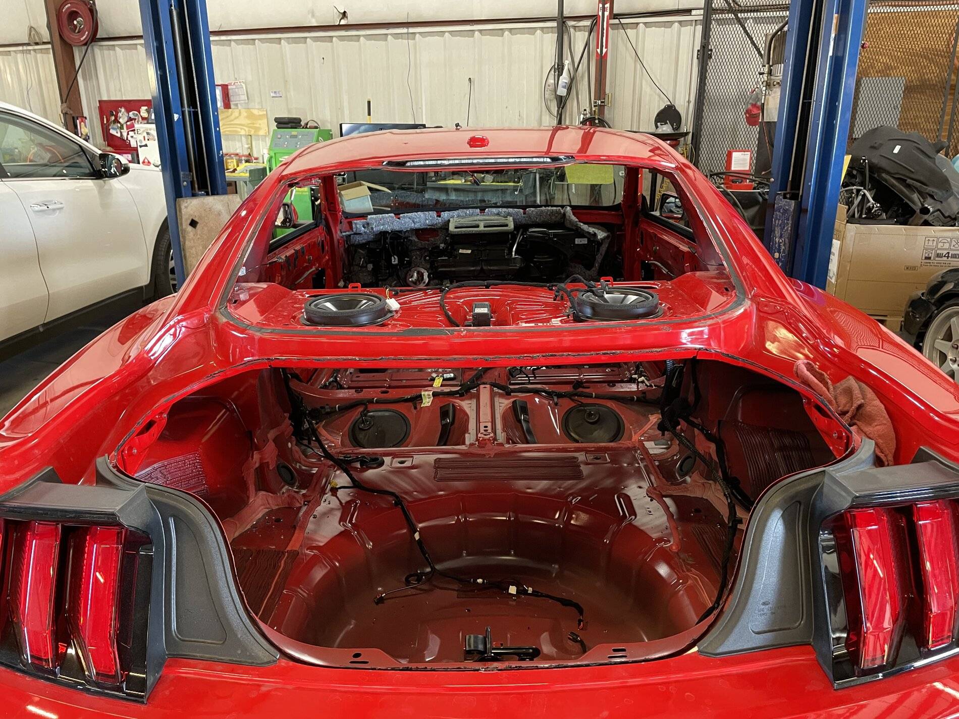

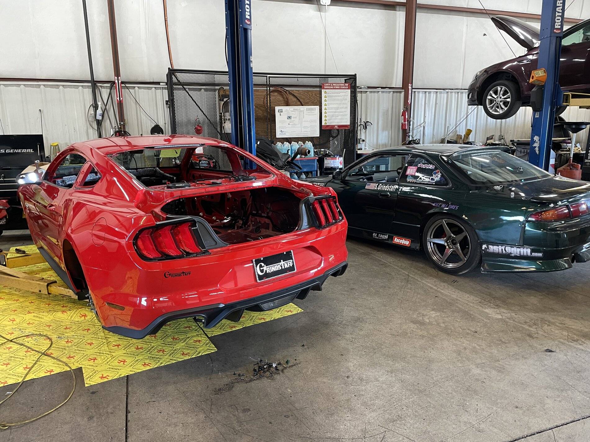

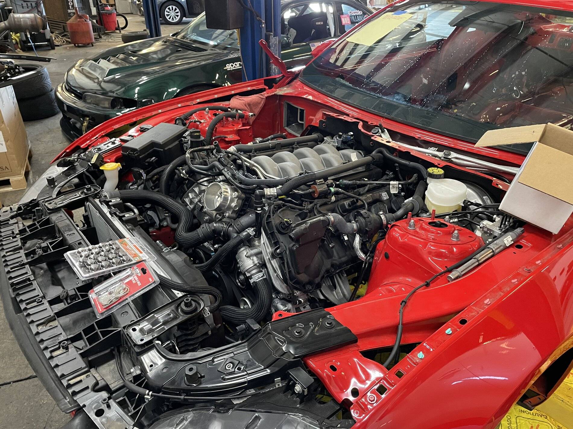

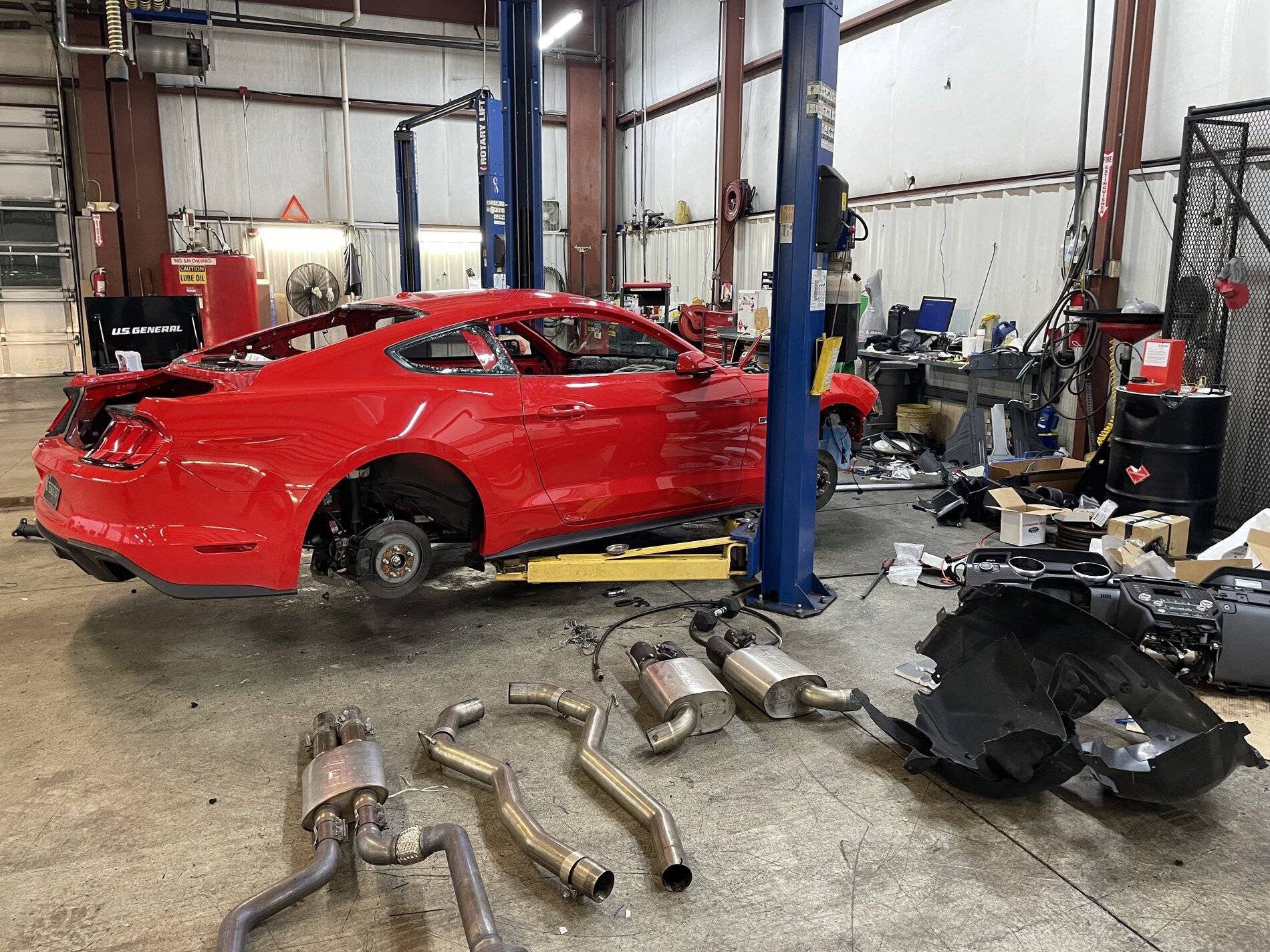

Will keep this thread updated throughout the whole build, here are some photos of current stage with car (almost) completely stripped out!

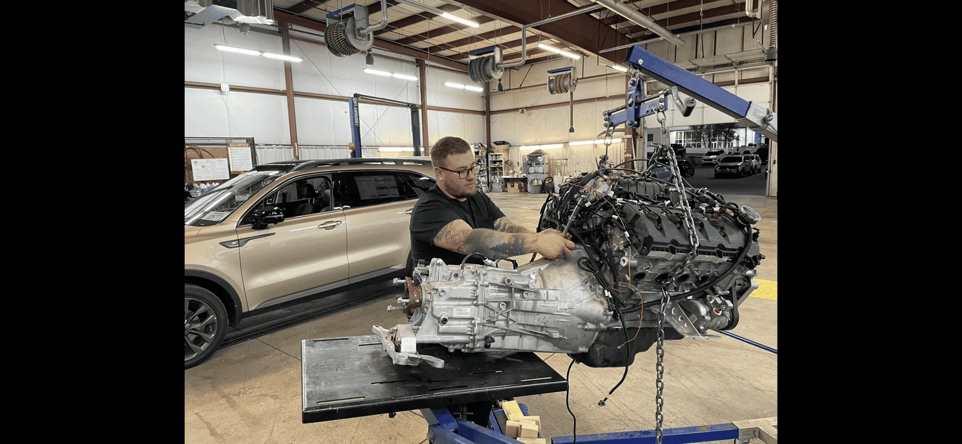

Ok so a bit more progress, and was able to find some answers to my questions thanks to some help from other mustang drifters... thanks JTP! Have engine/trans pulled, not photo’d, but all factory wiring in engine bay and crap against firewall removed. Now... big change, I am selling the gen 3 engine/trans combo, and have a gen 2 package coming. Jason @ Link ECU gave me a ton of GREAT information, really appreciated that, and told that it is basically impossible at the time to run the Gen3 coyote on a standalone, as it runs on a dual injection (direct injection and port injection) so we are swapping to a gen 2 so we just have port injection. Still staying roush supercharger, so not much has to change there, everything else ordered bolts up! Going to swap to solid mounts before we drop the engine back in. Now, for the electronic steering, and thanks to JTP for the recommendation, I have Ordered the Cortex racing standalone steering module, which will simplify this rack heavily! Sparco seats and Fathouse fab mounts are here, test fitted the driver seat today, forgot to get pics of the mounts, will update more tomorrow!

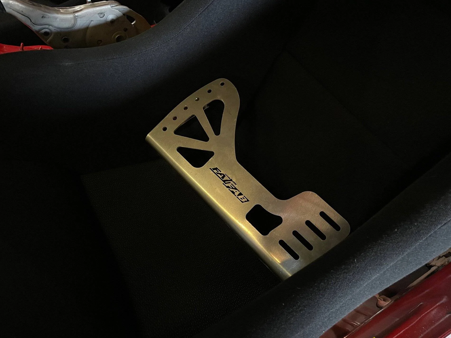

Would love to see pics of the seat mounts! Looks like this is going to be a pretty cool build
Hey Trevor, was actually just about to post an update, so perfect timing, got some photos of the brackets especially! A few parts came in, so I will share where we are currently at! As far as the FatFab mounts, they are CRAZY light! Holy cow, they are stupid light and look amazing, its a plug and play deal hit all factory mounting points and the bolts on the seats! A+++. You'll notice in the photos I have removed the rear bolts, I really prefer the back of the seat leaned back more so I sit down into the back with my legs raised slightly, so I will need to do some trimming for the harnesses to pass through the seat!

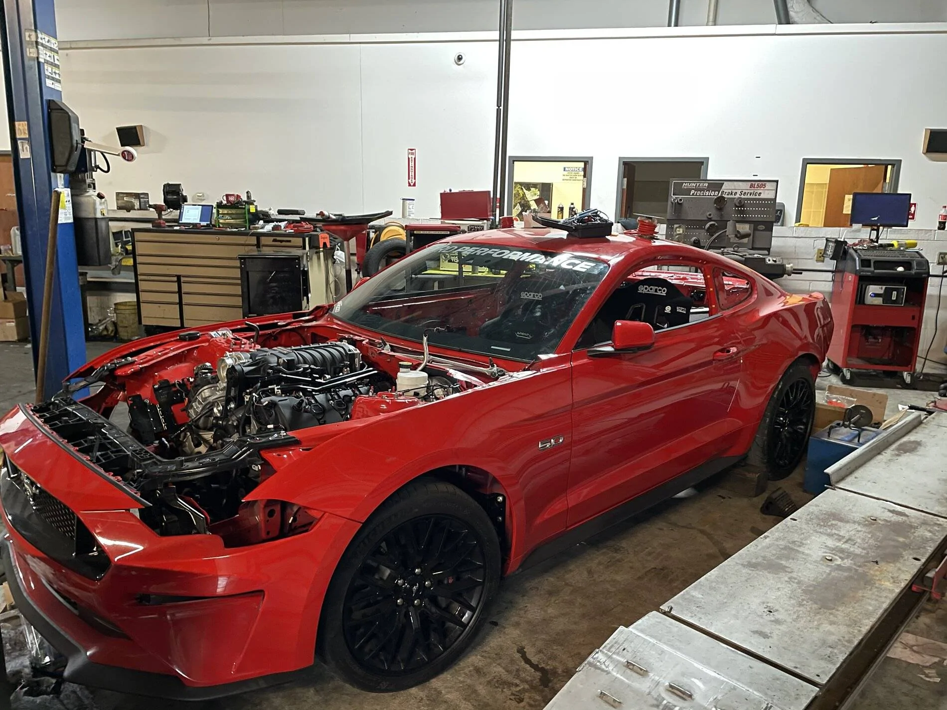

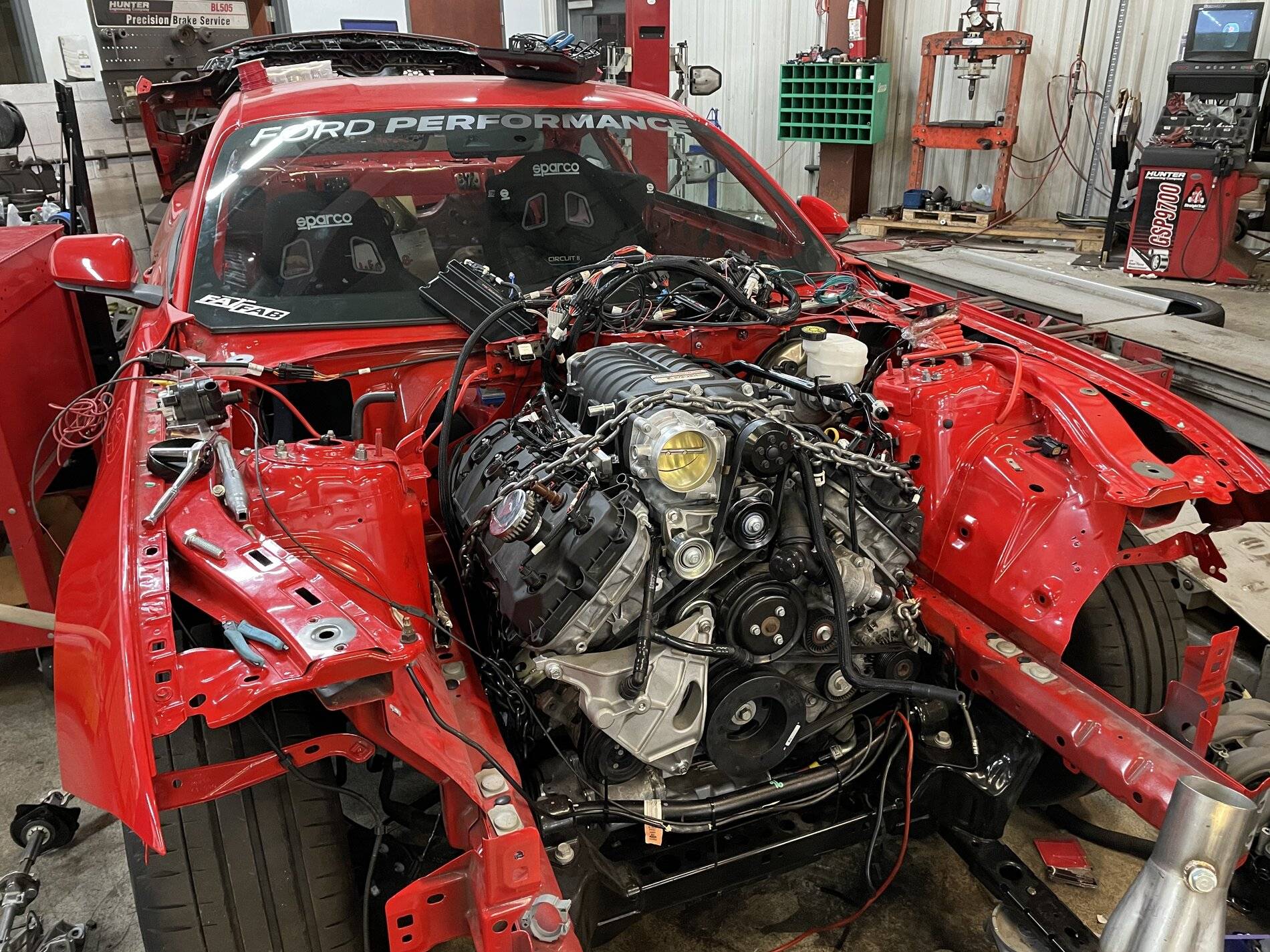

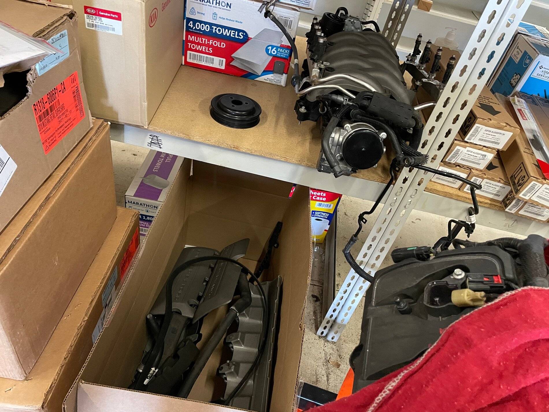

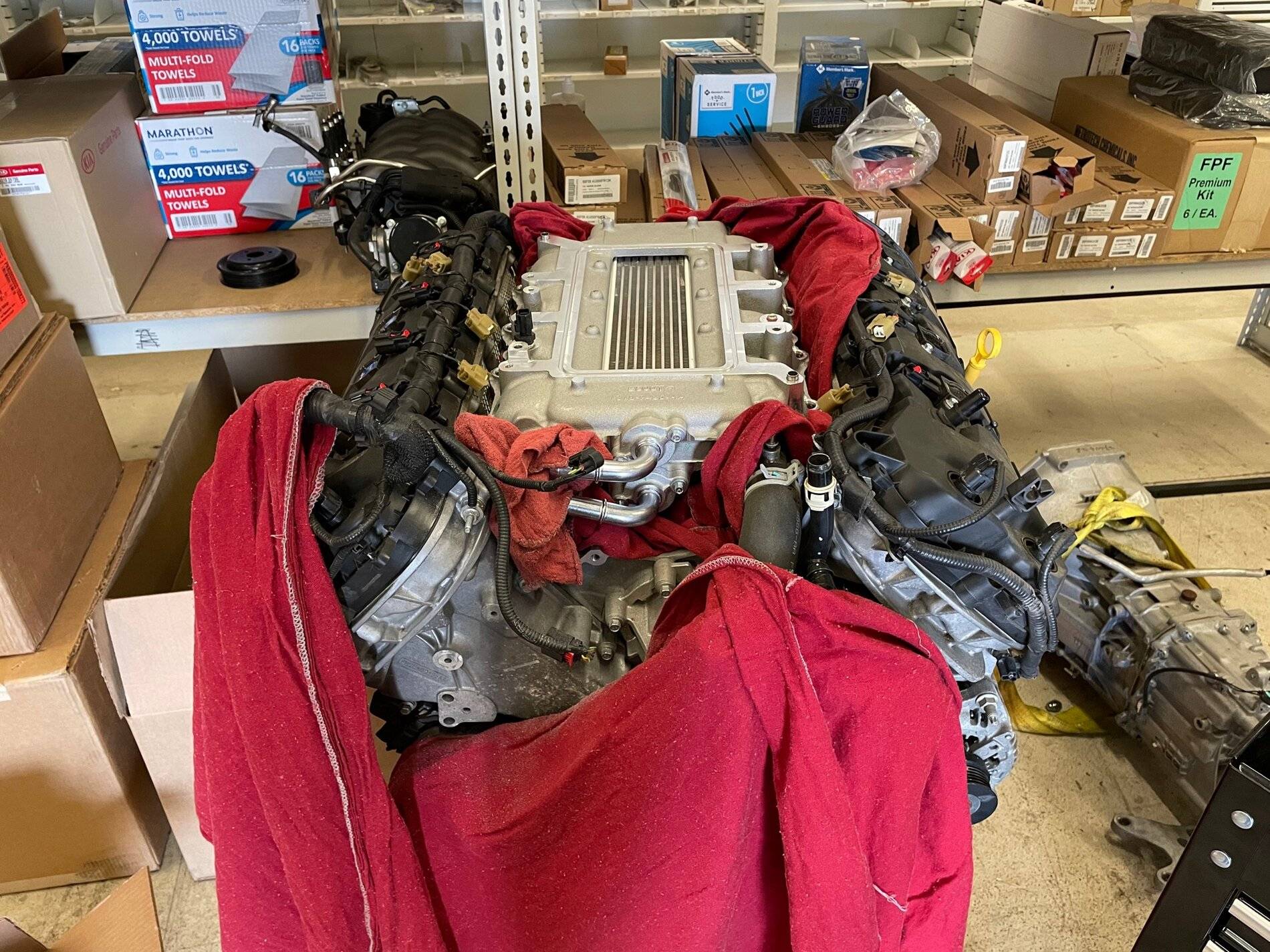

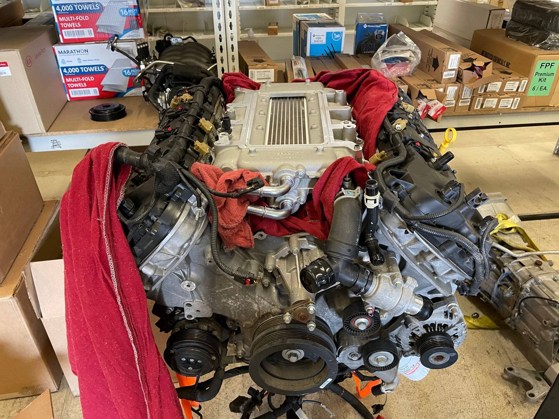

Now, the Gen 2 motor has arrived and is now on the engine stand. Since the roush supercharger had already arrived for the Gen 3 before I decided to swap to the Gen 2, we are test fitting to make sure everything works, then we will pull back apart and build motor. Going with a lot of MMR parts for the front and bottom end and valvetrain, still looking for the right cam however.
We have the Borla HQ here in East TN, it looks like they are coming on board as a sponsor and going to be doing our custom exhaust work for this build, thinking about a side exit.... Hmmm :)
Also recieved the Cortex plug and play EPAS harness, we will see how it works in the next couple of days, hopefully as simple as it looks!

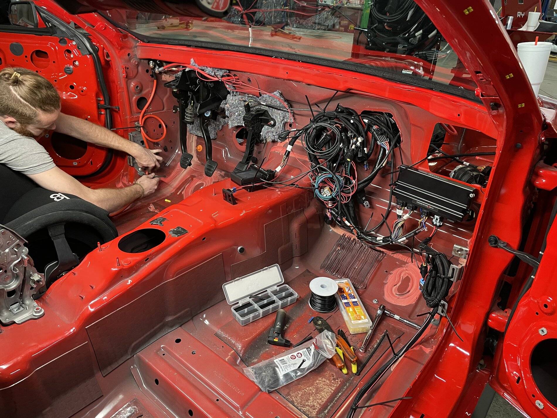

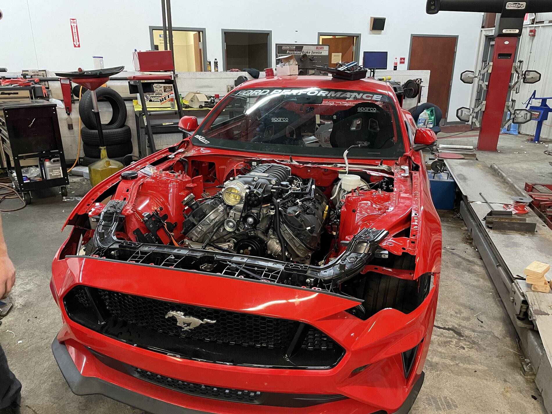

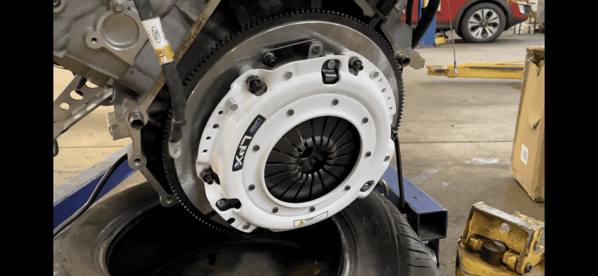

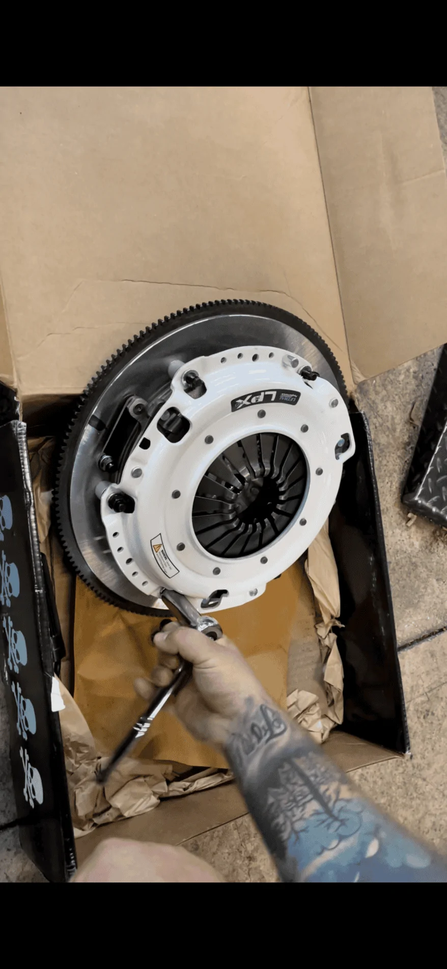

A few updates! Almost ready to go to get cage done, 1 week out now! Made a last minute decision to use Holley to run the coyote for the remainder of this year, and switch to link over this winter, using the Holley harness as a lead harness. Feal suspension and angle kit will be here this week, installed the Lethal Performance clutch, supercharger is done, transmission bolted back up, sitting in car and all wiring almost done! Tested the cortex kit on the EPAS and wow it works super easy. Plug and play! Super nice to have power steering on a switch! More updates will be coming frequently now! My buddy Kris stepped up and helped big time with the installation tonight!
