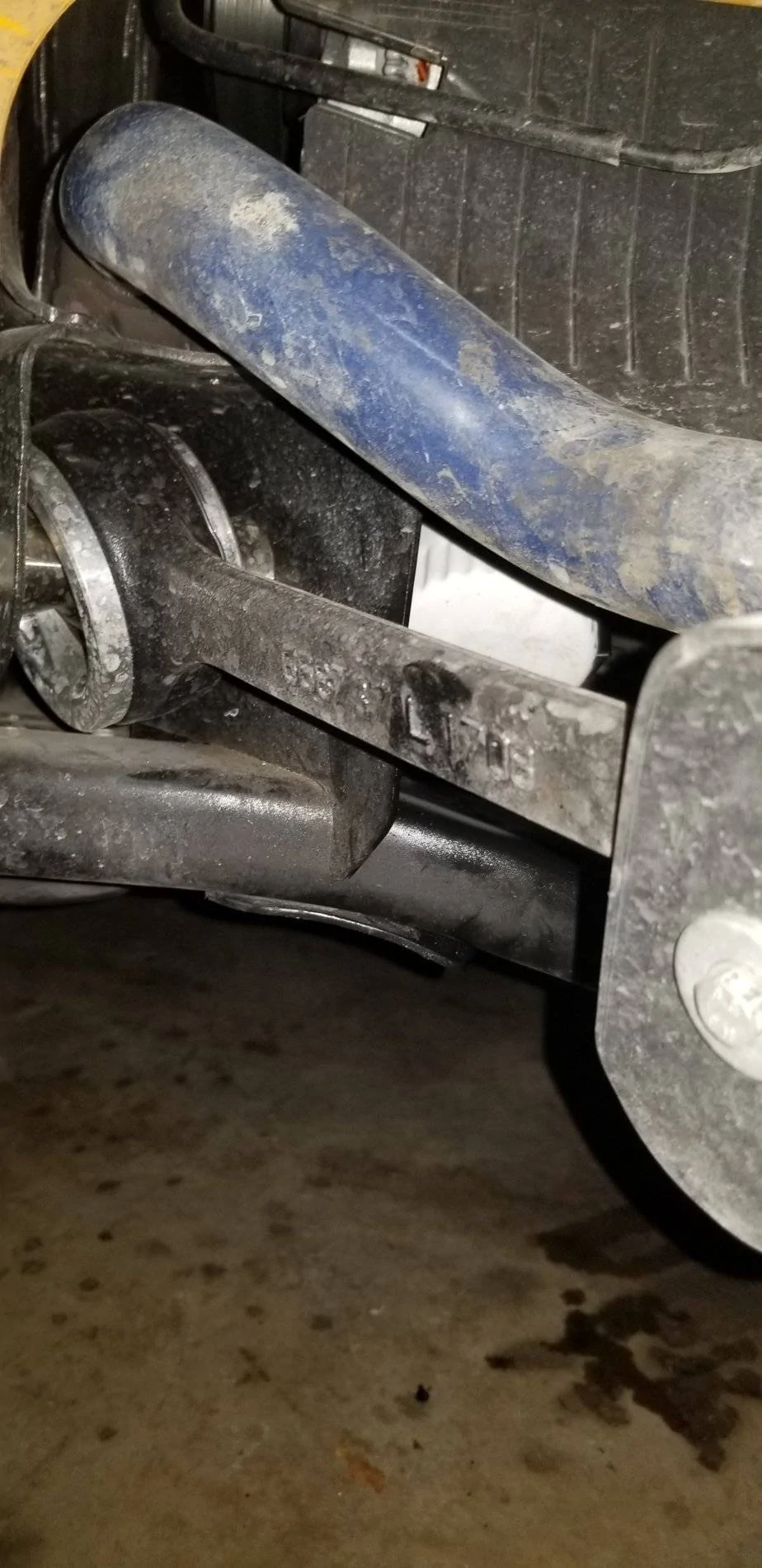

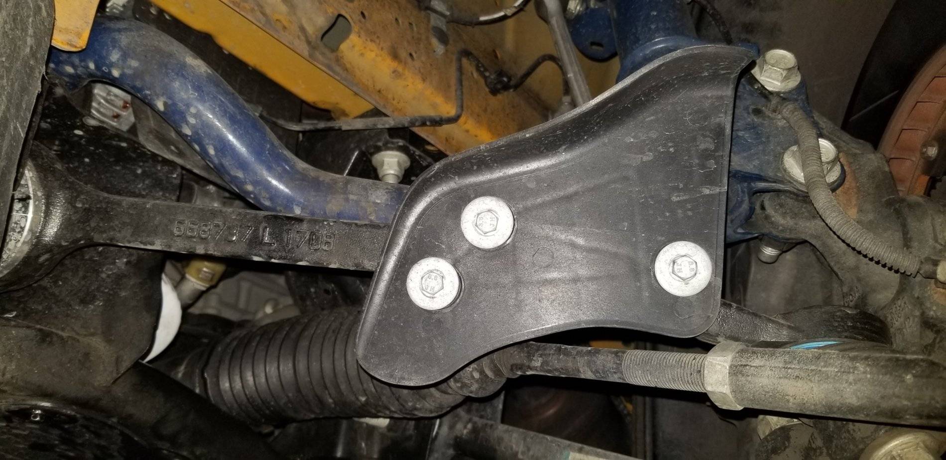

Thanks for the post. I just read through their entire build blog for the 2018. I really enjoyed it. This guy even runs at my home track MSR C. How freaking cool. Those ducting plates are for sale on their site now. 129. I may grab some. I'm running the Steeda bearing control arms instead of the stock ones so the arm kinda articulates around on the bearing. It causes the ducting plate to sit at an angle depending on how the bearing is swivled at the time, although it seems to default fully locked out in the inward position.

That's weird. I have bearings there too and mine are not cocked over like that. Did you install L on R, R on L? I ask because I mistakenly did that when I installed the roll center correction lateral arms. It's easy enough to do that you ought to check it out.
I purchased them pre assembled from Steeda. I don't think you would be able to put them on backwards because the defusers would be facing the wrong way if you did. Are they marked L and R? I can double check.
The deflectors could be installed backwards too...
The arm has some twist built-in to it for caster angle, but it's not always enough to be immediately obvious, especially if the deflectors are installed backwards.

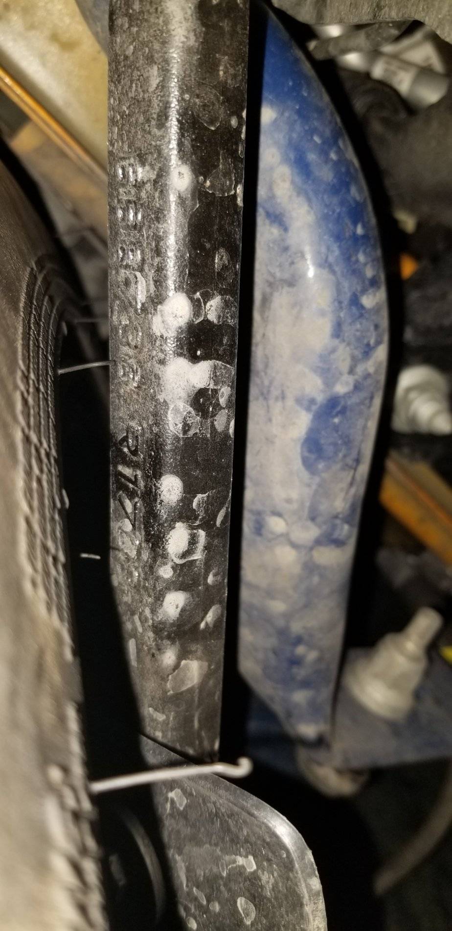

Ok yes I see the twist on the old ones but no L or R. How do u tell which one goes on L or R?
The diffusers say L and R.
Edit. NVM. The new driver side arm has an L on it. I'm assuming that's what it means.
You can see an upside down R on the passenger side. The stock ones don't have an L and R on them, but the Steeda replacements do. Strange.
