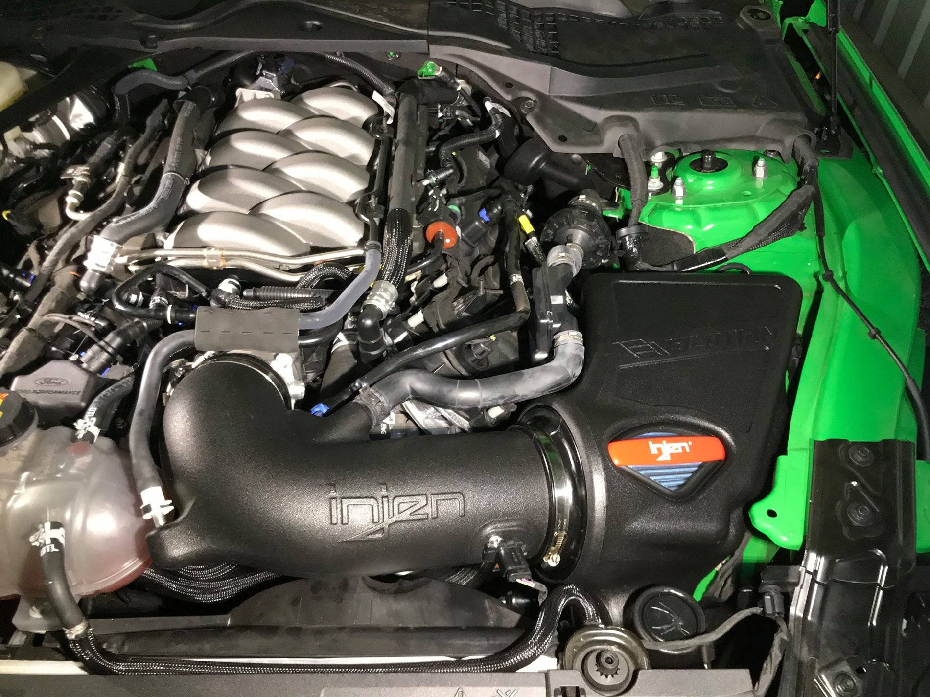

I had no problems doing the install. It all went in vey quickly. Sure the silicone inlet tube was a bit tight to get on the throttle body but I’d expect that. I just used a smear of low mix of dish detergent and water wiped around the inlet and wiggled it on.
I sent an email to Injen afterwards with some minor suggestions and photo's and they responded favorably saying that would look at them. Some of you may find it interesting.
“Hi Injen,
I just fitted my 2019 AUS delivered N4G GT with one of your CAI's. Easy job, great fit, and good instructions. Very happy with the packing and wrapping. First rate! Looking forward to trying it out tomorrow.
Two suggestions. The sound tube resonator has a clip that slots into a hole on the factory CAI to keep it in place but your does not have it. It may wobble around a bit. I’ll make one to fit on the outer housing but you may want to look at it. ( I know some take off the sound tube so make the tab removable? )

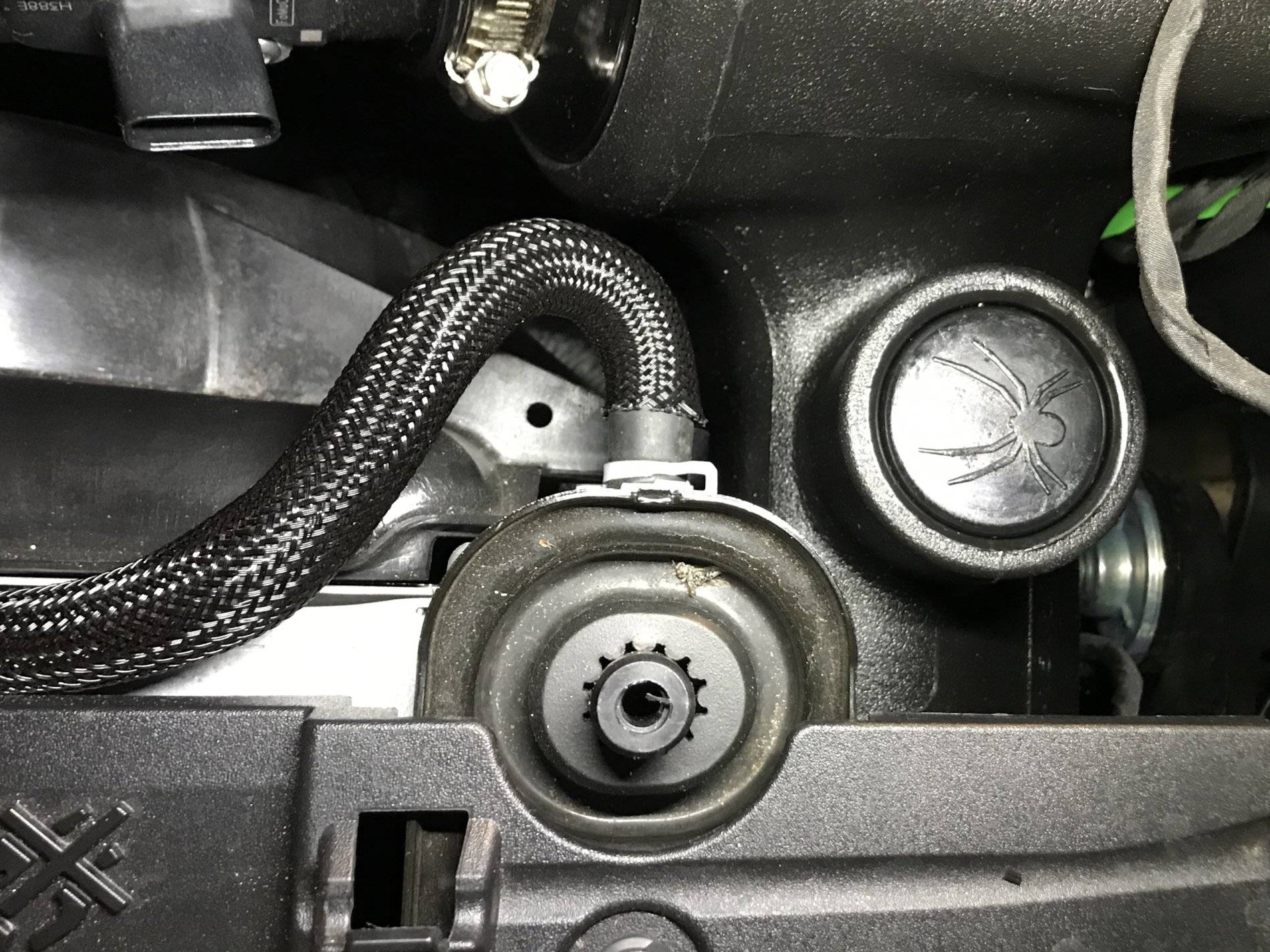

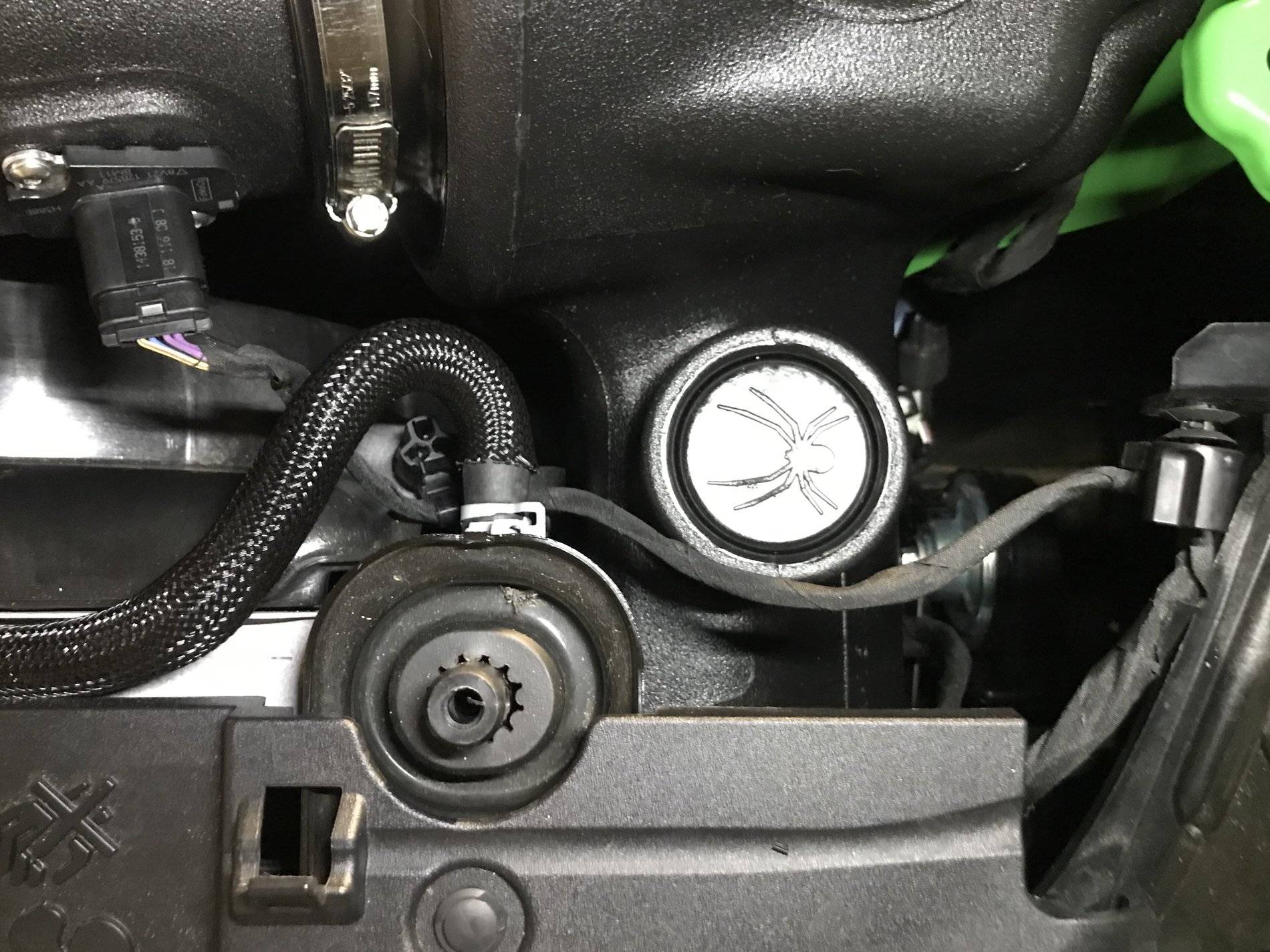

Also on the MAF sensor harness on the factory CAI the MAF harness clips onto it in a 6mm hole on the front. Without the second attachment point the MAF harness is too loose.
If you can see the pic, I looked around for a good spot for a new 6mm hole and found it on one of the plastic fins on the fan cover. It’s a strong spot and if you come in from the rear edge there is plenty of “meat” in the fin not to add any undue pressure. Also if you keep it to the left a bit (looking from the front) it is clear of interfering with the shroud bolt access to the right of it about 2-2.5 CM away. The existing MAF harness clip that attached to the OEM CAI slot rights in the new hole and keeps the harness from slapping around without it being too tight or stretched.
Pic of the hole location with and without the harness locator plug installed.

It’s definitely a different feel and sound. Throttle response is different/crisper as some of you have noticed. Butt dynos are always very subjective so who can say. Not too sure if I’ve noticed the induction noise increase by a lot, but my hearing isn’t that good. Perhaps it’s blended into the existing symphony of sounds that I so enjoy from this car. I replaced the wheels and tyres at the same time and lost sprung weight too. It definitely feels like it spins up faster. How much each change makes again is subjective for me. I’m happy with the look, fit, and feel. I’ll add some Kooks or ARH high cell count cat (green) headers (no tune required) and that’s the best I can do for the NA performance for a few years. (I too won’t be looking at an aftermarket tune until the warranty expires)

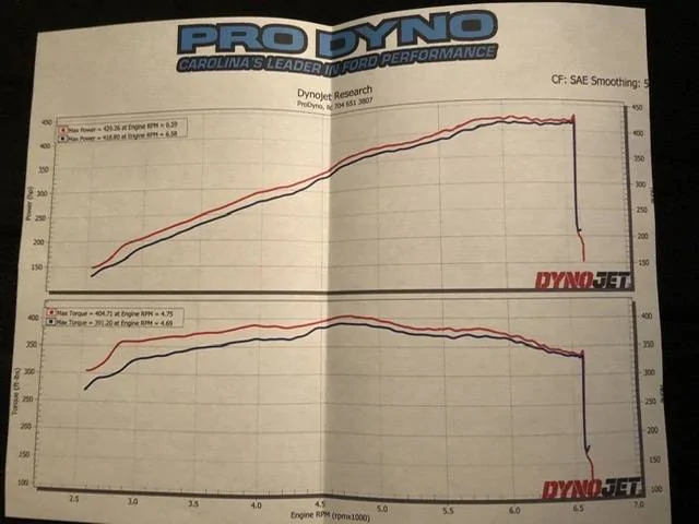

The plug is a pain to get to if you leave it fastened down(found this out at the dyno). I removed the mounting tabs and laid it down where it normally is and just pull it out the front when needed. I talked to Lund about tuning with the injen and he said it wouldn’t matter because the maf housing and counts would be like stock(don’t quote me on that)
I just ordered a flex tune from Lund just waiting on its arrival.
the dyno attached is stock with a drop in aem filter vs injen and Xpipe. The top of the run had signal interference. Dyno operator was having a hard time getting a reading so the motor was probably a little warm due to multiple tries

Cool! Looks like sold gain in torque too. I have a modified stock box with 88mm ported Tb on E85 tune. Car rips. I may just go with Steeda’s 101mm closed box setup instead though.

Wow great job, thanks for the info. I wonder how much of that gain is from the x pipe, or did it already have the x pipe installed before the Injen? Thanks
