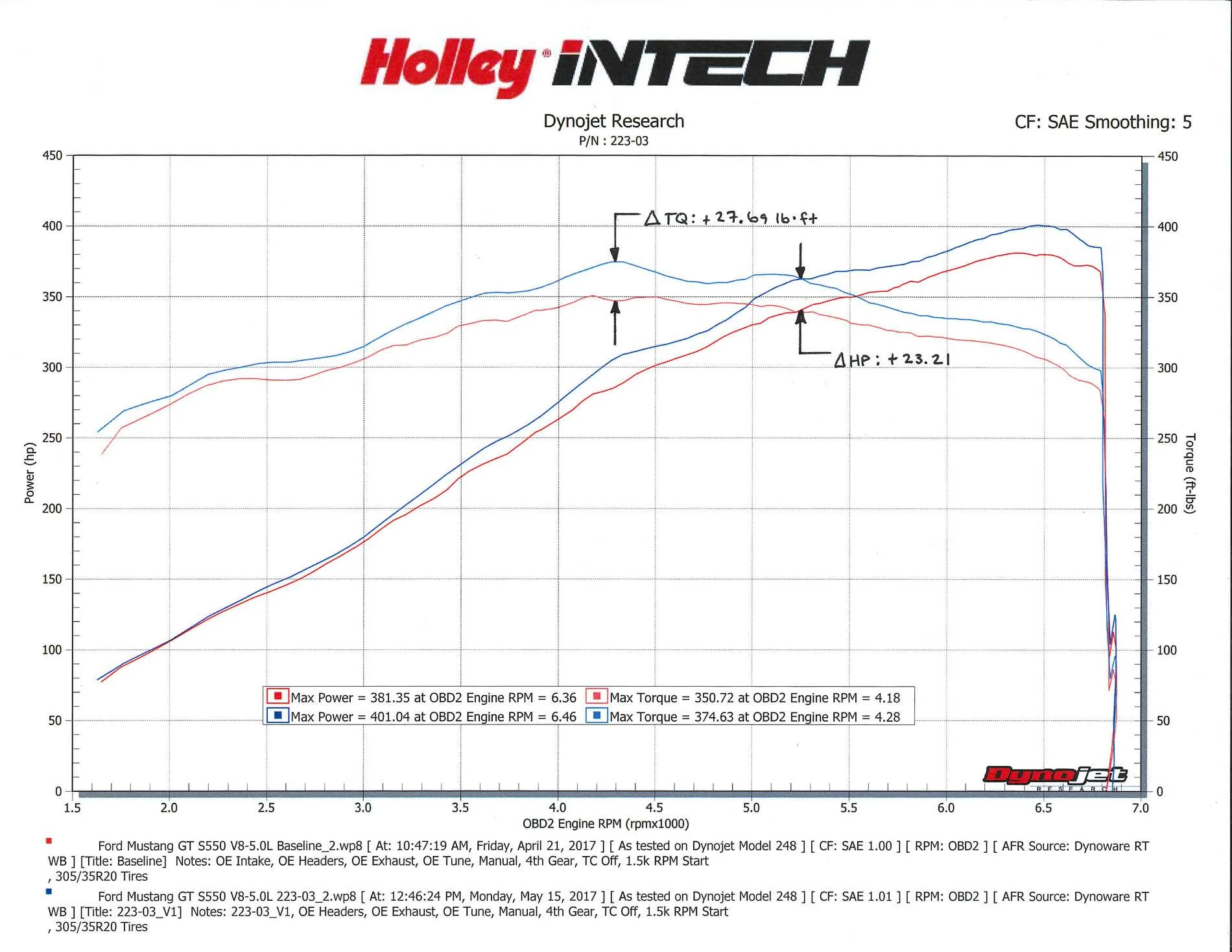

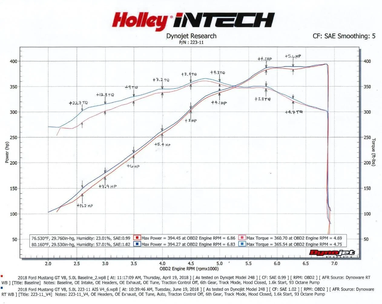

Anybody have more data or reviews on the Injen Evolution or Holley Intech? Curious to see if anyone has disproved their HP / torque gain claims. Holley published a dyno chart that shows only minimal 2018+ peak HP and torque gains, but does show +22 torque around 2600 rpm, right where the car needs it. The gains on 2015-2017's are predictably better.

Ive got the Holley Injen in my 15 and noticed immediate improvements with the on board track timers. still hasn't been tuned or made the dyno. id say it made a definite difference for my car
