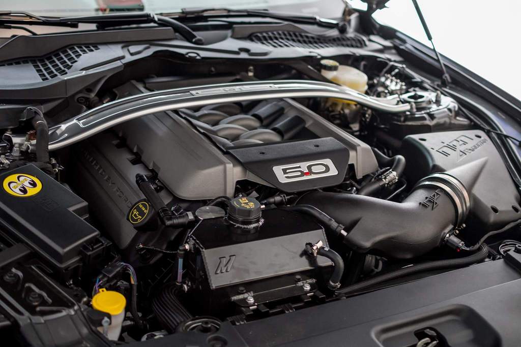

I have my Injen for some time. I cutted the insert, ( see pic) and lund tune it. Notice that the ID is 106mm which very similar to Steedas.
I mainly did it because of the high IAT's with the Steeda, in our hot climate.
I also wrapped with heat insulation, and measure the difference, between the outside of the box, (header side), and the temp inside the box. because it was done with a hair dryer only went up to 175F...see pics...
finish product....
If I let it idle for 20 mins, it will go up maybe 120F, but normally I dont see more that 10F more that ambient.....
Again this a concern for guys in FL, TX, and warmer climates on the south....

What is the part you are cutting?
redtrack
Oct 12, 2014
272
137
P.R.
2018 GT PP1 10AT
Look at the first pic, that the cross section of the MAF sensor. When you ct about 1/8", releases the insert and change from 86mm to 106mm ID.
Doing this requires a tune.
