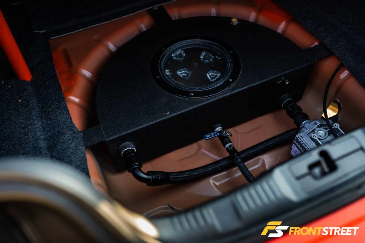

It has some amazing pictures of Engine Containment/Aero under the car done by Rogue Racecars

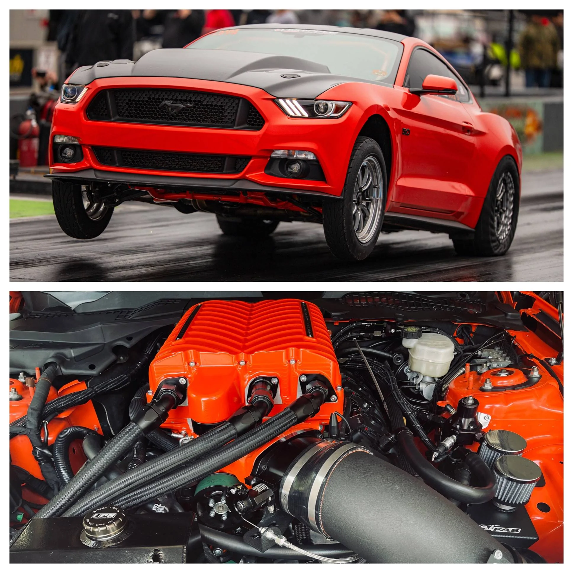

Whipple 3.8L Blower
Bear Block that contains Callies Billet rods and Billet Winberg Crank

Fore Fuel system w triple pumps, ID 2600 injectors

Tig Vision Tank and EMP Pump, 1" Lines
