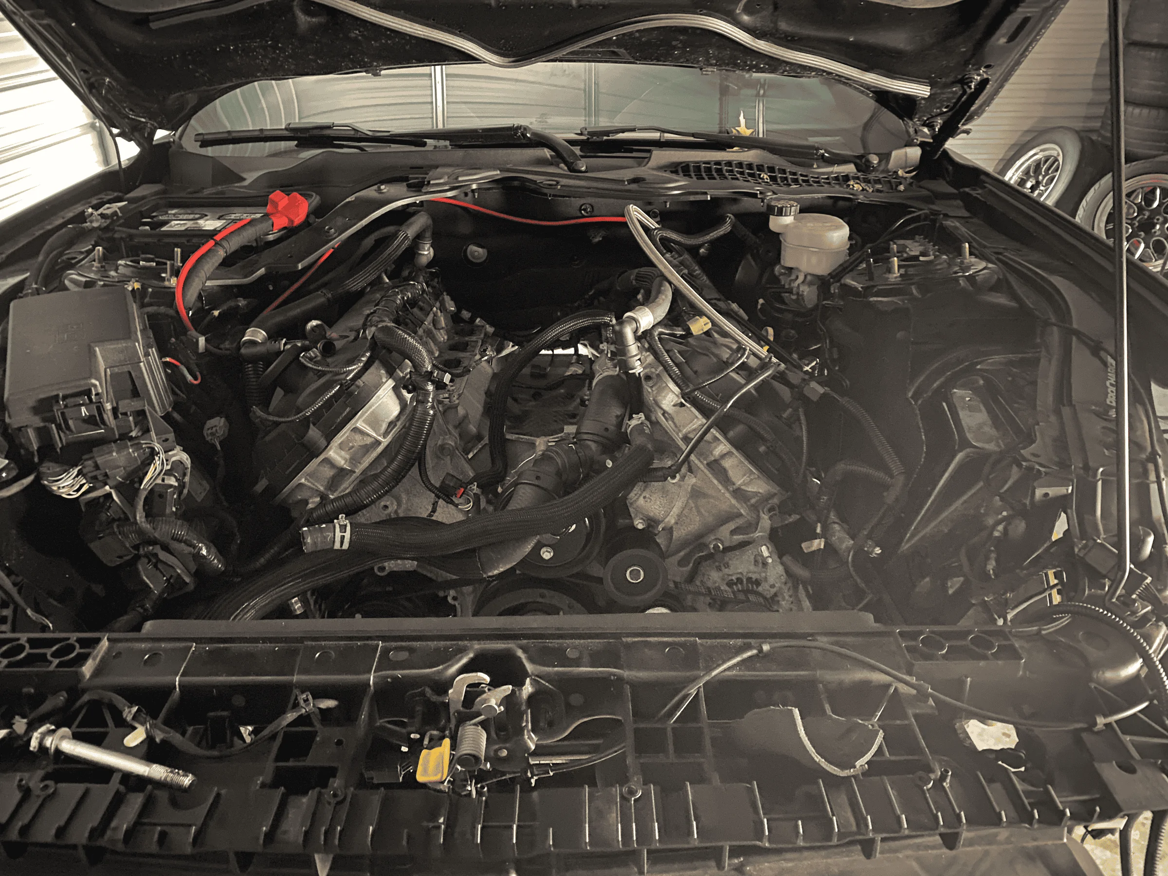

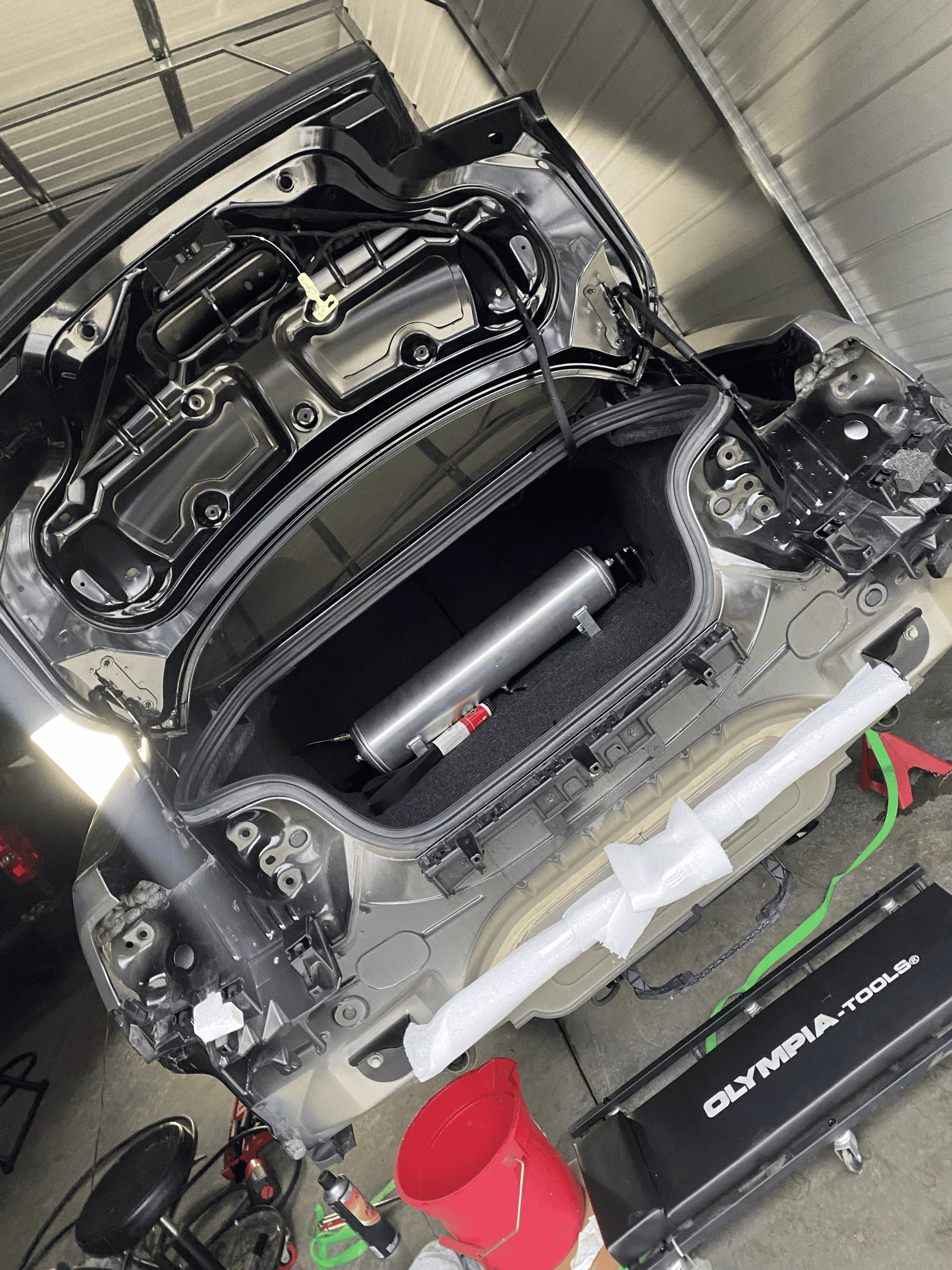

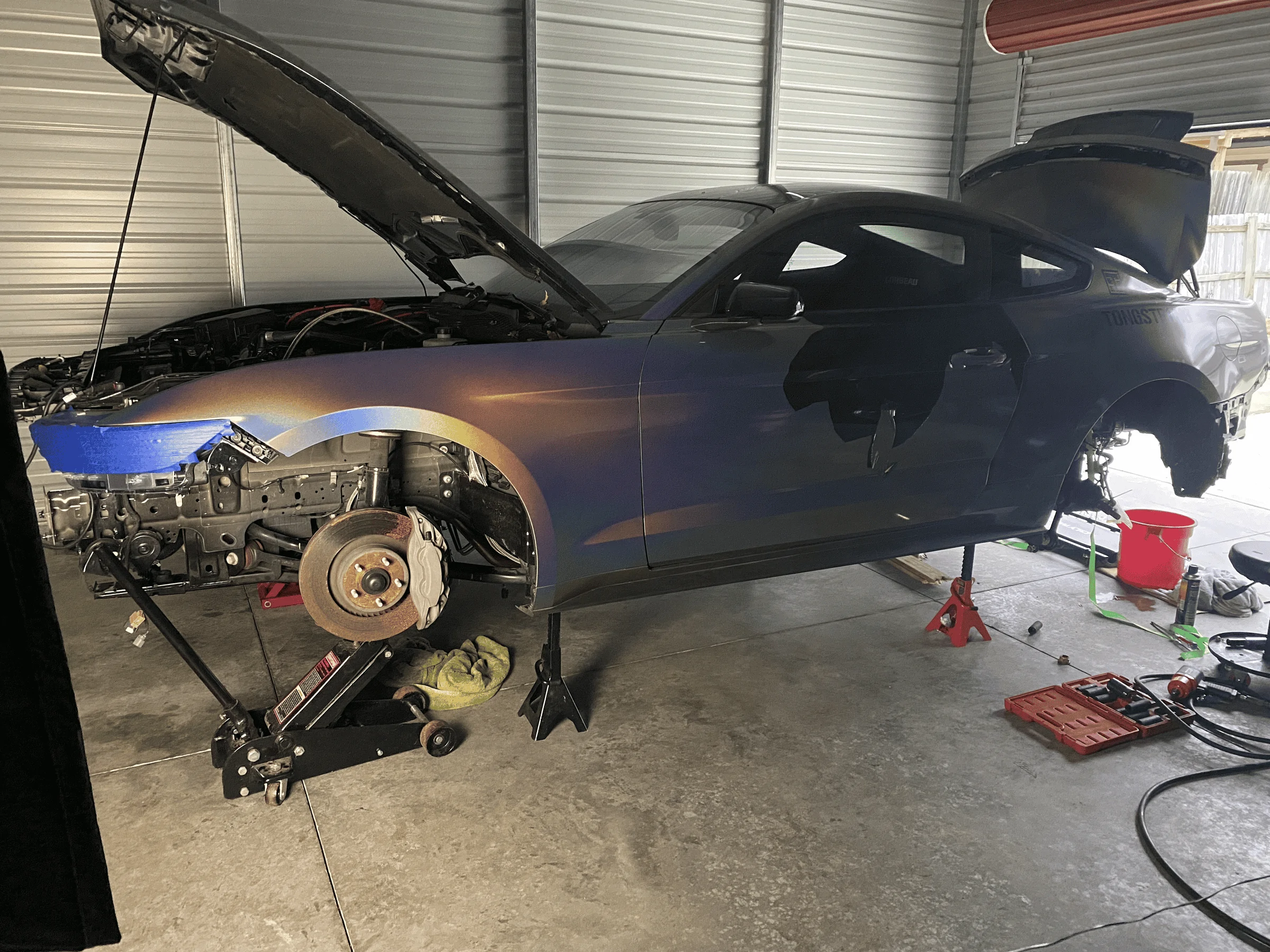

This will be an ongoing build thread. In 2017 I bought my S550 new. The intention was never to go to extremes with the car, just to build it into a nice weekend car that had some balls. Now with some recent health issues that have left me unable to pursue my previous main hobby, and having owned "quick" cars and some exotics, I've never had something that genuinely scared me.... so, now's the time. Previously the car was Procharged on e85 and made about 700wheel on the largest pulley.
I also want to utilize this build to expand my skillset with this stuff. I'm by far and away not a newb, but there's plenty I know I'll learn during this process. Luckily, I'll have my buddy Chris Walton of Rockford Speed helping me out when needed.
The generalized plan of attack is a stock head minus valve springs+retainers (potentially valves), triple pump fuel system with a BAP due to the fact I already have most the setup, TH400, 9 inch rear end, built bottom end (3.7 bore pistons/rod/crank/sleeves), air to water intercooler setup, bigger single turbo and a little bit of nitrous off the hit to get things spooled. Haltech elite 2500 will handle engine management.
I do have an odd way in which I'd like to challenge myself however...I was to run that 7 on the air suspension that was previously installed. I forsee this as being the biggest aspect to wrap my head around in order to get the car to launch...there's not a ton out there to work with.
I've already started ordering parts and begun tearing the car down. So far on order/already in:

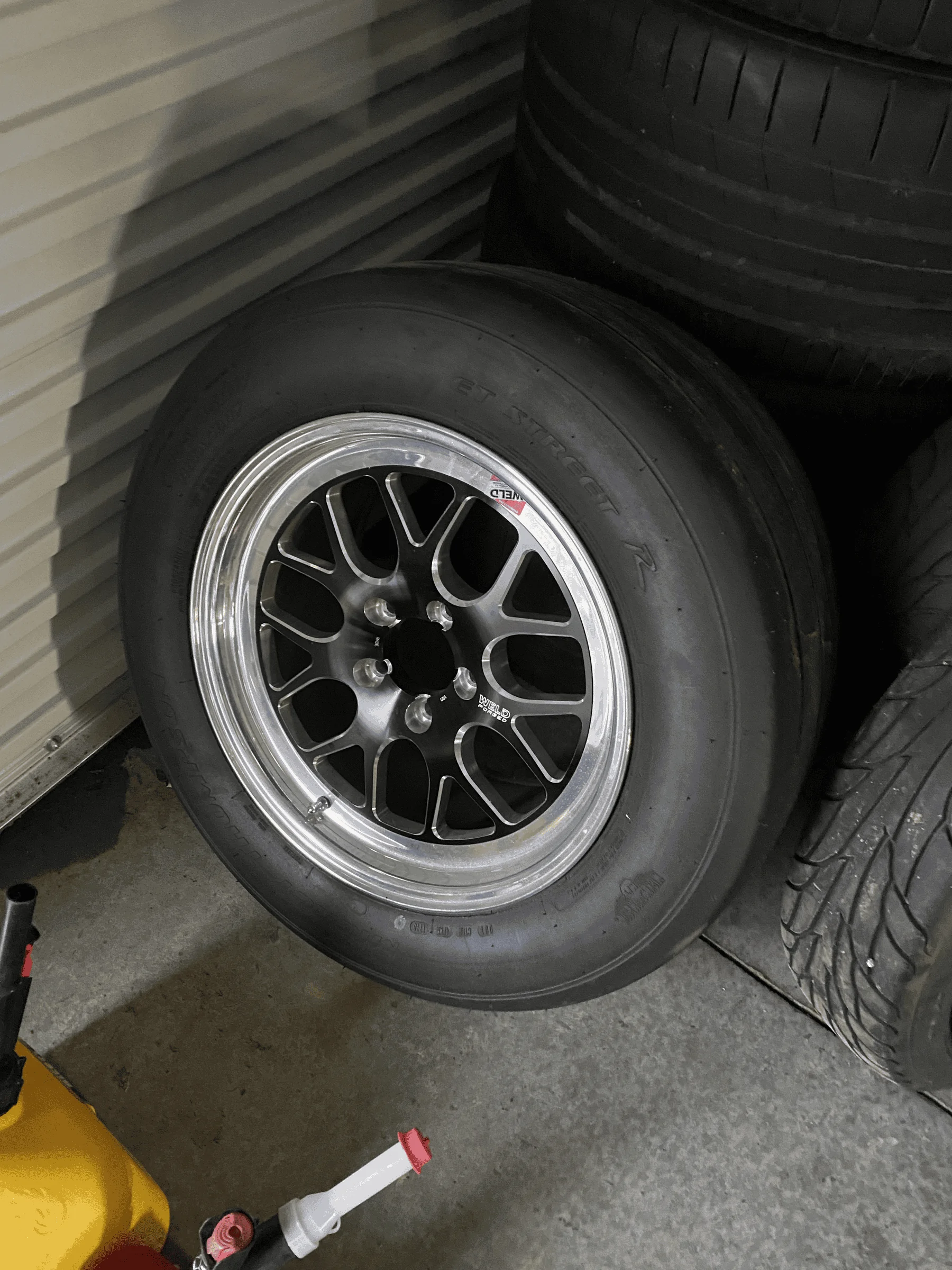

Also..hence the picture of my current welds...I'll have a lot of stuff for sale during this build so if anyone wants to shoot me a line:
17*10 Welds with 305 MT ET street R's....80% life

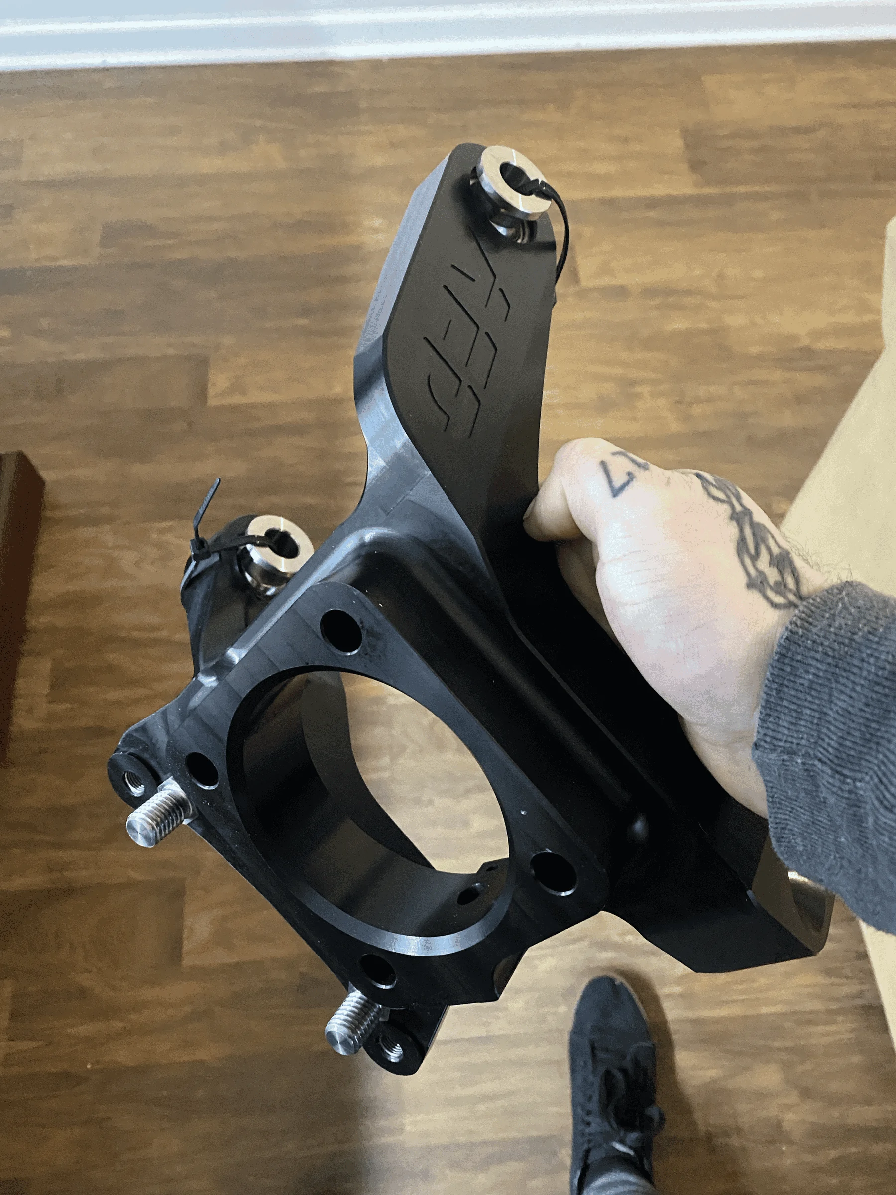

If anyone has thought about running the AED knuckles...I know they're expensive but they are damn sure beautiful. They weighed out to about -10lbs lighter than stock each.
def nice pieces :)

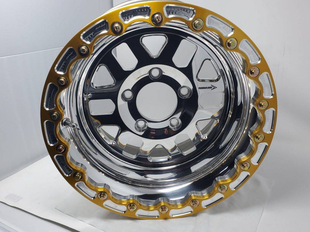

Went ahead and finalized the order with Bogart Wheels today. I'll be going with this style (eliminator) in a 15x11.5 beadlock with additional bolts on the hub face...gloss black beadlock ring and barrel and satin black center. Same setup for the 17x4.5 minus the beadlock in the front. They aren't cheap but if you want something absolutely specific, they took all the time on the phone we needed to get everything squared away.

Not only will your Hot Rod be fast , but it will look good going fast and sitting still. Those are some gorgeous wheels.
Thanks man, Bogart has been great so far to deal with and I like that I'm going through a "smaller" company.
I have a whole new look for the car envisioned. I'm tempted to call them back and have them machine out the scallops in the beadlocks instead of it being ALL gloss black, but I'll sit on it a few days.
