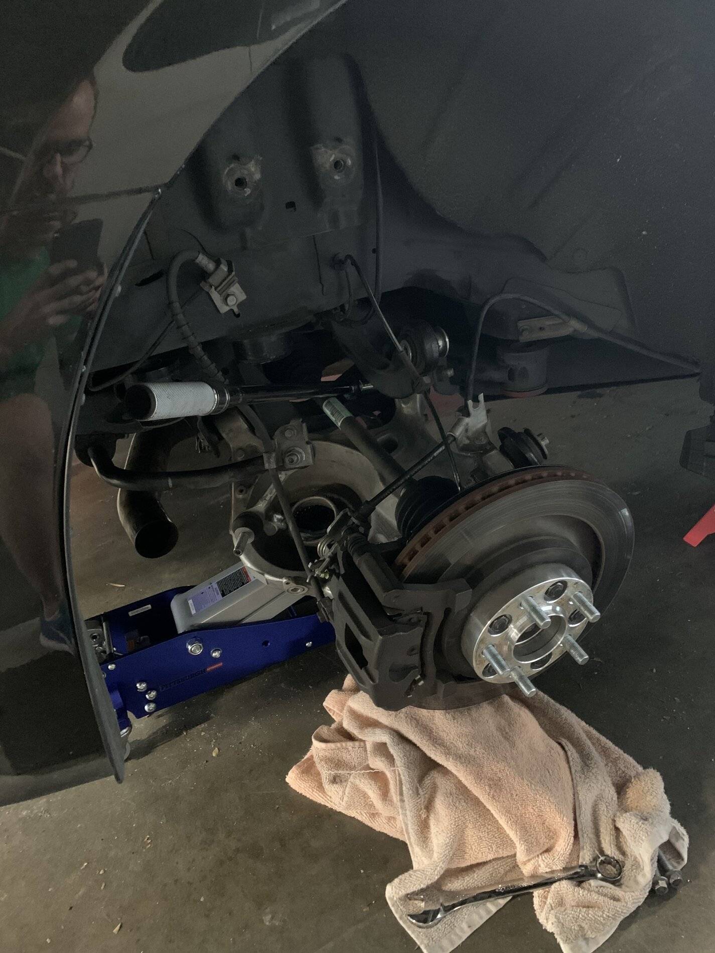

What is the right way to get to forward bolt on RLCAs ? I have knuckle out, can likely get the camber link out too, would rather not remove half shafts.
Manual talks about removing exhaust but I don't see where the exhaust would be in the way of accessing that bolt...

I didn’t remove my half shafts when I did mine, but the exhaust was off of the car at the time because I was installing LTs. With the spring removed, a 1/2” drive breaker bar and some extensions, I was able to remove the front RLCA bolts without issue.

From which side did you insert the ratchet ? From the side of the car ? From the bottom ? I still have the spring in (since arm is coming out, spring will too so I won't lower the subframe if I don't have to) but can take it out.
Since manual talks about exhaust it seems like they're suggesting getting there from opposite side of the car but I don't see a line of sight to it, exhaust in or out.

I accessed the bolts from the bottom (underneath the half shafts). You don’t have to take the spring out, but IMO, taking the pressure off of the control arm made it a little easier for me. you won’t have to completely remove the subframe bolts to lower the subframe enough to get the spring out, so it won’t affect your alignment.

there's a direct line of sight for the socket and extension going from the back to the front diagonally. axle back exhaust has to be off usually though. knuckle and axle can stay in. the wrench/breaker bar/tq wrench is rear of the subframe under the rear floor pan with the extension and socket on the bolt head. slides into the subframe openings through the space with the axle and keeps going.
from the center of the rear floor pan its roughly 45 degrees towards the front of the qter panel wheel openings or door edges. youll be off center to each side of the floor pan but youll see once things line up

Well - I was actually quite dumb - since I've had knuckles off already, I got the damper off that got me more access to forward bolt with the number of ratchets. Once that was out, spring came out without unbolting the subframe (which I could - not worried about alignment since at this point everything is apart anyway) and got the rear bolt out.
To answer my question - exhaust is in the way of removing the rear bolt - it's long and doesn't quite come out when it hits it - I wiggled it out having loosened H-pipe clamps.
