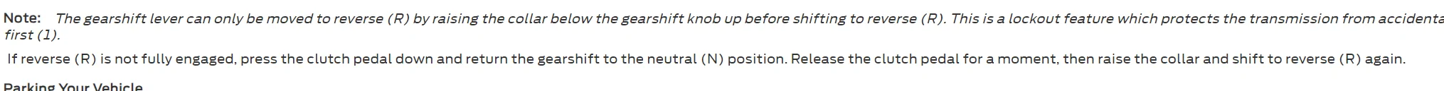

For the reverse engagement I have noticed if I put in 2nd gear then reverse it works better at times. Also per the manual if reverse wont go in then follow this:
