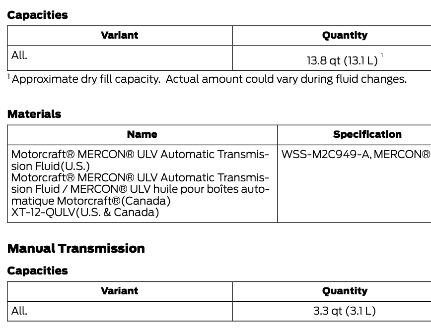

change the fluid out to BG syncro shift 2. OP mustang has a kit with the correct amount of oil and a hand pump. When I switched all notchyness in every gear change went away.
I only found a kit for MT-82, with 2.8 litres of oil. I believe there is 3.5 litres in Tremec.
