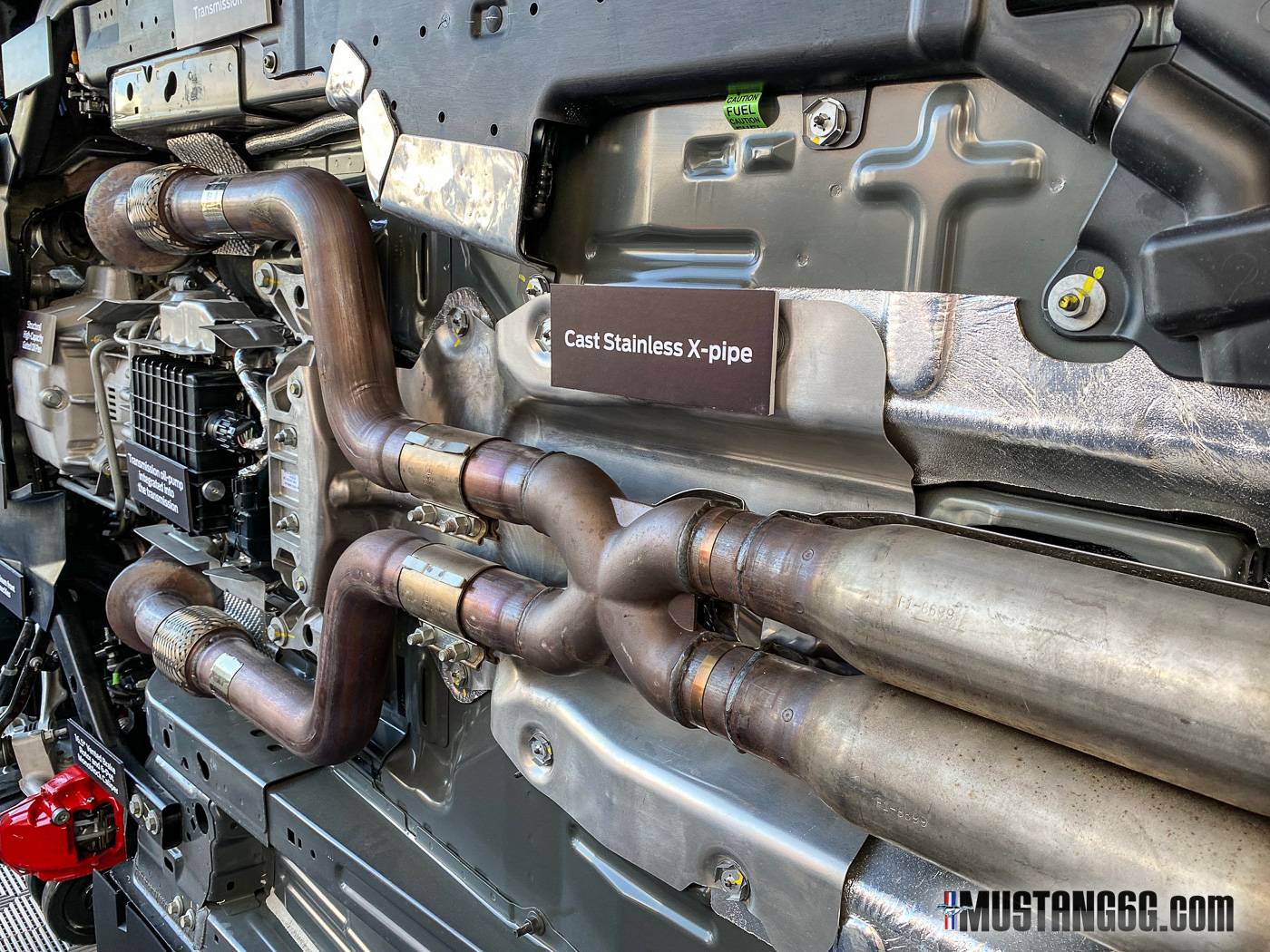

From a visual perspective, Lethal's resonator delete pipe looks to have nice, clean, bends/crimps. The stock system is 409 stainless so a 304 section of pipe is always an improvement in terms of corrosion (however slight) and aesthetic appearance. The only thing I can think of that I'd like to see would be a shield tacked onto the pipe that provides the same coverage in terms of heat mitigation that the stock pipes do. Note the shield in place around the resonators on the stock pipes...
Technically, one could argue that the increased OD of the resonators themselves places them in closer proximity to the CF driveshaft, thus necessitating a shield. And that the smaller OD of the delete pipes means convective heat is somehow reduced via increased clearance between the pipes and the driveshaft. Temperature readings of the pipes/resonators would be interesting to see as I'd assume that there is a slight decrease in temperature with a delete pipe. Just a WAG, no data here.

I personally don't think heat shields are necessary on the resonator delete. We've been selling them for the GT and GT350 for the last 5 years and never had an issue. Keep in mind we've also run 3" systems on our cars making well into the 1000rwhp range using CF driveshafts and also have never seen anything negative come of it.
The main concern I'd have with the stock exhaust on the GT500 would be the cats. Cats in general don't like heat especially in boosted applications. Lund Racing recorded some wicked high cat temps on their car before going to our race pipes. Now I don't believe the resonators see temps like that as they're free flowing and further down the line but I'd keep an eye on the factory cats especially if you're going to turn the power up from stock levels.
