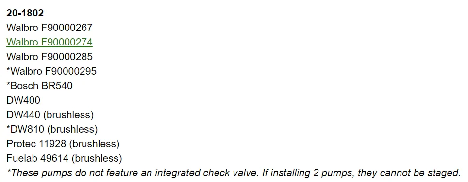

I don’t really PLAN to go a lot further with my car HP wise (currently high 700s at the wheel) but I always want my fuel system overbuilt by a lot. Knowing that my 274s likely won’t last forever, I am trying to be proactive in my planning for new pumps. It sounds like a pair of dw 400s or 440s would be way overkill (if they’d even fit) but give me ample peace of mind.
According to Radiums website, the DW400s use the same bucket/part number as the 274s.
https://www.radiumauto.com/Fuel-Pump-Hanger-2011-Ford-MustangShelby-P2165.aspx
