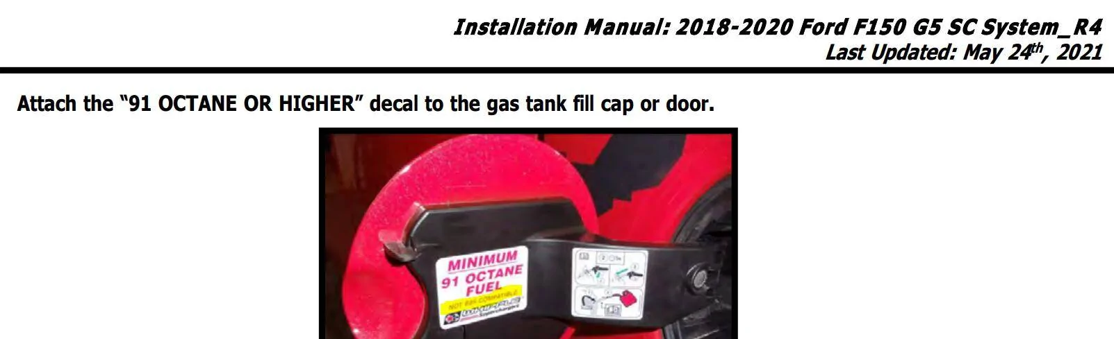

No aftermarket supercharger is supplied with a flex fuel tune. Please switch back to gasoline before something bad happens. We can discuss flex fuel tunes all day on here if you like, but right now you need to return the vehicle to a safe state.

Im sorry, but what made you think you could run E85 on the whipple 93 tune?
No need to be sorry. What makes you think it can not be done? My LAMBDA is fine across the board. What am I missing?

Whipple doesn’t provide a flex fuel tune as far as I know. While your F150 may have been flex fuel capable from the factory, the addition of the Whipple and subsequent tune have drastically changed the fuel demands. While I haven’t reviewed a Whipple tune, I can imagine it’s set for 91 or 93 octane only. Running E85 is putting it drastically outside of its targeted fueling parameters.
Furthermore, your car is literally throwing codes that say everything is not okay.
