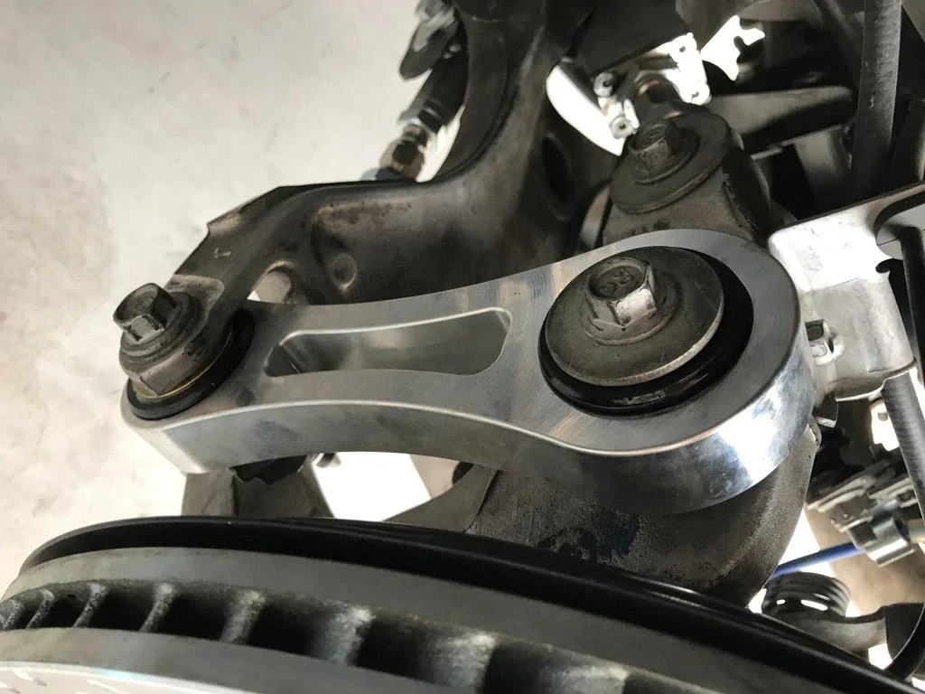

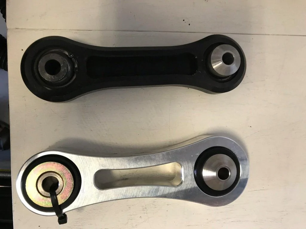

Interesting. If vertical links are working properly they'll only be noticeable when you're accelerating or braking at least moderately or hard. They resist torsional movements of the knuckle.
