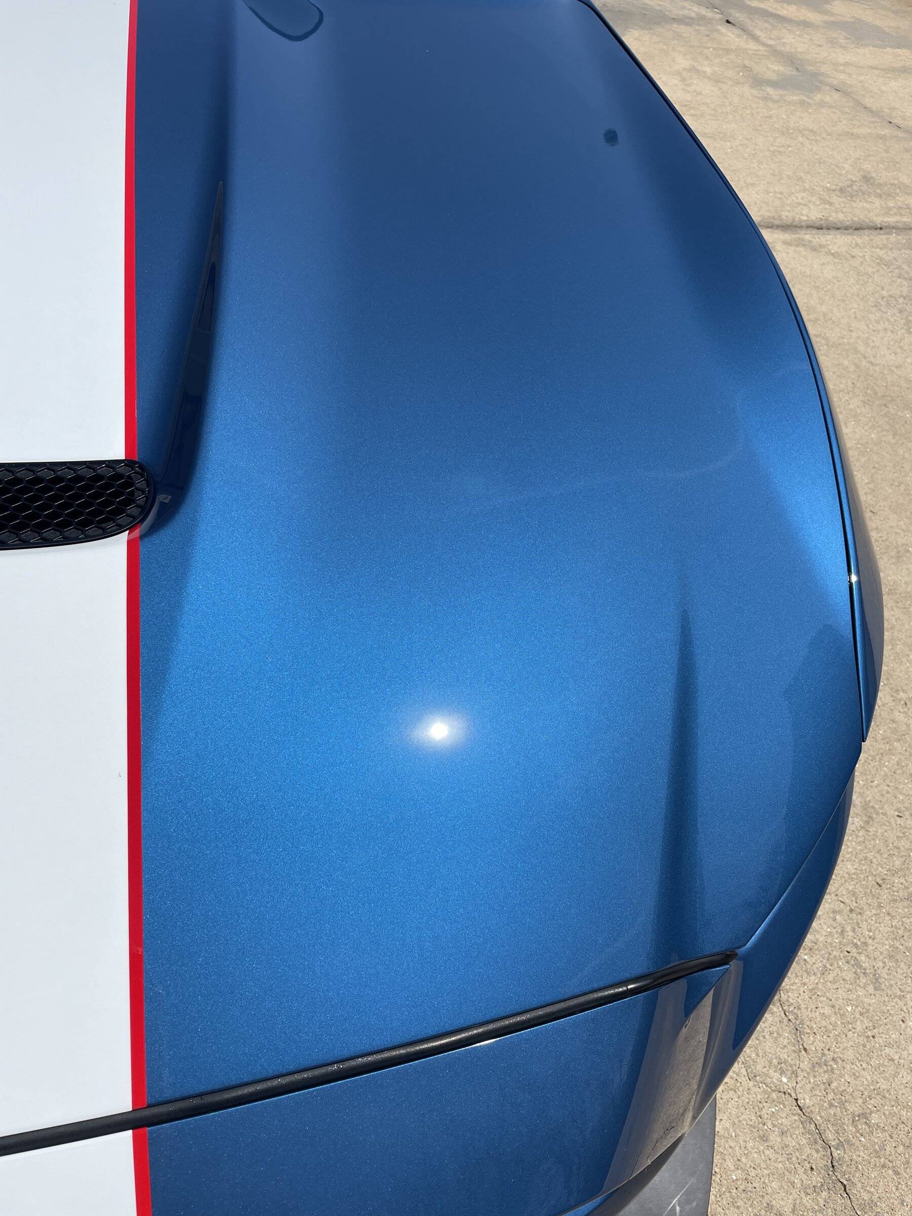

The manufacturers (at least xpel) have precision cut templates for the stripes. You can't even tell that they are different pieces
As mentioned above, if it was all one sheet, you would have air gaps at the edges of the stripes. No reason to remove the stripes IMO. And I'm not sure why one would not want the stripes protected.
The PPF definitely adhears perfectly to xpel. Not sure what brand your guy uses. I've never read on here about anyone having the stripes removed and reinstalled on top.

Correct, I have multiple seams…but they line them up with the edge of the stripes so they are almost undetectable. Take a look:

Another vote...no need to remove stripes. Since I only did my front clip, I think I opted for my guy to do the one piece over the stripes, and I don't recall the "air gap" at the stripe seam being anything cosmic...and I'm as picky as the best of us.

I also used the Xpel pattern where the stripes are individually protected with separate cuts. It’s the way to go if you are looking to protect the stripes, otherwise they are subject to damage.
