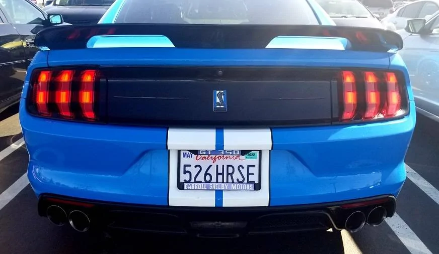

Yes, it will fit. Mine is a 2017. One thing that might come up is the residue from the track pack may be left behind on the trunk lid. I haven't gotten around to buffing it off so i am still stripe-less on my trunk. (i did have to drill two new holes, but they are under the footprint of any spoiler you choose)

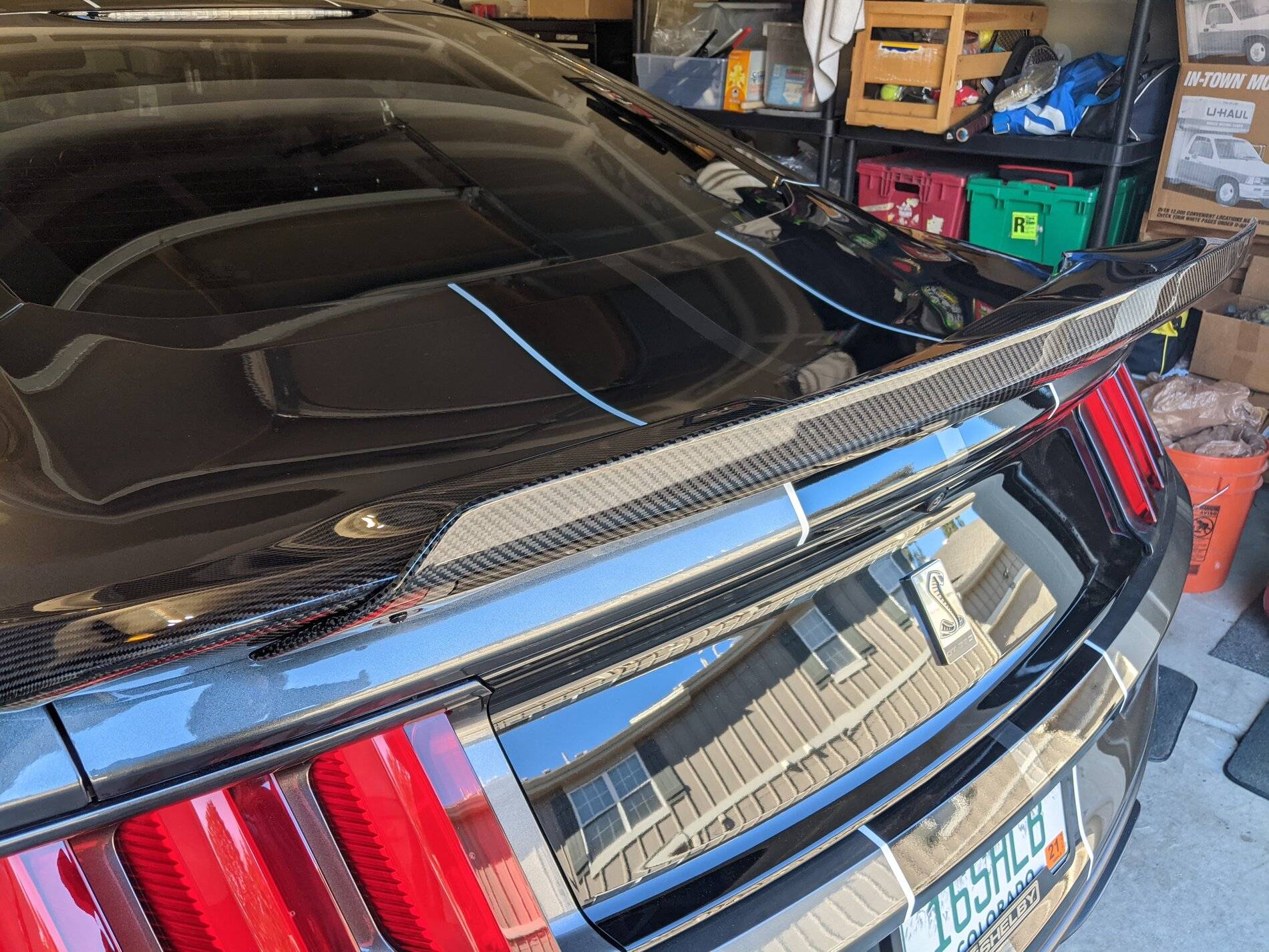

added an Anderson Composite carbon fiber wing (copy of the Ford OEM) with Gurney Flap. used same holes and I did not mess up stripes (take you time they used a lot of double sided tape on the OEM lip wing)

My spoiler has two extra bolt holes. There are six total. On the track pack, there are two near the middle. If yours is bowing, I'd check first to see if those two nuts are missing.
(My stripes were damaged under the spoiler. previous owner replaced section of stripes but never removed spoiler)
