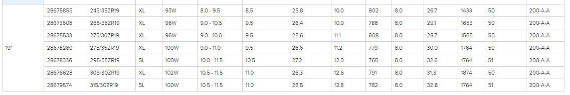

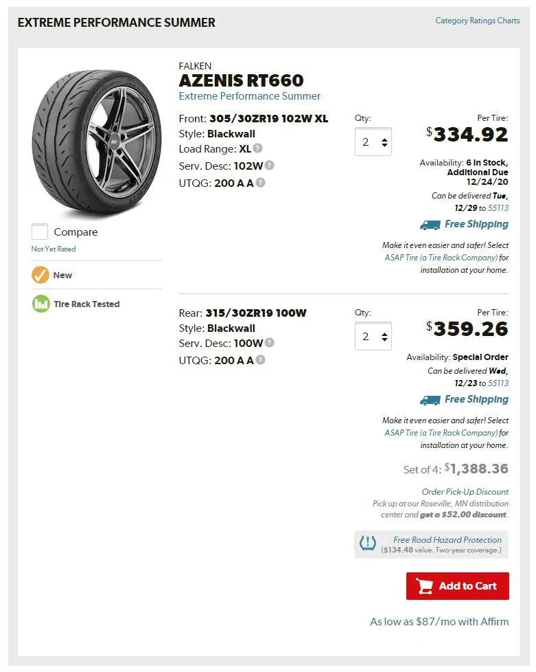

Several tire manufacturers have been competing in the 200TW space for SCCA, NASA, and Optima. Falken, which has been a fixture in SCCA and is now a sponsor for Optima, has the Azeni S660 fitment for the GT350/R. TR rates it largely better than Cup 2s and they are quite a bit less expensive.

Jeez can't believe there isn't more news on this. I and the rest of the R camp have been waiting on a Cup 2 alternative in OEM sizing for ages. Less hard core primarily in the treadwear dept and maybe a bit better wet performance if caught out in the rain. This is primarily for a spirited street weekender use case.
The RT660 appear better than the SC2 in both wear/wet. Only downside is apparently ride quality/noise.
My current PS4s in 305/325 are great but the rounded rear end poke in 325 drives me nuts. 305s in PS4 are a bit too small. I wouldn't mind a more hard core tire. The SC2s appear to last about ~6k on the street. The PS4s about 30k. If the Falkens can hit 15k and be cheaper than both PS4s/SC2s... I found my next tire.

Tire rack may not have them in stock. Looks like Falken does make them per their site. No 305/35 though?
