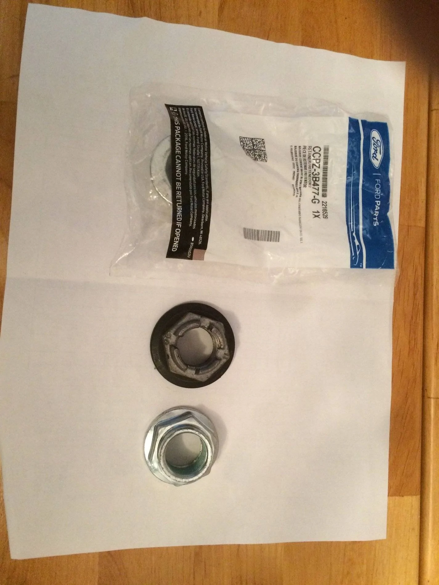

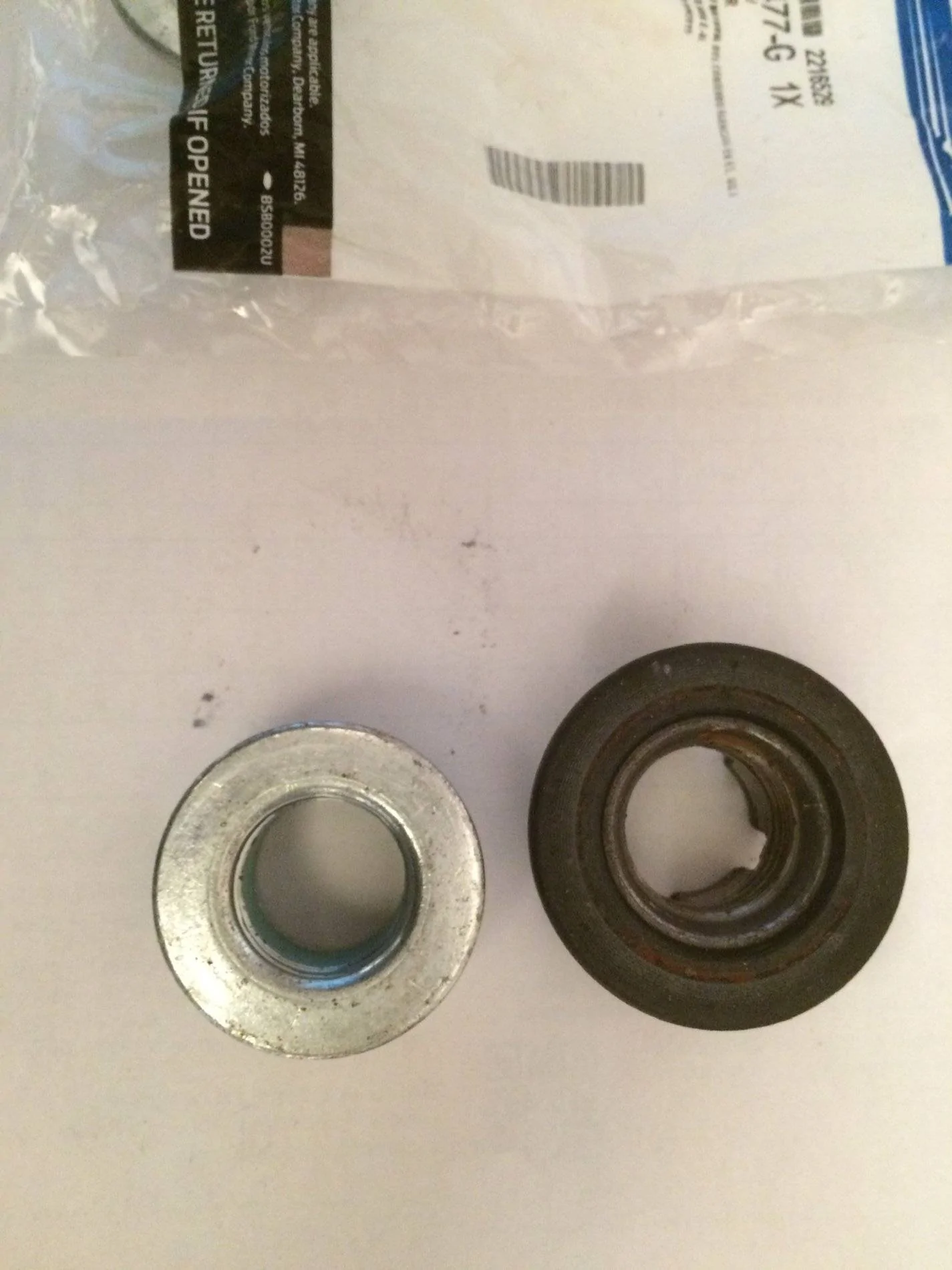

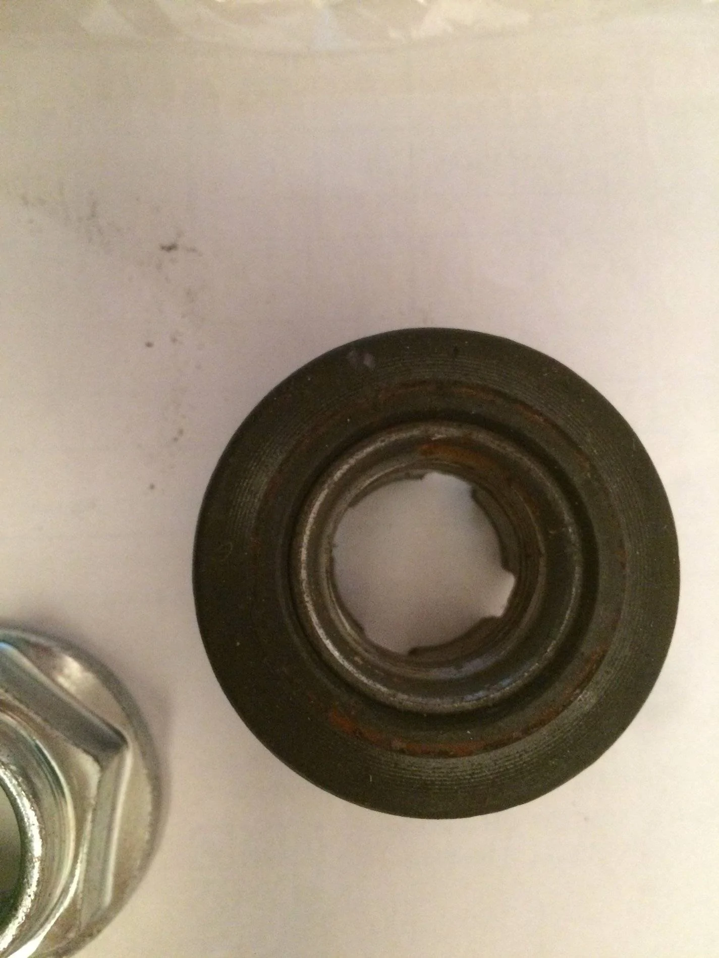

I am replacing my axle nuts 2015 GT PP.
The ones that the Ford dealer sold me are significantly different than the ones on the car. The new ones look like the ones sold on LMR.
The new ones have the right thread and 32mm nut size but the shoulder is significantly smaller in diameter.
Has anyone else experienced this?

I don't think it changed, but a lot of people have problems with them coming loose. There's numerous, very long threads on here about it. Unofficially, the recommended torque is 150 plus 1/8 of a turn.

Thanks, I’ll probably add some red loctite as well.

Yup they’re different. Gave me pause when I replaced a hub last year.
replacement part hasn’t fallen off the car yet so you should be good.
