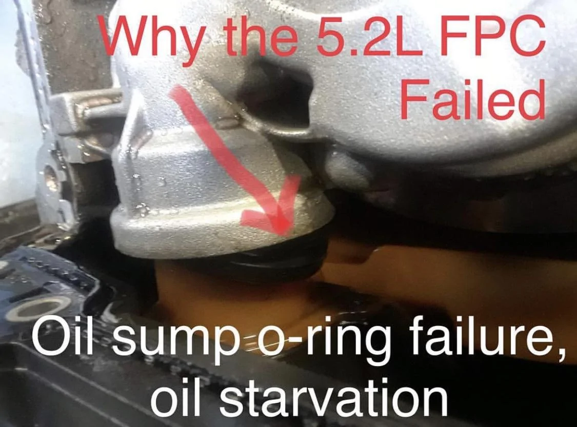

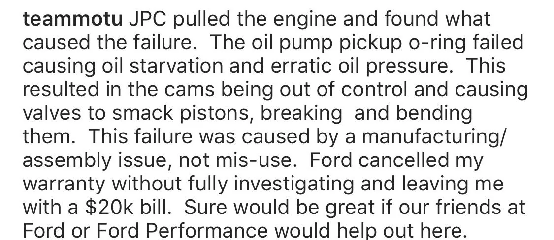

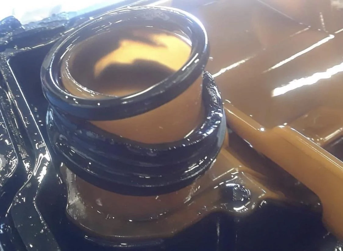

Good find, and good to see that someone has at least torn down one failure, that is actually a complete failure. Too bad about his warranty though... what did he expect to happen when getting an aftermarket shop to crack open his engine?Just came across this on Instagram.....
They revoked his warranty before the aftermarket shop touched the car. They said it was because of his tune and that he "raced" it even though it was only track days and no competitive racing. Once the warranty was fucked, then he went and took it to a shop to tear the engine apart. I think this should have been fully covered by Ford but it is what it is now.Good find, and good to see that someone has at least torn down one failure, that is actually a complete failure. Too bad about his warranty though... what did he expect to happen when getting an aftermarket shop to crack open his engine?
This!!!! ^^^It's still miniscule. Scowering through the forums and FB, there's no way you can even come up with (pick a number) 100 engine replacements. I can't. With ~20,000 cars on the road, I'd say yea, numbers are still minuscule. Or at least in my opinion. I just picked the number 100 out of thin air as I don't know what else to reach for since I can't even get that high; what is your (and others) definition of "a lot", outrageous, or alarming rate, etc? That has yet to be defined, even if just opinion. That might help us meet on common ground if we knew what you guys defined as a lot, or what would define an epidemic. I may have to eat some crow on this one, and if I do, I'll chew and swallow proudly, but I'd be willing to bet Ford (from a purely business standpoint) does not consider low singe digit %% failures as an epidemic.
Yup! J got screwed by the dealer. Ford denies claims with input from dealer. Dealer says, cars been raced had tune and wala! Warranty nixed.They revoked his warranty before the aftermarket shop touched the car. They said it was because of his tune and that he "raced" it even though it was only track days and no competitive racing. Once the warranty was fucked, then he went and took it to a shop to tear the engine apart. I think this should have been fully covered by Ford but it is what it is now.
