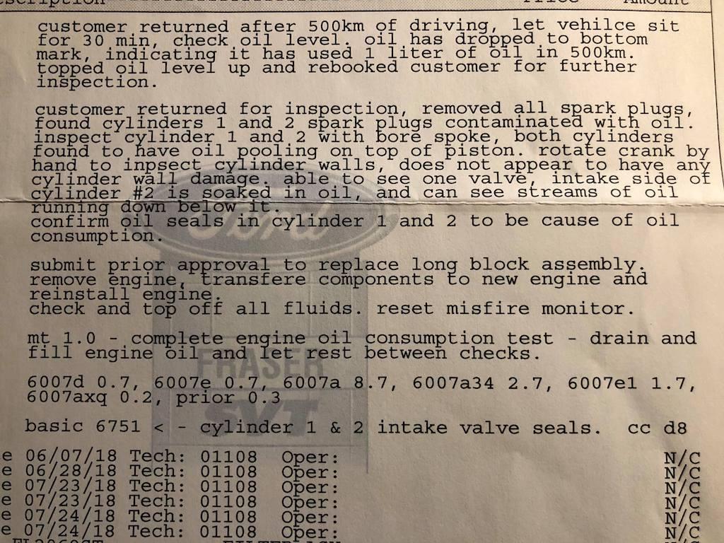

Took my car in Monday at 8:00 AM. Dealer worked on it from 9:00 AM to 9:00 PM pulling and replacing the engine. Let it sit all yesterday to ensure no leaks etc. . Dealer detailed the car for me and I picked it up today. From what I can see from under the hood everything is back where it belongs. Dealer said they did pull it out from below but they also took the hood off to make it easier to work on it during the pull and the re-install. New engine is running very smoothly, seems slightly louder than the old engine, and seems to hold the revs better ( which could be because it doesn't have the oil burn problem ). For info purposes attached is the diagnosis of what was causing it to burn oil. Some obvious typos in the diagnosis, but they did find a problem with the engine
Thats like the first "real" diagnosis i've seen on this oil burning issue. Wouldnt the car be smoking like hell out the exhaust if the valves seals were leaking?

It would smoke like mad if that much oil was getting past the valve stem seals. Also, I use minimal oil (maybe 1qt every 3k miles - which is typical of other high-revving cars I've owned)...but I too have some carbon on the exhaust, I believe that's normal. My Audi does that and my last 2 DOHC mustangs did that, too. I suspect you'll get it back :)

Don't flame me because I'm no mechanic but why do you need to replace the entire engine if it's only the valve seals?

You would think it would smoke but they don't. My first engine was going through more than a quart every tank of fuel and I never saw smoke. The back of the car was covered in soot but no smoke. At my request they replaced the catalytic converters knowing they were being over worked.

same for me, and i've not heard of any of the many with this issue noticing smoke either
Kinda like what Scoobs said...these guys are not trained engine builders. And probably for the better; they've got zero business cracking one of these engines open. Just R&R is about all they're allowed/qualified/certified to do. Maybe a head swap or something, but not breaking it down that far.
