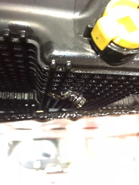

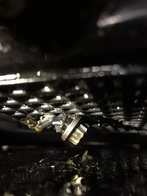

Well....it happened to me today at the track. 3,000 miles. Was not pushing it when it happened. Rod thrown through the oil pan. Had the oil changed a few weeks ago and I checked the oil before I went to the track. It is sitting waiting for a tow truck to tack it to my service dealer.

Wow, bummer. I don't think you need a teardown to figure out what happened there.
Yep. I beginning to think this post from page 1 was this issue:
"My local dealer has 2 gt350's that are having engines replaced. Was told that they were exhibiting major oil consumption due to out of round cylinders. No details on the year, mileage or if it was an "R"."
Wondering if an out of round cylinder would cause this.

I believe low or no oil pressure is one of the causes, which brings us back to the OPG debate. OPG takes a dump, bearings spin and rods are thrown.
Other things could cause this as well, but we are talking about cars with low miles, so I highly doubt worn out parts. "not pushing it when it happened", so I don't think it was a money shift either. Only ford will know when they tear it apart.
