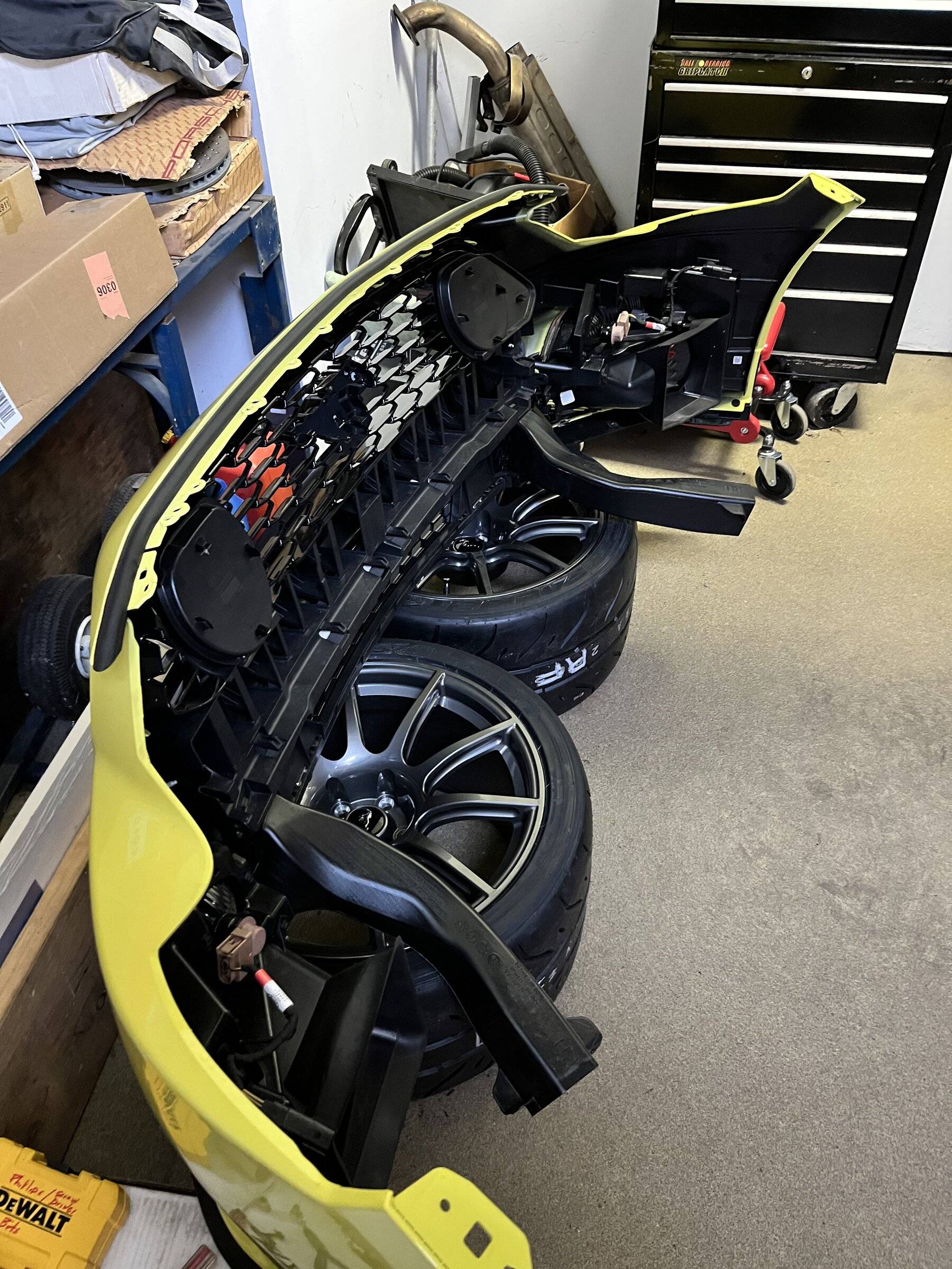

Anyone have info on all the connections needed to be removed to take off the front bumper cover.
I’ve seen videos on normal Mustangs and that’s helpful but missing a few items.
Before I force anything it would be nice to know the steps.

Ok got it off no issues, a few sneaky bolts/connectors but figured it out.

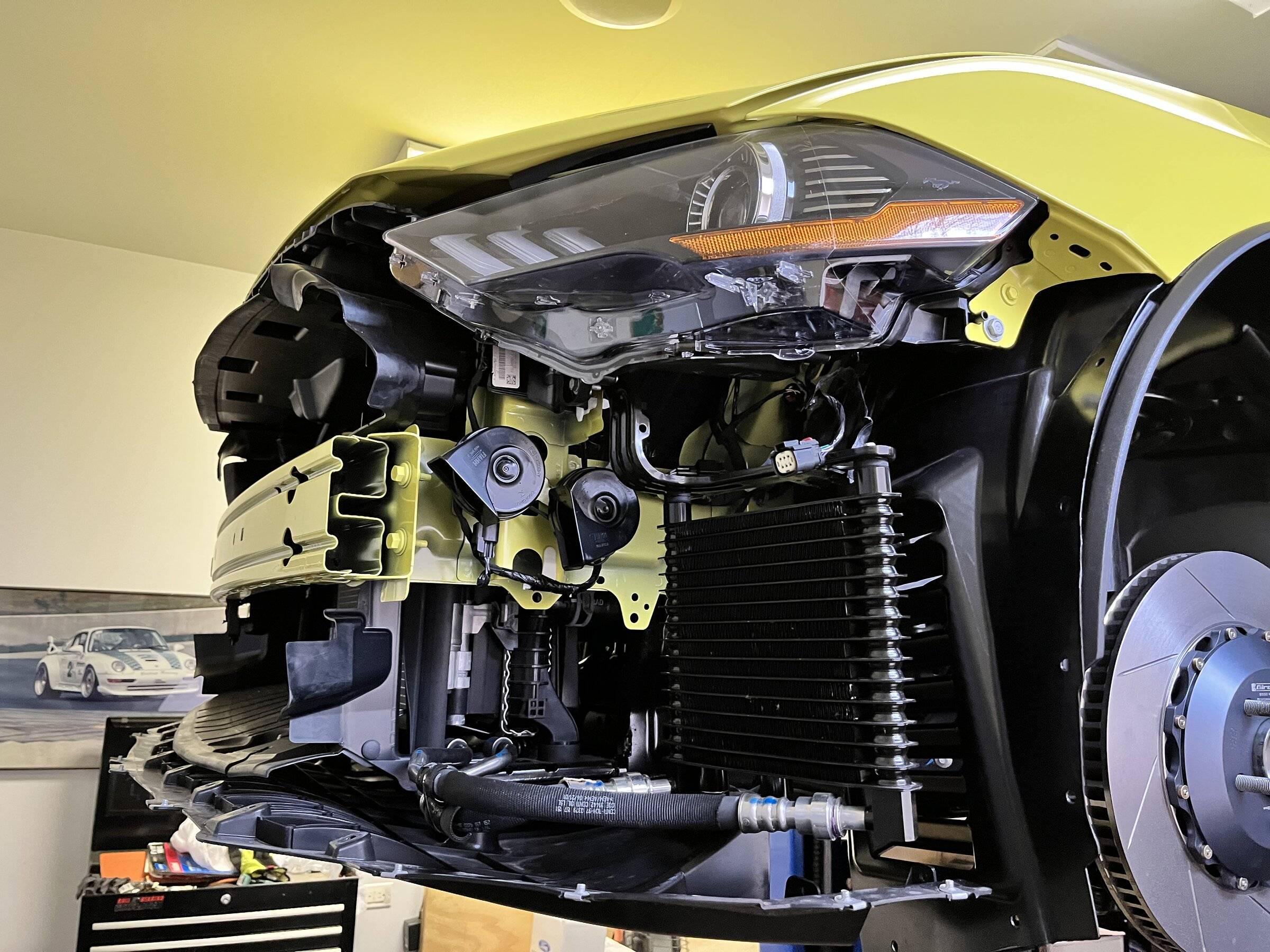

All back together, super easy. The plastic rivets for the HP splitter are $70.00 unless someone has a line on them. Should be $5 for 10 of them not $3.50 each. Not a big deal but just funny.
Very impressed with the fit and easy reinstallation. Not a struggle that I was worried about.
Watch the 2018 video about Front Bumper removal from LMR. Don't remove the Belly Pan.
Reach the Fender/Bumper 2 nuts on both sides from the top of the engine bay.
Drill out the rivets if you have the HP splitter, if not it's just the screws to remove from under.
Must remove all plastic fasteners in the Front section of the Wheel wells.
Now that I've done it, probably can remove in 30 min max.

Sticking with magneride for now. Have the stock brake calipers with 2-piece front rotors.
Plenty of stopping power, the 2-piece save weight and run cooler.
Removed the heavy inner bumper and installed a Race bar. The reason for the thread.
https://www.steeda.com/steeda-555-5098-s550-front-bumper-bar
Focused mostly on reducing weight. that alone will make the car way faster then most modifications.
