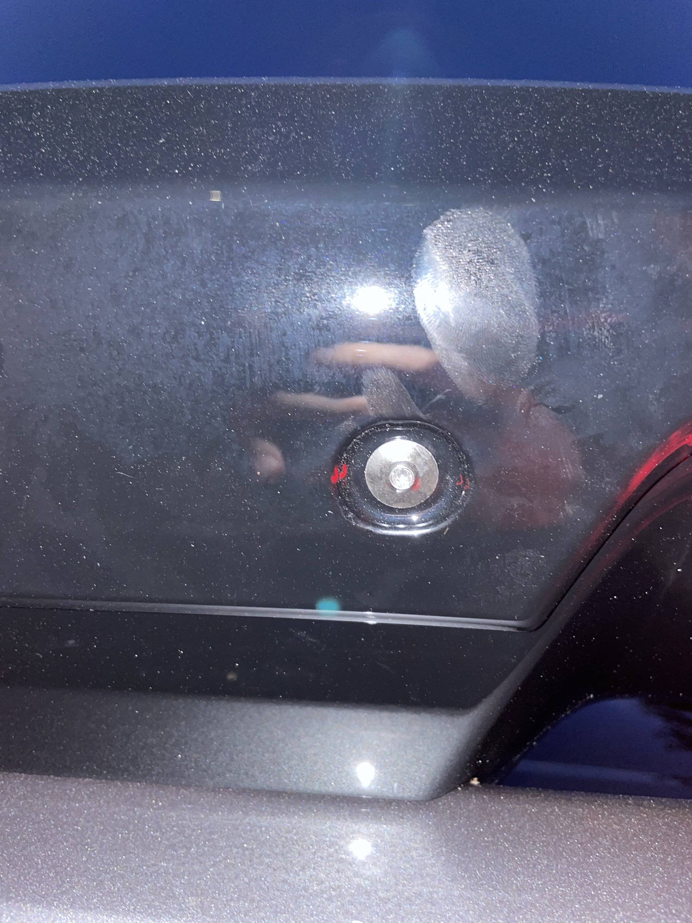

The head of the torx bolt that holds in the gurnee flap is stripped out. The rest are perfectly fine, just wondering how to go about removing this one so I can replace it. Threads inside wing are fine as well. Any ideas?

Use a drill & easy out, a lightweight fastener like that will back out easily

Ez out FTW.
TBH, I’ve never seen anyone strip a torx before. I’m sure it happens but dang.

I’m an idiot and instead of going hand tight I went by the torque specs in the manual and it happened while using my torq wrench :/

Bummer.

Personally, I'd use a reverse drill bit. As it bites in, it might spin it out before you would need to use an ez-out.
PS - it is a Gurney flap named after the late great Dan Gurney.
Agreed. And even if it doesn't back out with the reverse drill it will still leave a hole for the ez out.
Another, slightly riskier, option would be to cut a slot with a dremel and try a flat head screwdriver.

Left hand drill bit.

Don't know how much room you have on the outside of the bolt to work with, but maybe clamping it from the outside with - pliers or vise grips, you're not going to reuse it.

Surprisingly it calls for 49 in. Lbs so I had my torque wrench to 4 ft. Lbs.

Ouch! Lesson learned, but at least it is in a place that is easy to get at, that's a plus. Torque wrenches, have their place, no drought.
Guess I am surprised that there was even a suggested setting & ft lbs & not in lbs, a bigger surprise.
That's a problem with engineers overkill too many specs, lacking common sense......
Best of luck with the fix, you will get-er-done just fine.

If the solutions above don’t work, Dremel a slot in it and us a flathead.
At any rate I am a big fan of masking the area off to protect it.
