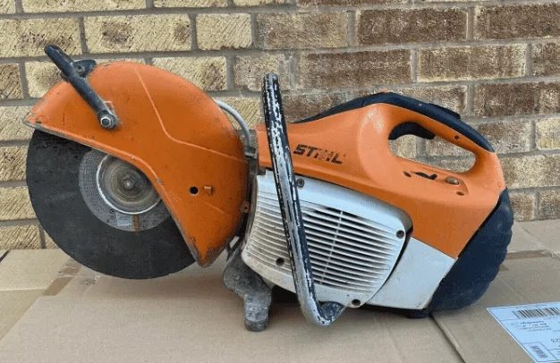

I don't know how thick the gurney is but if all else fails, drill the head off with a large diameter drill bit - stop as soon as the head breaks loose (no damage to anything), then remove the gurney completely and get some grips on the remaining bit of stud :like:
And if that fails ...
WD :like:
Disclaimer : I'm joking on that last bit ...

And large amounts of masking tape.
