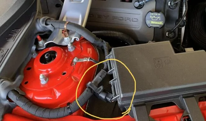

Disconnect the BMS sensor, this will force the Alternator into full output. This will tell you if the Alternator is indeed charging, or if it is just the BMS system doing it's nonsense
I’m interested in this.
Is it safe to start the engine with this connector unplugged?
If it works, the voltage on the dashboard should show the alternator’s full output, right?
