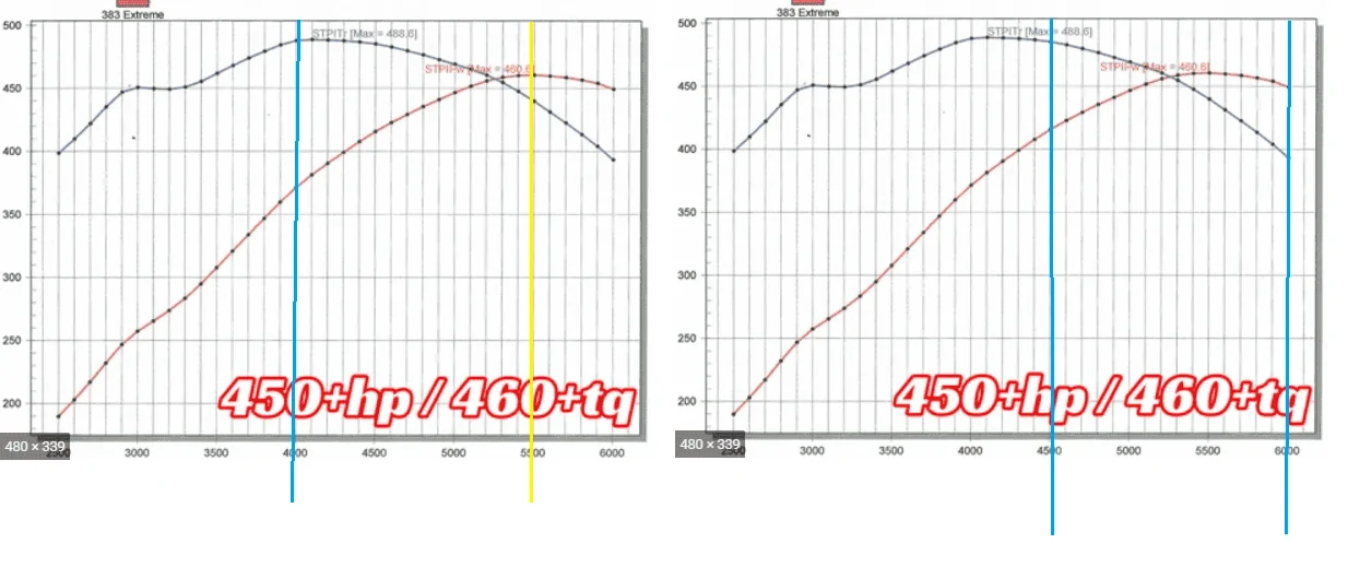

Ford shows maximum horsepower, 460, at 7000 rpm. Not sure I understand the purpose of going beyond that. Just because you can do something doesn’t mean it makes sense to do it.
Because it is not about hitting maximum horsepower (rather not about hitting a maximum hp number), it is about the total power area under the curve in a gear, from the shift into it until you shift out. you would ideally want to peak HP to be near the middle of the RPM range unless the power drops off a cliff on the end (like a big block with weak springs that'll float valves at 5kRPM)
compare these two identical curves, suppose you had a 1500rpm range between shifts
if you went with the second shift pattern, your average HP would be up significantly (and your applied torque would be as well, even though it is instantaneously lower on the second pattern...but that's a different physics discussion)
The other benefit is that by shifting at a higher RPM, provided the motor can handle that RPM safely, is that when the RPMs drop into the next gear, your are at, in this example, 500RPM higher, or about 50hp more already available.
Now, for 1st gear this doesn't really apply, that is about instantaneous torque to get moving initially. some of the older transmissions you would shift into second pretty quick to keep high torque up through about 50mph before moving your shift points up in 3rd and 4th gear where HP is a bit more important
basically, you drop the red portion, and gain the green portion for power applied:
I get it now. Thanks for posting.
