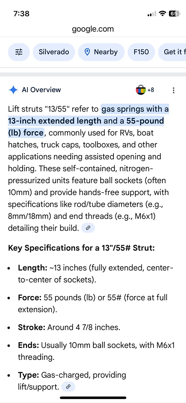

Lift struts never last forever
If you know the stroke ( which is the length of the outer part) and the psi pressure, you can just order by that
For example the ford racing are 13/55
Meaning 13” long and 55 psi
