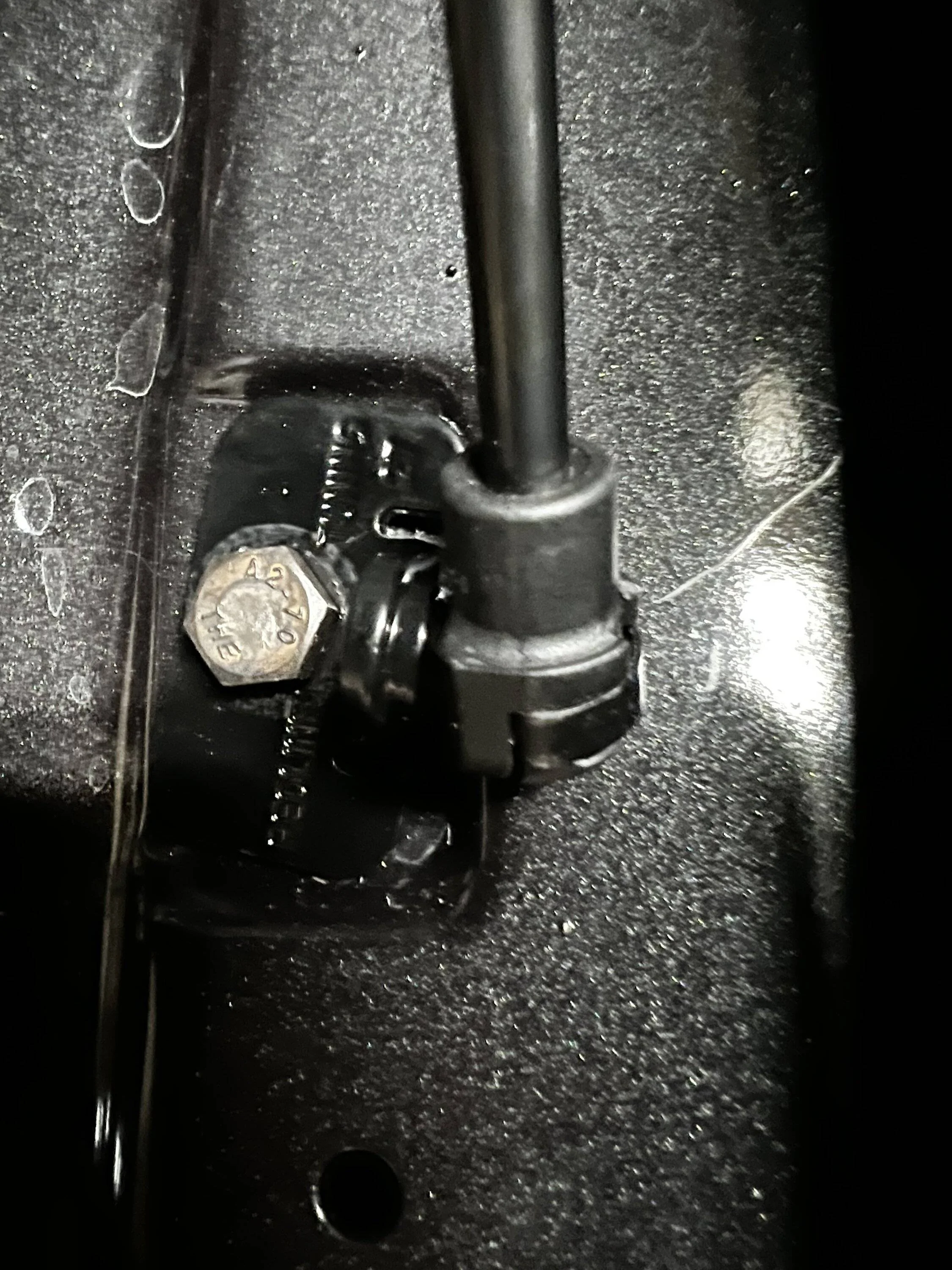

Installed the hood struts I had gotten for a deal from a member on here a few months back and everything snapped into place, and the clips were secured.
Turned around for like 2 minutes and heard a pop and luckily still had the prop rod up. Unfortunately I need touch up paint 🙃
anyone ever have this happen?

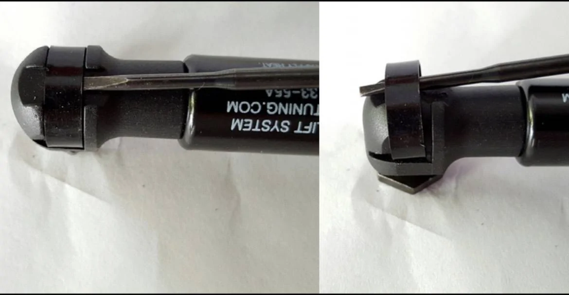

I have Redline struts, never had them pop off. Is it possible the c-clip wasn't pushed in all the way prior to installation or the socket wasn't completely pushed onto the ball stud?
(from install instructions)
How To Remove Struts:
Slide a small flat blade screw driver under the metal c-clip. Lift and rotate c-clip (DO NOT REMOVE C-CLIP). Gas spring will pop off of ball-stud.
Press c-clip back into position and the gas spring is ready to reinstall.

Hopefully it's not defective. Your fender bracket does look a bit pigeon toed which would put extra strain on the c-clip.
Mine didn't pop, but I had the same issue with the Ford struts. It started prying the c-clip open when the fender bracket twisted.
I ended up adding self tapping screws to keep the bracket straight.
