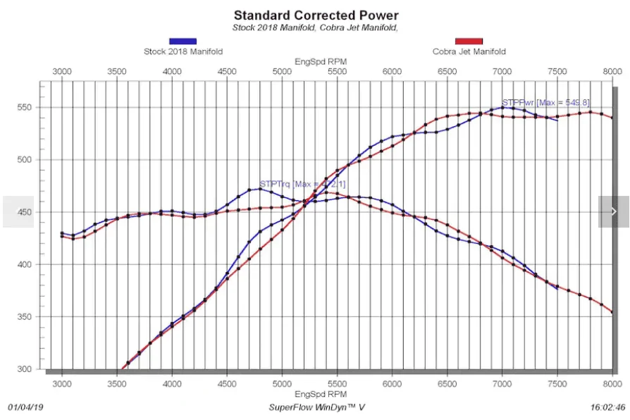

This!
And this is the graph that shows why the CJ will kick 2018-ass at the drag strip or roll race, especially with an A10 shifting at 8,000 rpms! You can infer right where the 2018 manifold HP number will end up when it finally gets to 8,000.

This!
As long as not wanting to run a flex tune...
E85 only for me but feel free to use whatever "CAI" you like. The point is the Cobra Jet will beat the 2018 manifold. All the fastest N/A cars have a Cobra Jet.

This!
Not many are shifting their stock Gen 3 Coyotes at 8000 rpm. What this dyno graph shows is that the avg. hp of the stock '18 manifold from 5800-7400 rpm is 535 hp on a Gen 3 Coyote with this setup. The avg. hp of the Cobra Jet from 6300-7900 rpm is about 541 or 542 hp. If you think those are massive gains, I don't know what to tell you. 6-7 (crank) hp is marginal and isn't going to translate into amazing gains at the drag strip. Lowering the engine, bending fuel rails, etc., needed to install it...not worth it IMO on a stock internal engine.
That said, if someone went with a Stage 3 cam setup that are designed to rev to 8000 rpm, then the Cobra jet would make sense, allowing the cams to make much more top end power above 7400 rpm than a stock manifold. The Cobra Jet would fall in my "3rd category" of someone who has done FBO and heads/cam, and is looking to get every bit of power out of an NA engine. On stock cams, or mild aftermarket cams, a ported '18 will hold its own vs. a Cobra Jet, and help make more midrange torque. That's another thing about this curve - the '18 manifold makes more power below 6200 rpm at nearly every point on the curve, with the exception of 5300-5500 rpm, which the Cobra jet is making slightly more due to the shape of the torque curve.
