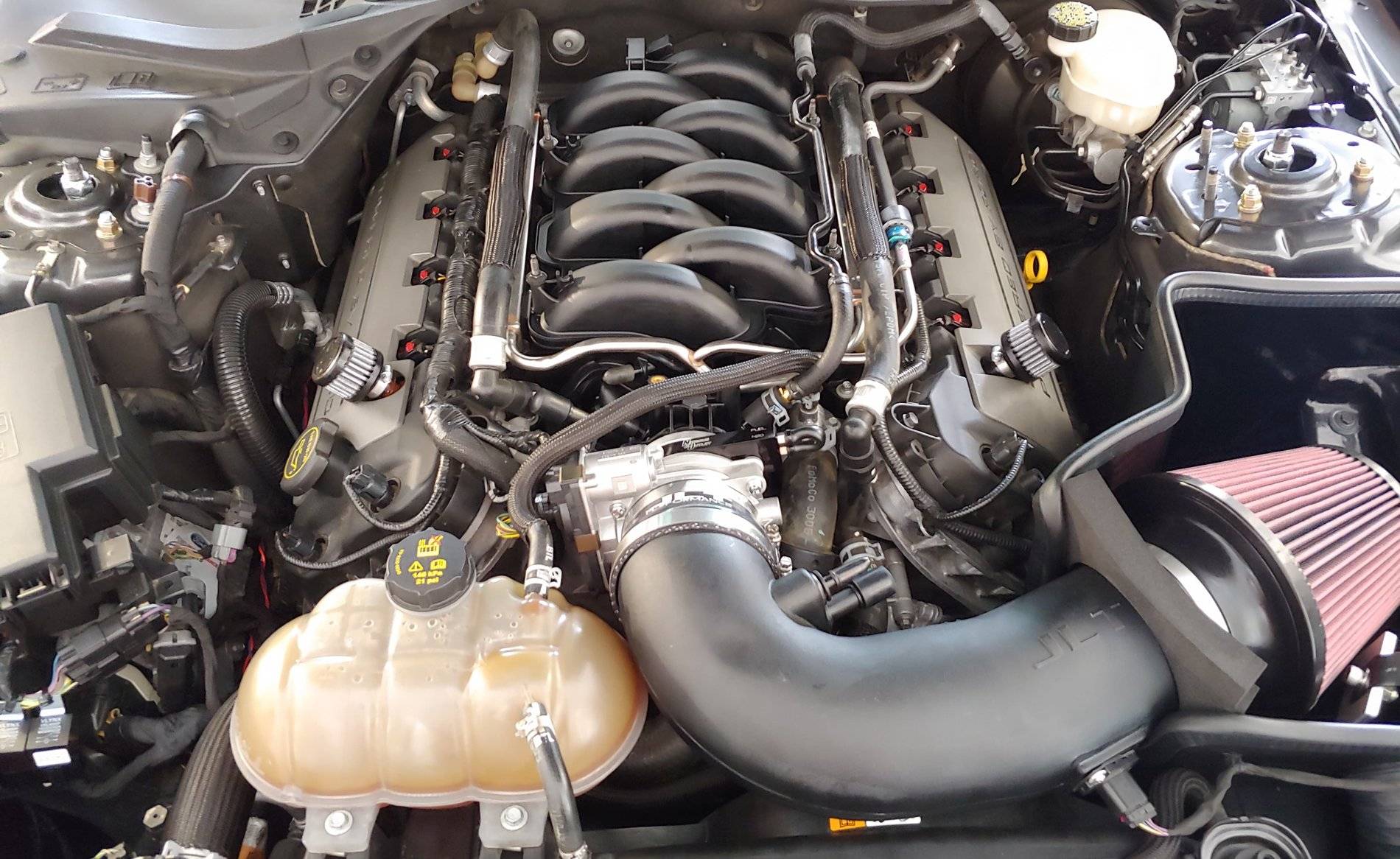

I drive a 2019 A10 GT with all of the bells and whistles. CJ, Comp Cams, Big TB, LTs - everything. Fast car. Has been 135mph in the 1/4mile.
That said, I love my 2016. It has a GT350 Intake Manifold, 95mm TB, JLT and 2" LTH Longtubes. Super simple combo and much more fun to drive with the 6R80 and 4000rpm converter. Its much much much less of a car and less modded than the 2019 above I mentioned, yet only a few tenths "slower".
I also had great luck with a ported 2018 Manifold. That combo was a fun 10-second combo, but the GT350 IM just pulls much harder.
