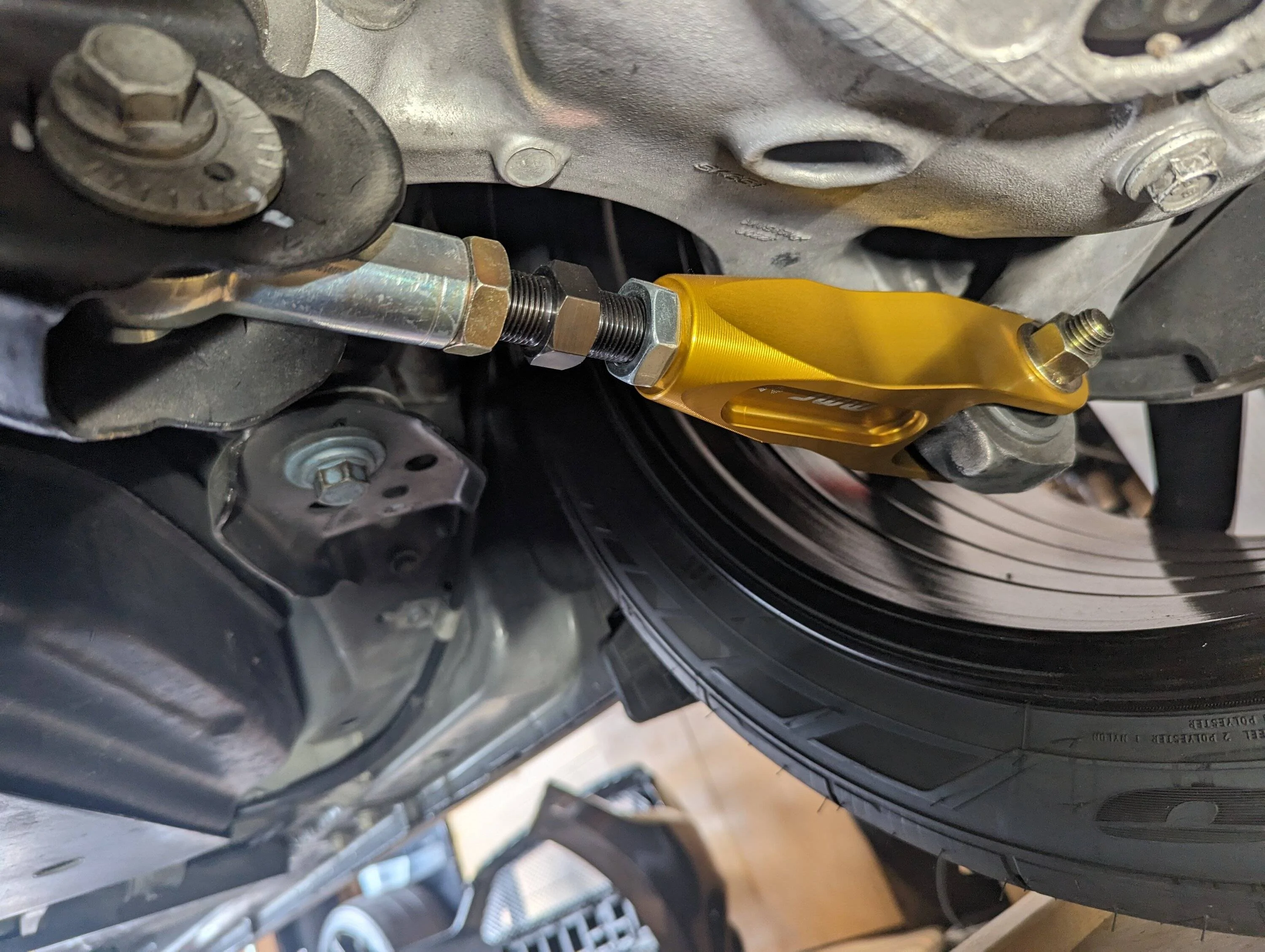

I’m installing Steeda rear toe links and I lost the nut for the bolt that holds the end at the knuckle. Does anyone know the size of the nut? I’m trying to find one locally before I call Steeda. I checked Home Depot but nothing they had fit.

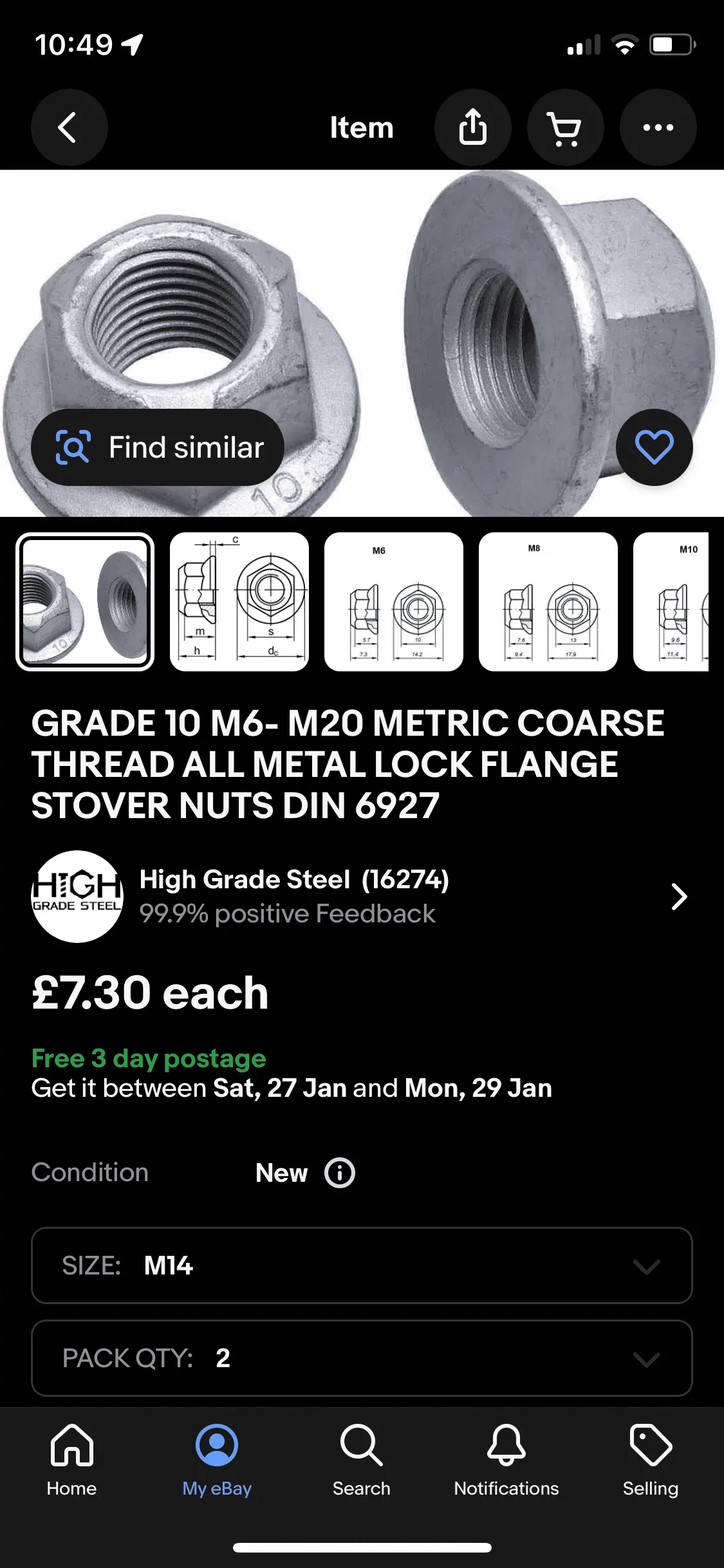

I’m pretty sure it’s a high grade M14 (standard pitch) plated nyloc flange nut.
Spanner size is unimportant if you are buying non OE, but I seem to recall my OE nuts being 22mm.

M14x2.0 My MMR new toe links didn't even come with those nuts. Ordered flanged yellow zinc ones from Belmetric.com.

1.5 is not compatible with 2.0 (thread pitch) :like:

Reuse your existing eccentric bolt and nut. The M14x2.0 nut is to replace the nut that is welded to the factory toe link.

If M14 x 2 is correct, eBay item number 185758496322 :

the PP toe links don't have a nut and is integrated like you mentioned. Non PP toe links have a bolt and a nut
