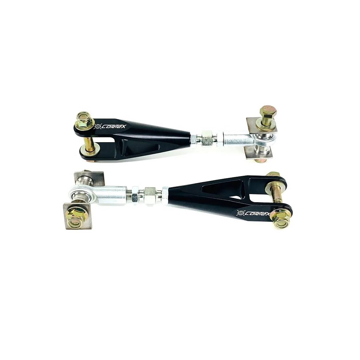

I have Cortex. Quality part.

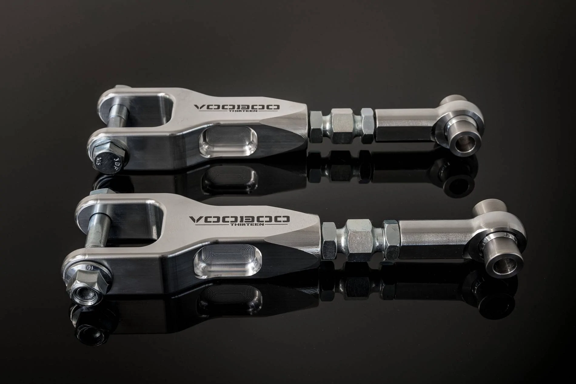

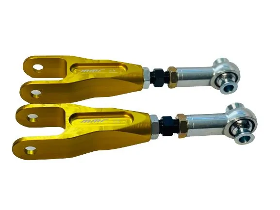

Do you think these 2 have a common origin?

Unless it's track duy car exclusively none of them are an upgrade for the street but if I had to pick one I'd get voodoo for the PTFE lining and looks.
Not a track car "exclusively", but I do road course HPDE and Like to have the car perform best it can. As noted in the post above, the toe link upgrade by itself is likely not even perceptible to a guy with my level of experience. But that doesn't stop us "modders" from spending the money anyway, does it.

I have the MMR's. They don't even give you the bolt. Would've gone Voodoo if I had seen them even at the higher price. Very nice.
Yah, I was kind of surprised MMR didn't include Bolts and lockout washers. But they are $120 less than the VooDoo version. I can find 10.9 grade bolts and some square washers for the MMR's.
