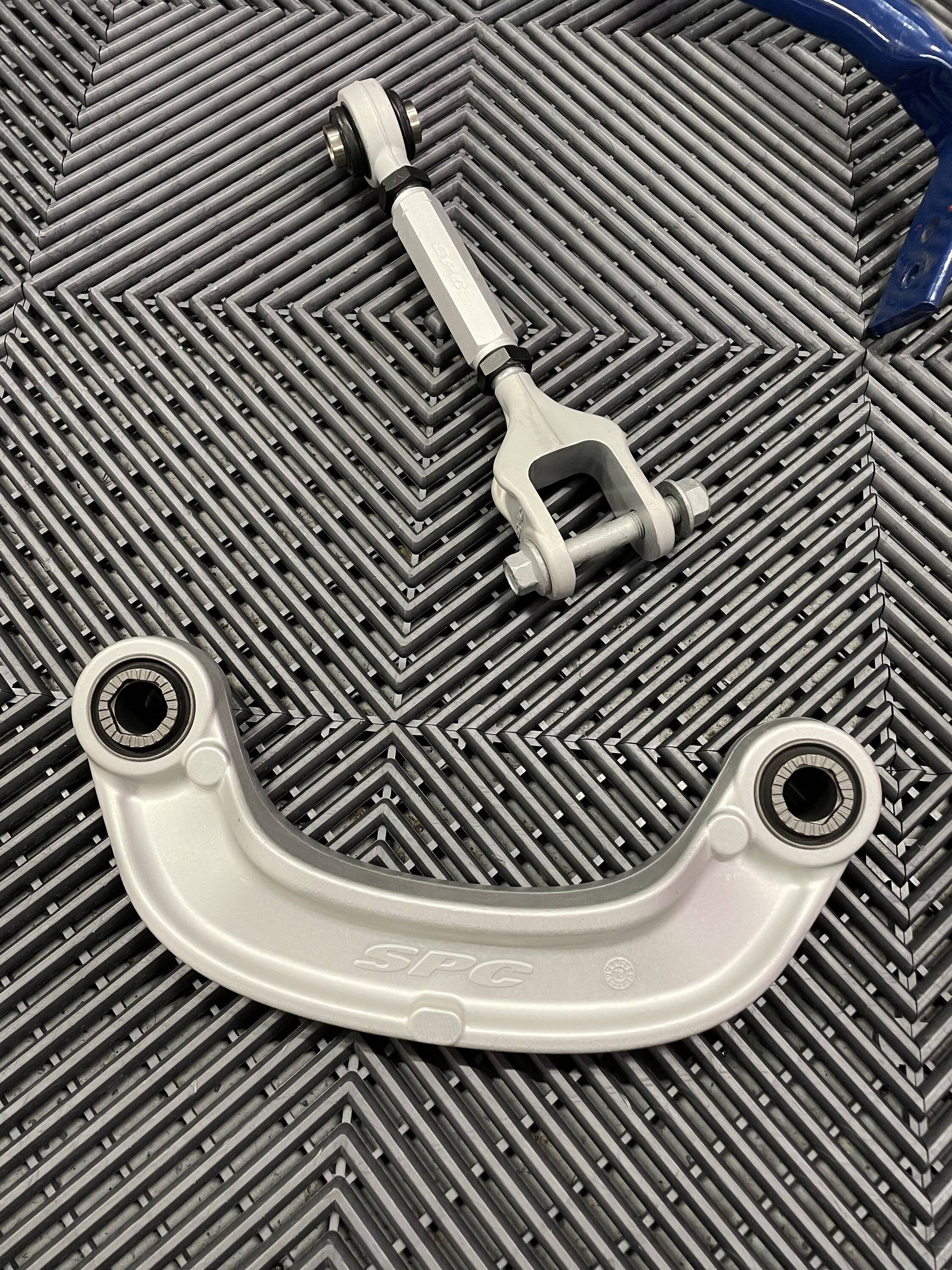

Weeelll, after not much action in this thread, but an inordinate amount of research, homework, and indecisiveness, I decided to go this route. And have zero regrets. After the things I discussed with some of our more trusted and experience members on here, I really don’t understand why these (SPC) aren’t more mainstream. But, whatev’s! They are ridiculous light.

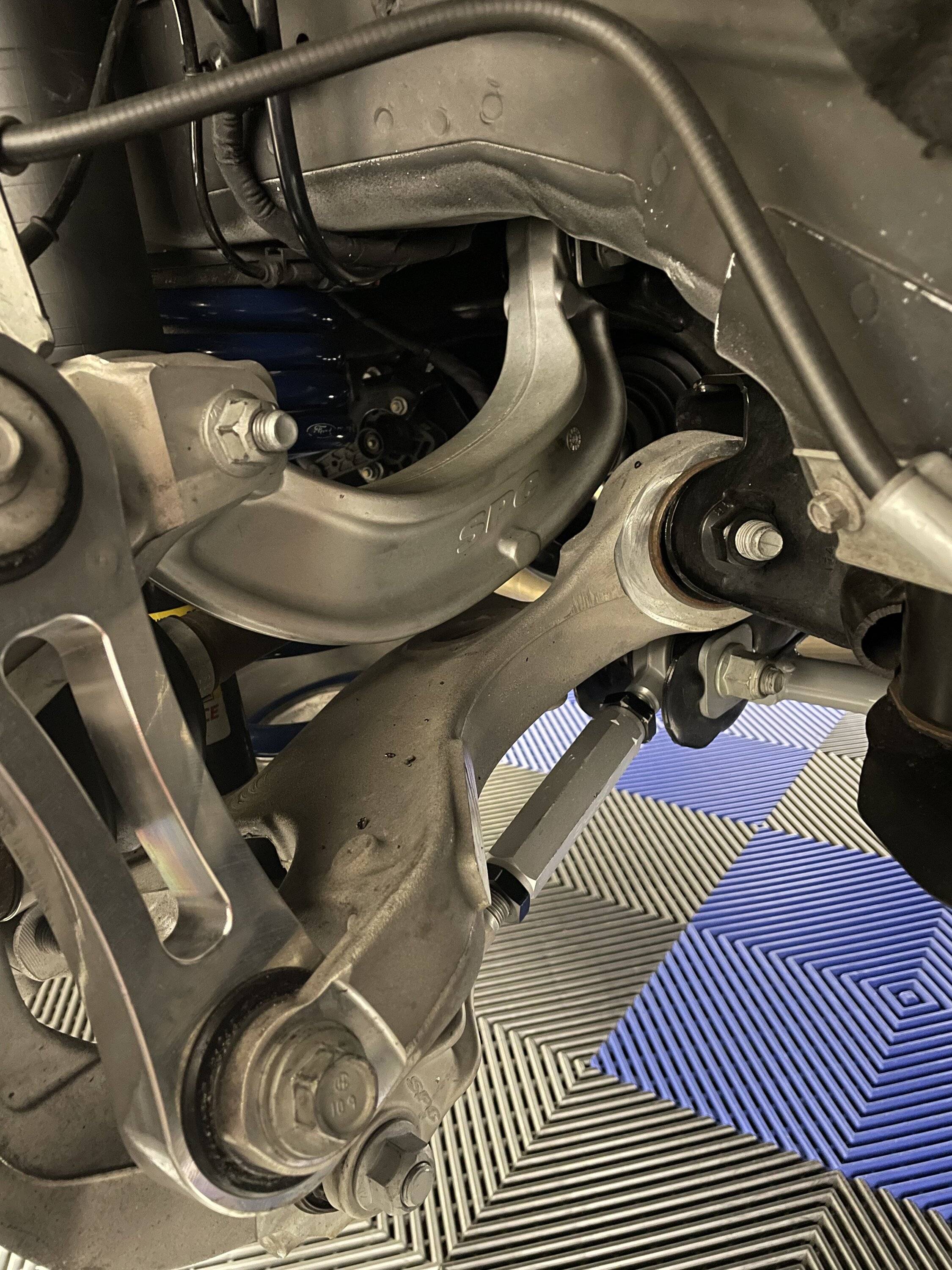

Have you tried adjusting camber (or pay some poor soul to do it) ?
They're absolute pain in the ass to get to the eccentric adjustment bolt at the outboard mount (of the camber arm) and you need thin 1/2 inch wrench to do it - that regular shop (and even good ones) generally do not have. SPC mentions it in the instructions (and sells the wrench - I got much cheaper one though) so I was prepared...

I personally don’t know how much better life could be with something else. Install was a breeze, easily make adjustments to both with weight-on-wheel, ZERO change in NVH, etc, etc. Some of the other brands may look fancier, but from all the components I reviewed before purchase, I don’t understand a better design.
Seems these hardly get discussed around these parts, but I think this is a very underestimated and overlooked brand/option.
Again - have you actually done it ? (Camber specifically). It's easily the most difficult to access adjustment from all the options including stock camber arm (which has none, slides in the slot but it's easier than reaching that eccentric bolt).
Don't know why would anyone call it "easily". EVery since camber arm on the market, with no exceptions is easier to adjust than SPC.

Yeah, I have done it. Just finished it actually. Must say I disagree. I didn't look too much into other camber arm options, but for the price point and all other factors, this seemed like the way to go. Especially with both arms in a package deal. Are some others easier? Probably yes, after looking at pics. Was this difficult? No. Yes, I did get the little wrench from SPC, which I would consider a necessity. But beyond that...IDK.
