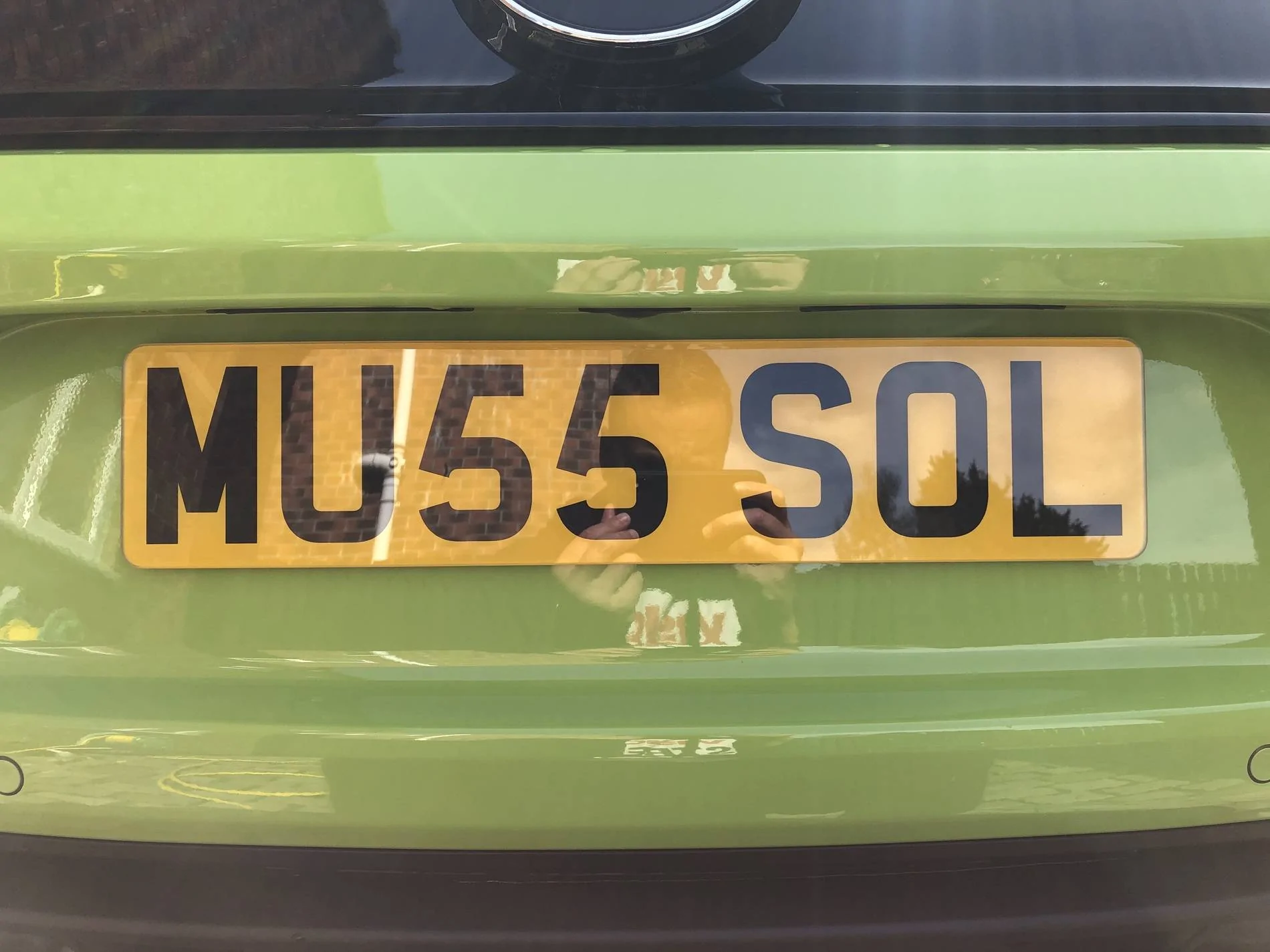

I know our UK plates are plastic and yours are metal, but number plate tape is common over here and if used properly it sticks really well (nine years and counting on my daily). Think of it a a thick VHB, I used 5mm stuff on the mustang so the plate is raised slightly to cover the bosses :

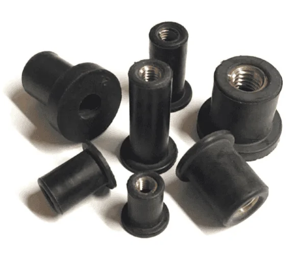

@RasJeremy - I like the stud idea mentioned above, but you could also consider those rubber rivet type things :
Once you have put the right size hole in the bumper you can replace the inserts as and when required - yearly with you plate removal if you really wanted ...

Thanks for this info. Your SOL plate is pretty cool also, I seriously doubt the
State of New Mexico in the USA would ever allow a plate like that. I've been
down a similar road with them already.

Number plate tape or rubber rivet
WD :like:
The tape part is not legal in Denmark - they have to be glued with window sealant, pop rivet or screw attached.
I love the tape part idea for clean plates! However if I have to take them off at the end of every year I'm gonna hate the glue option!
The rubber rivet idea is pretty neat though! I had them for attaching some stuff on my Humvee and they are actually working out nice! Thanks for bringing that to my attention 👍
